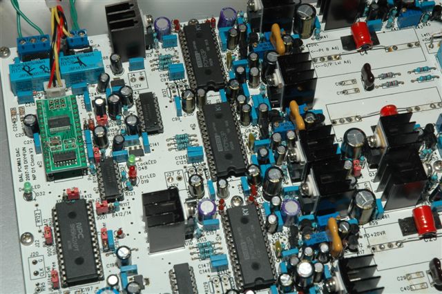

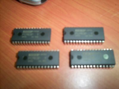

The pcm63p-Y's arrived yesterday, after being held up at the post office for nearly a week.
I should have a chance to audition tomorrow with any luck but I still need to tweak my VCXO install slightly before I change DAC chips so I have point of reference for the differences.

Hi IY,
That's the plan 😉 Unfortunately one of the Y's was dead on arrival and took out a resistor in the negative I/V power supply. A'af responded to email with in about 10 minutes (I was impressed) and is sending out a replacement.
At this stage the D1V3 is running with 3 Y's and a PCM63K (not PCM63P-K!!). The other major mod I've made is to implement the secondary PLL re-clocking circuit used in the original D1 using a Tent Labs VCXO.
The improvements from re-clocking were quite substantial using the K chips, tightening up the bass and improving imaging. Installing the 3 Y has resulted in a very clear gain in richness and detail without compromising other qualities enhanced by re-clocking. Obviously a full complement of Y's will improve on the current situation.
I'd been a bit hesitant about the outlay for the 4 Y's but after hearing the level of refinement they bring to the DAC I'm not disappointed.

Hi Paul,
Good to know that it is going in such a positive direction for you. It should get better once all the 4 “Y” chips are being installed. I was trying once myself to listen with a mix ((one PCM63K (I had once the same; no “P”…) and one PCM63P-Y)) and there was no accurate stereo-image!!
You can easily experiment the above by simply having one channel working with 2x “K”, the other with 2x “Y”: I think that this will show the major differences between both Chips; might be interesting to do. I would say that it is quite strong and surprising sound effect, but not very appealing for the “long run”.
Sorry to hear about the dead “Y” but indeed, Juang (AA’F) is so reliable that there is should be no reason to wary.
Something that really stunned me about the “Y”, just as you yourself wrote - “…without compromising other qualities enhanced by re-clocking” , I felt much the same – there have been no any compromising that I was able to figure out by listening to my DAC once the Y are in.
I am truly happy to hear about the different measurement that you are taking & the all improvements, includes the using of the Tent. May be you could drop a line to Spencer about it once you are done.

Hi Spencer, IY,
I'm running a balanced system - D1V3 -> P1.7 -> Aleph 30 mono blocs so I'll leave as is. I think I should have the replacement early next week.
The PLL is pretty much as per the D1 service manual with some very minor changes. I'm using a 11.2896mhz vcxo vs the original 22.5xxmhz, so this requires use of the q8 (/256) output of the 4020 to give the 44.1khz to feed to the comparator (4046). D1 used q9 (/512) due to the x2 vcxo clock freq.
The PLL LPF values don't need to be changed. The PLL bias voltage via 2.2M works without problem with the tent VCXO but probably needs to be tweaked to get best performance.
The idea of the bias is to ensure that the 4046's comparator is always operating outside it's dead band to ensure lower jitter performance of the 4046. One of the few documents I found that mentioned this was a pdf titled chapter 10 "oscillators and synthesisers" (from the ARRL handbook??) which said (at length):
I'm powering the clock circuit from 8.3V digital supply, with 2 x 7805's on the clock board. This is non-ideal and it would work with 3 x 7805's - 1 for clock, 1 for PLL bias and 1 for logic chips.
Clock is picked up from FSYNC on the CS8412 and reclocked signal is wired to CLK pad on the edge of the board, with a couple of component positions jumper to send the signal back to the 8412/XO jumper. So it's exactly idea, but the clock looks cleaner than what's coming from the cs8412.
I've tested a couple of combinations of jumper settings: with the Y's installed the D1 settings of Jitter = Free, Dither = On seem to work very well with reclocking.

Attached dac chips from A'af but sorry for the blur image.
Hope I will confirm your conclusion about the quality of this dac chip soon, so there are 5 can confirm that matter. I got the chip last week but never get the enough time to solder them to Spencer's kit. I will come to contribute to this thread soon.
