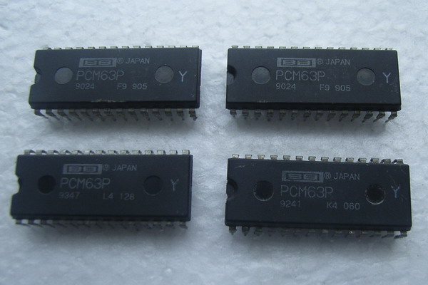

For the records: There have been indeed genuine BB PCM63P-Y Chips, and some of them can be found in Yamaha ProAudio gears. Also to be found in a Yamaha ProAudio gears is a different BB PCM63P chip, with the extension “KY”. It is a similar sounding chip, though not exactly the same.
According to BB, all PCM63 productions must have been discontinued latest around 2002. BTW, I personally didn't find any genuine "Y" chip dated later then let's say 1993.
The “Y” chips which are dated later then 2002 might have been produced under licence or have been somehow faked (we didn’t figure this out; see the other thread).
Here is a picture of a genuine BB PCM63P-Y chip, for the records of this thread.
IJ.
