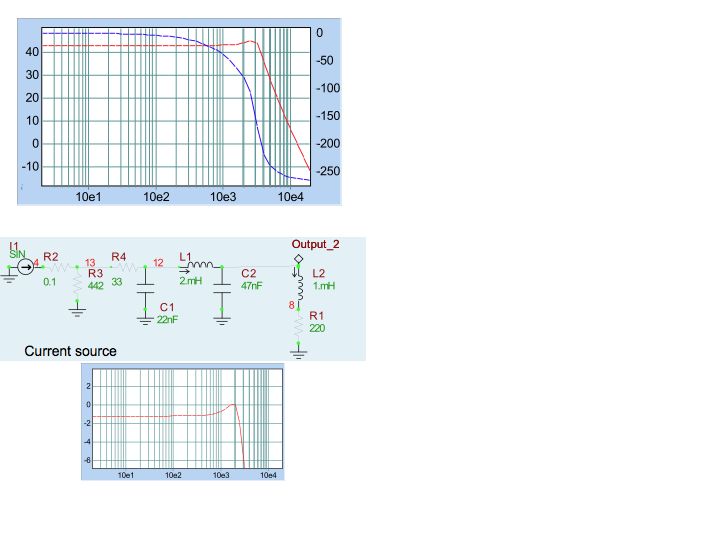

Analog filter for a single PCM56 per channel, 200 ohm I/V:
Or for a 750 ohm I/V:
put 10nF ll to R_I/V.
No series resistor.
Bernard, starting from your schema and looking at what I have available, I changed it around a bit. I have 1 mH and 2 mH chokes.
Subsequently I loaded the schema I created in Broskies' tool and this showed me I had a nice approximation as well. Not as well thought out as yours of course.
Here is my schema:
R_I/Va 422 ohm
R_I/Vb 220 ohm
R1 33 ohm dale
C1 22 nF
C2 47 nF
L1 2 mH
L2 1 mH
In the simulation it gives a slight rise at 20 kHz of 2 db and then an abrupt fall of > 18 db/octave.
As output I use an SRPP from the ECC88 family, running on a modest 80 volt, with a bandwidth of over 5-300 kHz. This amplifies 12x.
The sound: rich in harmonics, the slightest moan or sighting of a player and dubbed sounds can be heard clearly.
It is a musicality I like. It is a promising venue, for sure. Next I'll experiment with the clock.
