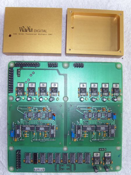

1 The whole board has to come out and the cover screws removed from the other side.

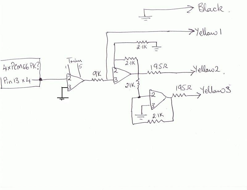

2 The dacs themselves are single ended not balanced output they (Wadia) make a pseudo balanced output after the dac, not real balanced as the dac is not. (see sketch attached this is what's under the covers minus a couple of caps here and there) .
3 The Zap will give balanced or single ended output even when only fed by the PCM56p single ended output. again it's pseudo
Cheers George

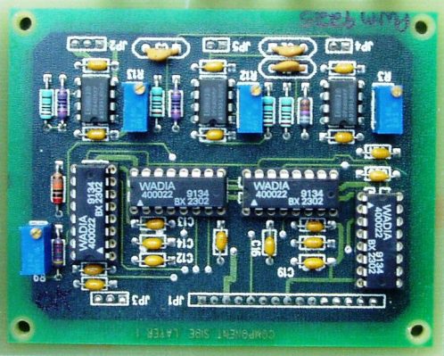

I took the top off the dacs. Mine is a slightly different configuration than george having two extra trims.
The dacs themselves are Wadia part # 400022.
The resolution on the pic george posted above is not high enough for me to determine what they say.........
Do they also say "Wadia" on them. How were you able to figure out they were the PCM56K?
opamps on mine are OPA606KP.
Thanks.

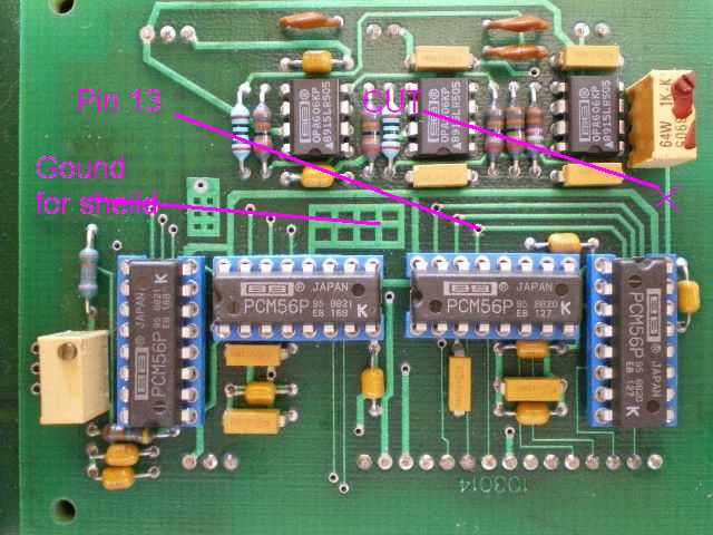

Same same, the earier ones had PCM56P K , Wadia started to put their own name on the later ones, and they could even be PCM61P K as they did use them later, 18bit vs 20bit identical in every other way.
As for the opa606 you don't use these if you are wiring in a Zap, cut the track shown (to get rid of the OPA606's) and take the signal from pin 13 shown (which is all 4 dacs) use a good quality thin shielded mic cable take the earth from the point shown and then the signal goes to the + input of the zap via a 100ohm resistor and the shield to ground on the input of the zap, and Bobs your uncle.

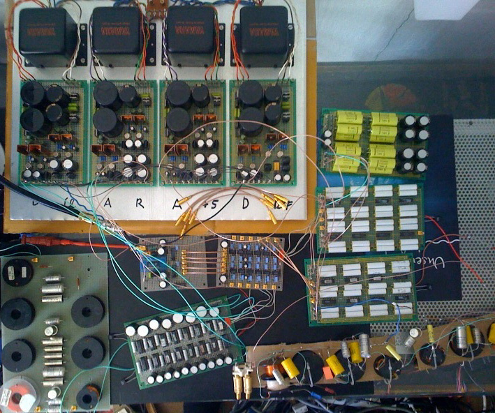

Thats very interesting.
Have you posted more information about this somewhere? I am very curious.
Are the 8 dacs per phase summed for the purpose of increasing the current output?
Bernhard said:increasing current = decreasing impedance
Which chip are you using?
Any pictures?
Thanks.
I knew somebody would ask...
Here is a picture taken with my phone , not finished yet, 3 pcbs have to be replaced and one with yellow & black caps has to be added, plus interconnects & box for the PSU & box for the DAC, next winter...
It is playing though.
I have posted a picture of the TVC which is part of the DAC elsewhwere.
DACs are PCM56.
DACs are PCM56.
champ04 said:Mine wont be quite as straight forward.
The trace going to the opamps must be on the underneath side of the board now. And the pin 13 trace may be a little more difficult to find. But I dont think these things will be a deal breaker.
Thanks again!
Lift or snip the leg on pin 2 of the first of the OPA606 coming from any of the dacs pin 13, that'll get them out of the circuit. I would say it's the one on the right of your pic .
Cheers George
