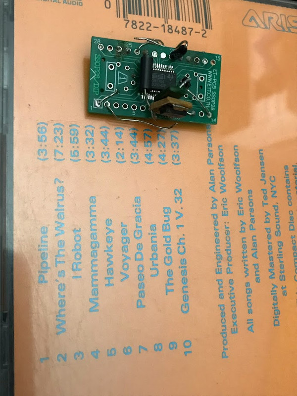

What I need is fast solution to getting acceptable sound from the output of a PCM1794. Something one just plugs RCAs into and get okay sound (or at least a hint of what is possible with the PCM1794)
Will the test rig described above suffice?
Or does one need more stuff added?
I would just follow the data sheet and figure 24, pretty simple.

It really is pretty simple, don't let it scare you. Can you work with the surface mount PCM-1794?
Do you just want to breadboard this for a quick try out, or keep it for a longer time?
Remember you do need the output filter (in the second op amp stage) to get rid of the digital "noise".

The photo shows as far as I got 12 years ago.It really is pretty simple, don't let it scare you. Can you work with the surface mount PCM-1794?
I saw Fig. 24, and thought ... "way too much work".
Maybe "Hawkeye". So, no "Voyager" and the La Grada Famila is still un-completed to date.
How about the smms73 circuit in the top post? If the simple smms73 circuit works, even a little, I may even (ultimately) tube it.
