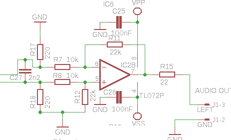

I don't know what signal is acceptable FOR YOU.As few parts as possible in "?" to make the 1794's output an acceptable signal and free of DC offset.
You know that 1794's output current is 7.8mAp-p. so use Ohm's law to calculate passive I/V resistor.
DC block capacitor - put 1-10uF.
RC filter - F=1/(6.28*C*R), let say 5.2k and 1nF.
Why would anyone suggest njm358 when a ne5532 can be had for pennies more.
Just because njm358 starts from $0.15, and ne5532 - from $0.55 (Digikey, 1pc.) - the goal was to get "simple and cheap" 😏
