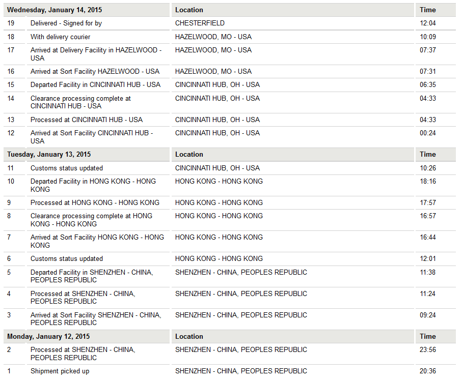

It looks like they might not be the most organized bunch there. I received my latest order yesterday, then someone else's order arrived today addressed to me. I would have liked it better if it was at least boards for something cool but it's just some crappy serial connector boards.
I let DHL take care of all the taxes and duties. The broker I'm normally stuck dealing with is a crook. DHL is a quarter the cost.
There was never any mention of fees for customs, duties, taxes, etc on my recent order shipped to a U.S. residential address. There are several entries in the tracking log (see atch) that indicate customs officials were notified of the package's movement, but as far as I can tell the package itself was never actually opened for formal inspection.
This may be related to the relatively small value of the goods. The packing list included a copy of the customs declaration. It was straightforward and accurate - five PWB's valued at US$7.00 each, plus $4.00 money transfer fee. This is different from some other small orders I've placed with overseas vendors, where the items were declared as "commercial samples" valued at "$0.00" when in fact I had paid for the goods.
I received a (automated) phone call the day before delivery, advising that a parcel would be delivered on the following day, and a signature would be required. Following instructions given in the call, I left a note on the door identifying myself, the freight carrier (DHL), the package tracking number, signature, and date. The note disappeared and the package was left on the porch sometime before 1:30 PM on Jan 14.
