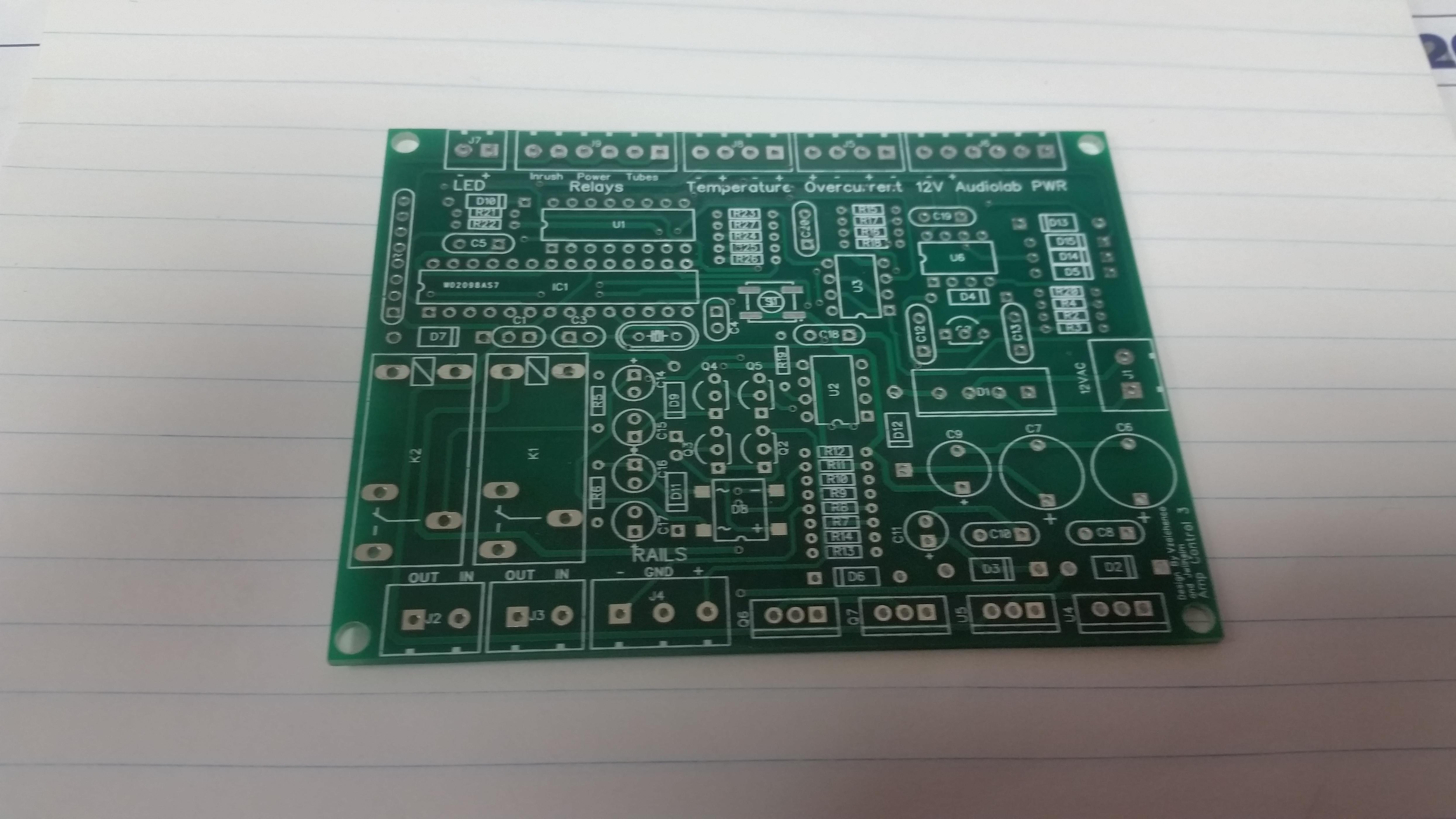

I've never had an issue yet with multiple drill hole sizes from them. I doubt they actually drill the holes to finish size. They more likely machine them to finish diameter with an end mill to save bit changes.
Just noticed your comment on them adding a number. I presume this is just a code and nothing that clearly states "these boards are made by PCBway" or "produced by lab xyz"? I would like the boards to stay as mark-free and anonymous as possible.
It's just a small 10(?) digit number in an inconspicuous spot. You actually need to look for it, it's usually hidden by a large component on assembly.
The number is under IC1. Left side , up 2/3 of the board.
