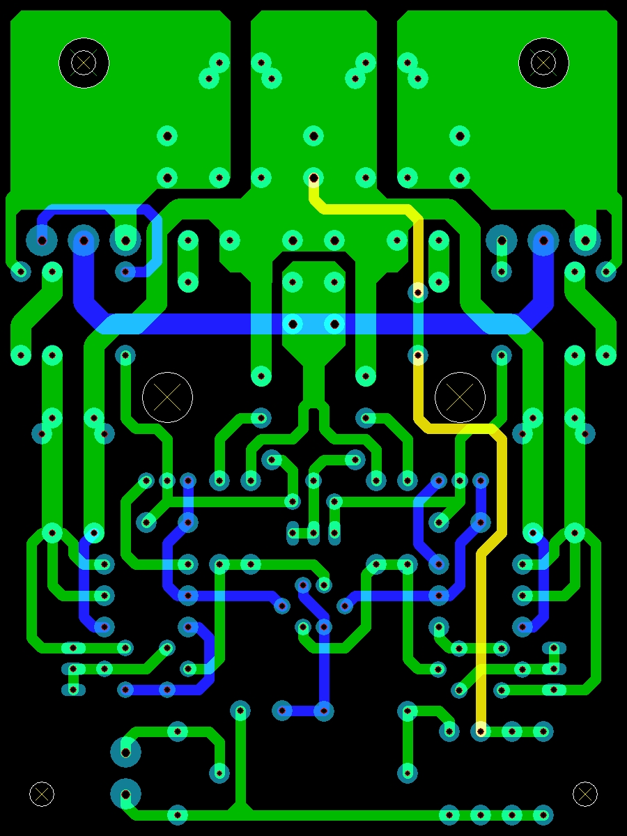

I have highlighted the proposed ground run in yellow. It has to briefly change sides in order to be reasonably direct without a total rip-up and redo. Is something like this OK? The trace is just shy of 3.5" long.

Looks ideal. I always split my schema/PCB into "G1/G2" ... each is a separate
star. G1 is "dirty" (PS/OP decoupling,zoble,speaker return) , G2 is clean ....
(regulators,zener ground ref./"lifted" input ground). They either connect with
a wire or long trace from the center points of each star.
OS

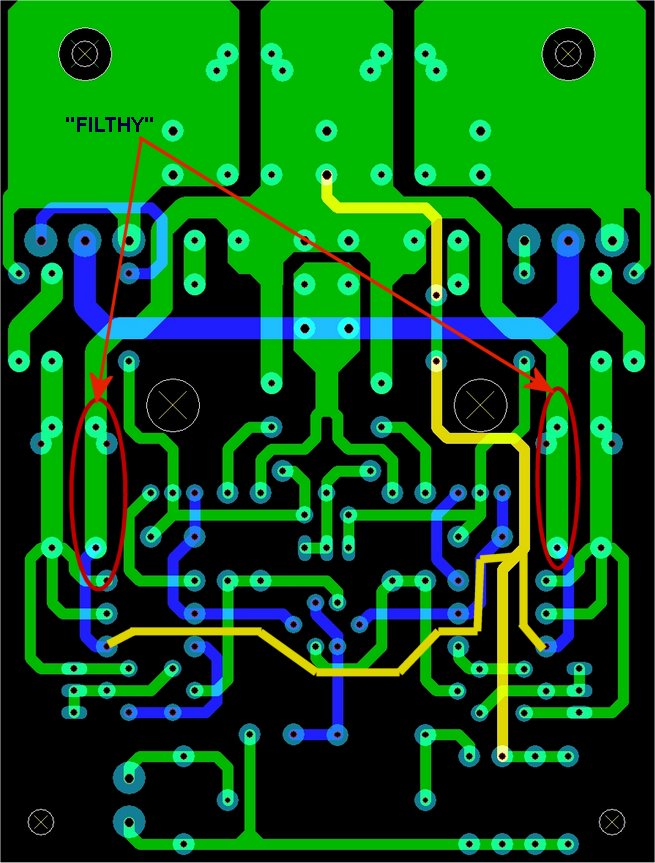

I looked again , and a more ideal way is below.
It's up to you how far to refine it.
Even more ideal (like flatpack leach , moon audio , HK990 , or AAK's symasym)
is the second attachment (2 grounds are circled. 🙂

I'll take another look at further optimization of the grounds. I do have a preference for one ground connection to the PCB from the PSU if possible.
One thought about the CCSs is to link them to each other rather than ground. Seems to work well in simulation, any thought about it in a real implementation?
the G1/2 scheme has just one end connection to ground. "Poke around" for
"star within a star" grounding. How it works .... center point of your main star
has equal R/L from each main cap or output (cancels out) .. to pull a trace off
there (as you have done) assures that any smaller star will have these same attributes.

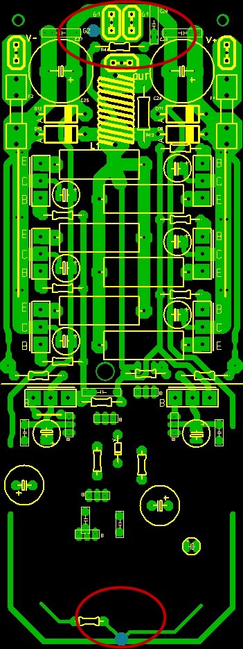

I see this almost universally on low to high end amps. They usually go further and physically separate the PS/OPS from the IPS .
They even take the IPS rails direct from the main PS caps (not the OPS traces) , as well.
An example below..... (they run black wires to the zoble and G2 under board.)
Amp is dead silent.
Sims on both of my CFA's show minimal difference between rail and ground referenced CCS's (< 1DB PSRR).

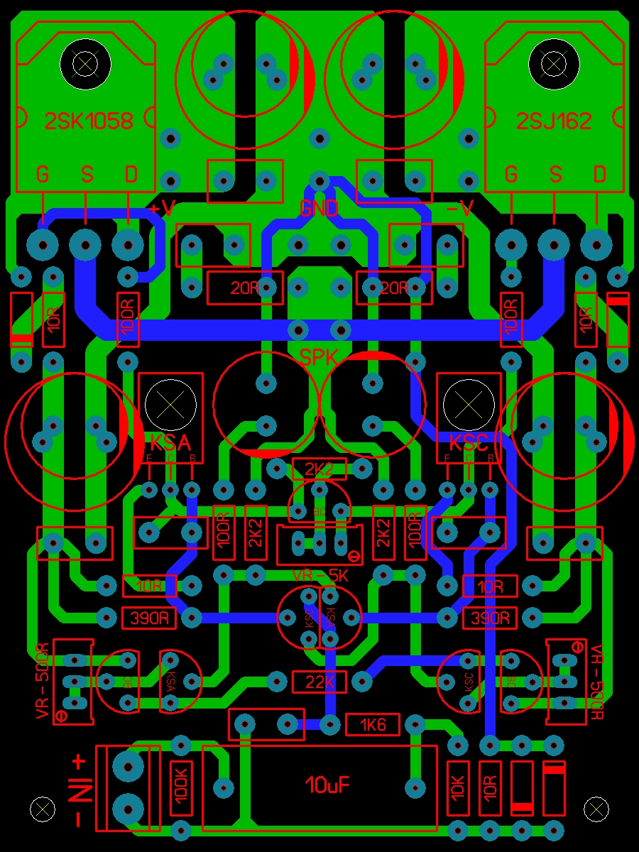

OK, is this a better approach than the last update? Or should I create a trace to go away from the ground fast-on a short way and create a new star there?
As I see it there is a star on the bottom (the 'dirty' one) and a star on the top (the 'clean' one) connected by the fast-on itself.
As I understand grounding thus far anything that potentially carries high and / or irregular currents needs to return to the 'dirty' ground. This would be any onboard reservoir capacitors, decoupling capacitors, Zobel networks and the speaker return. The 'clean' ground simply becomes a reference for things like the input stage and feedback network.

YES !
This is even more crucial for CFA , with that 100mA FB return. The same as
you took the current FB from your OPS center point , return it to a "center point" (ground).
On a smaller PCB , the lines gets blurred as far as "G1-G2" (everything is close).
Sansui (and my PCB) are big ! Too many "black wires" for each individual
ground return.
Layout is an art - study the "art" (OEM's) 😀
OS
