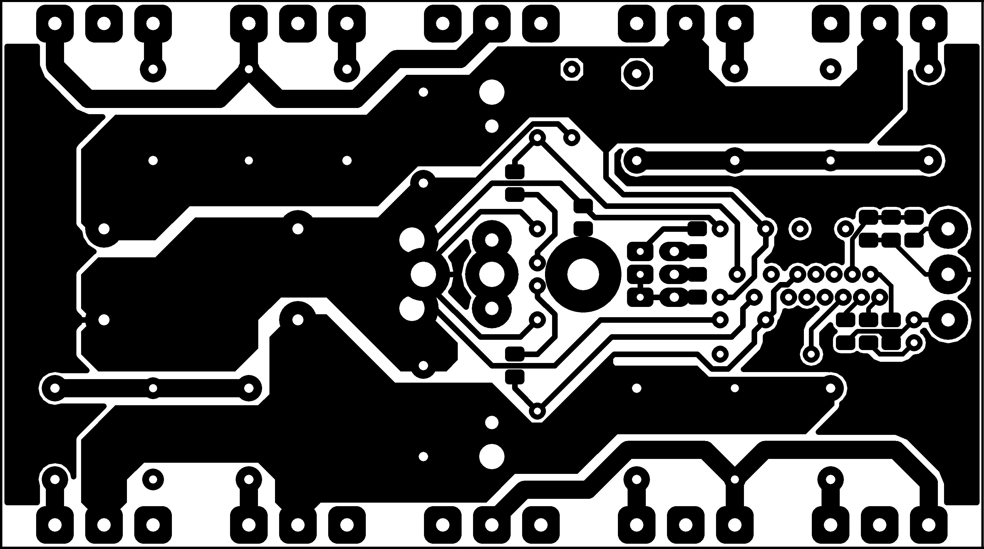

this "bloody" design (drawn with Microsoft Paint, disregarding any theoretical advice - representing Carlos' DX Blame ES) took me 50 hours.
http://www.abload.de/img/kk001ejal.jpg
The result has been a "rock-stable" AMP, "playing to pour its heart out to you."
http://www.abload.de/img/shootout0179khh.jpg
and has been unmatched for quite a long time (in my ears, according to several listening tests with my AUDIO-friends, "shoot-outs with famous brands", ...).
Theory is on the one side - real life may differ from it.
Remember: we do not have any GHz-signal acting like an antenna on an AMP's PCB, we do not have any µV - signal, being crossed / paralled by a Kilo-Volt-signal, ...
This is my experience.
Best regards - Rudi_Ratlos

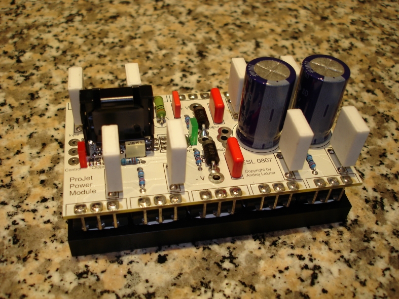

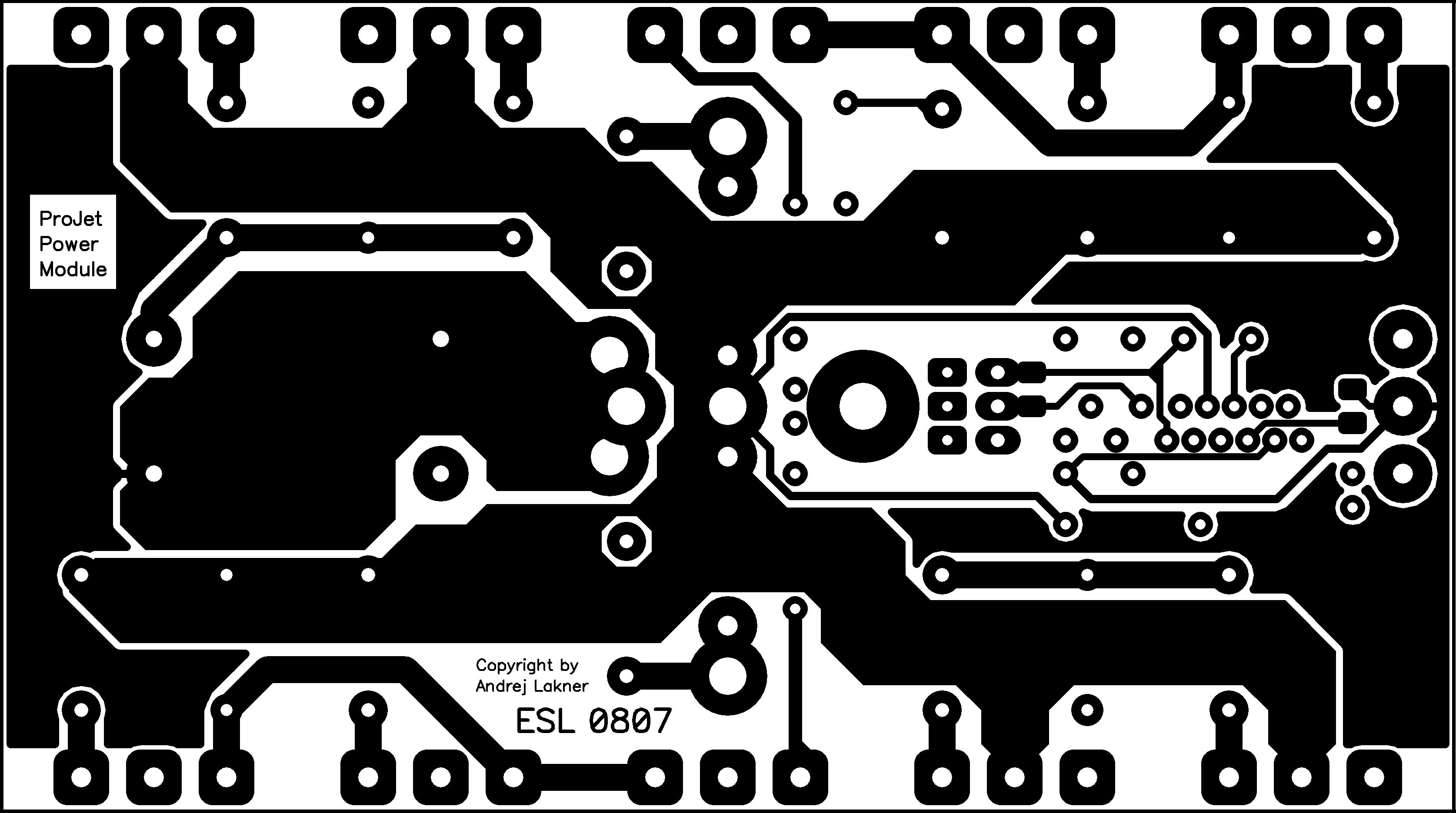

Here's my the most power-size-concentrated module I've ever made, ProJet Power Module mono PCB from few years ago. It was more a tour de force than possibly commercial success but nevertheless I made it and it works properly according to specifications. Ten output devices (two are drivers) on such small area is quite an achievement as to some pro's opinions. Tracks are short, well routed and the board has some 70um base + cca. 200um extra copper thickness, double layer with metallized holes, all in white colour. 🙄

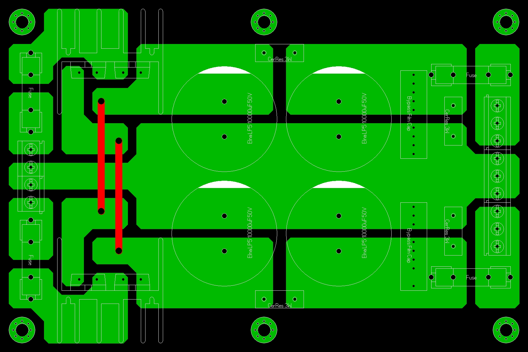

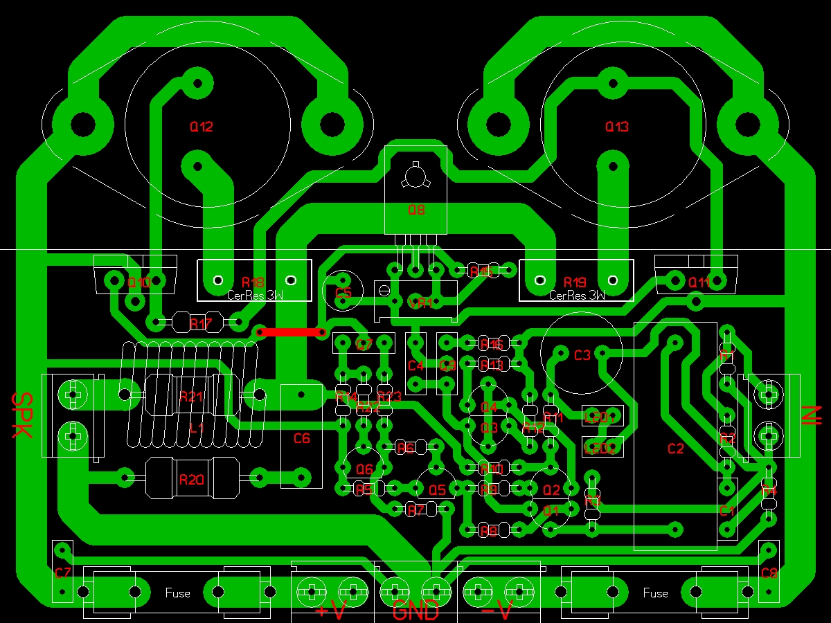

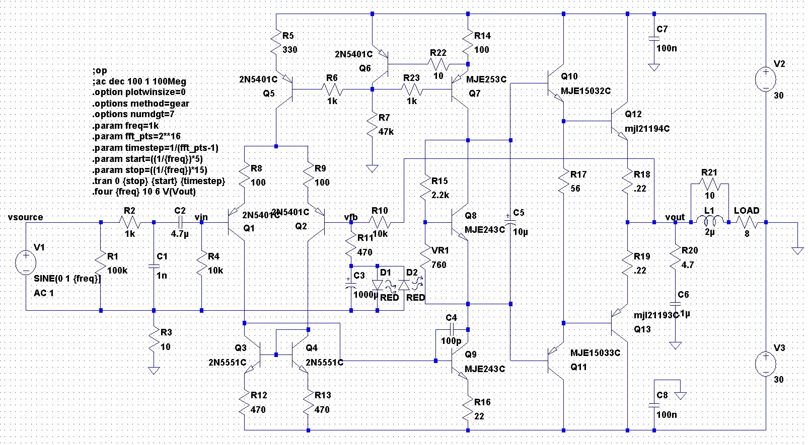

First off, sorry about reviving an old thread of mine but since the content is relevant I figured better to continue with this one than start anew.
I'd like some peer review related to the PCB layouts more so than the schematic. I'm looking for gross layout problems or outright errors that I may not have seen. I am also interested in the finer points as well. Any constructive comments or criticism welcome.
