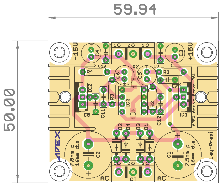

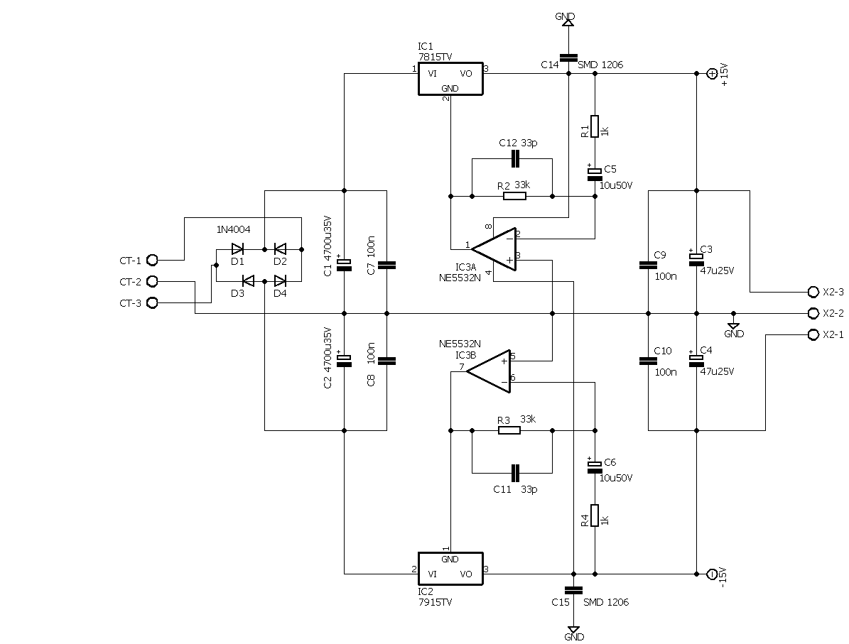

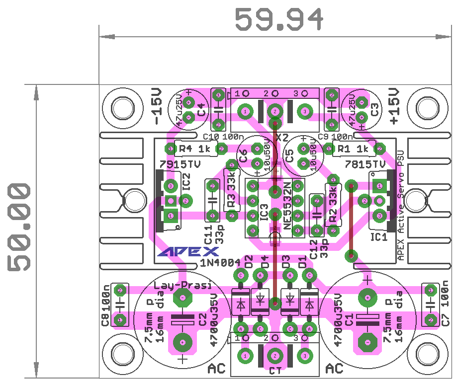

pretty old thread , but how abt this for a layout? I generally try to keep all traces as short as possible and thicker whenever required.
This layout already posted in APEX 100w ultimate amp thread, but re-posting here for convenience. Its an APEX design , servo pre-amp PSU.
any critic is welcome.
remember its a single side layout, I tried to optimize as much as possible.
JKT, some of your designs helped me learn.
regards
Prasi
