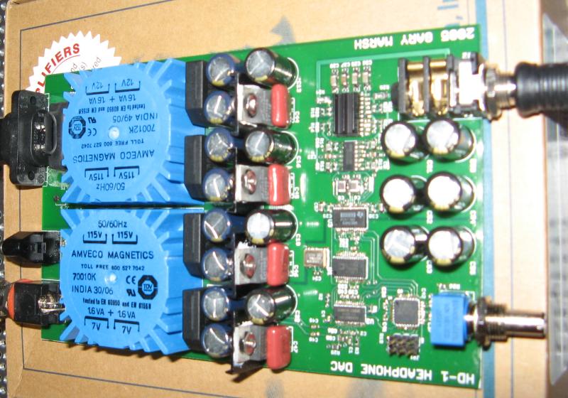

I completed the assembly of my Headphone DAC. Check the picture. I had a few problems to get the processor programmed correctly. Here my own, more detailled, programmation check list. Follow these steps and it will work like a charm:
(i) Don't connect the AVRISP mkII module to the USB Port
(ii) Install the AVR Studio 4 and upgrade and the USB driver for the AVRISP mkII module
(iii) Plug the AVRISP mkII module (green led on module turns on)
(1) Start AVR Studio and Press the AVR Chip Icon (in Black), select AVRISP mkII programmer and ATMega8 as the device type.
(2) Under the Advanced tab in the Signature Bytes, press the "Read" button to read the device signature
(3) Under the Fuses tab, make sure the fuses are programmed as follows and hit Program:
[ ] Reset Disabled
[ ] Watchdog timer Always On
[X] SPI downloading enabled (if it's grayed out, ignore)
[ ] Preserve EEPROM
[X] Boot flash size = 128
[ ] Boot Reset Vector Enabled
[ ] CKOPT fuse
[X] Brown out at 2.7V enabled
[X] Brown out detection enabled
[X] Int RC Osc 4MHz, 6CK + 4ms
(4) Under the Board tab in the Voltages area, press "Read Voltage", now VTarget should read 3.3V
Under the Board tab in the Osc & ISP Clock area, in the ISP Freq section select 1Mhz (1/4 of the target clock (the ATMEGA8 is running at 4Mhz), press the "Write" button.
(5) Under the Program tab in the Flash area, point that at your .hex file and hit Program.
First listening impressions are very good. I compared it to my present test setup: ML37 Transport, Guido Tent Super Tube Dac and PSAudio GCHA Headphone Amplifier. It used the same ML37 to drive the Headphone DAC.
I must say that it I got maybe 80-90% of the sound of my much more expensive test setup. There is a slight more trace of sibilance, bass are not as much powerful and space is less airy, but all in all it is an excellent DAC and a very nice headphone Amp. Very impressive. Thanks GMarsh for sharing your very nice design.

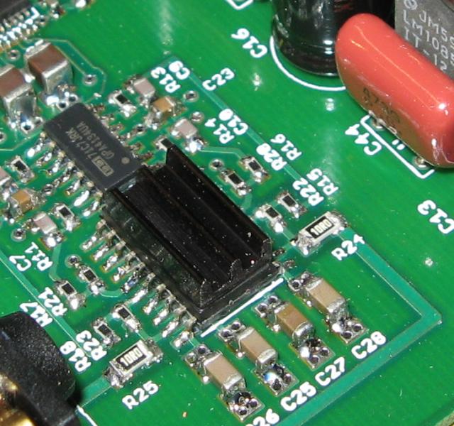

The only detail that trouble me is the heat management of this PCB. The 3.3V regulator is too hot to touch (temp > 55C). The headphone amp IC is also very hot. I added a heatsink to it. I glued it in place using epoxy glue. Not a perfect heat transfer but better than nothing. By the way soldering all these very small leads was not a ride in the park 🙄 Before powering the board I checked all the circuit using an ohmeter. I had only one IC pin that was not making contact. Not bad for a soldering job done at 10PM 😉

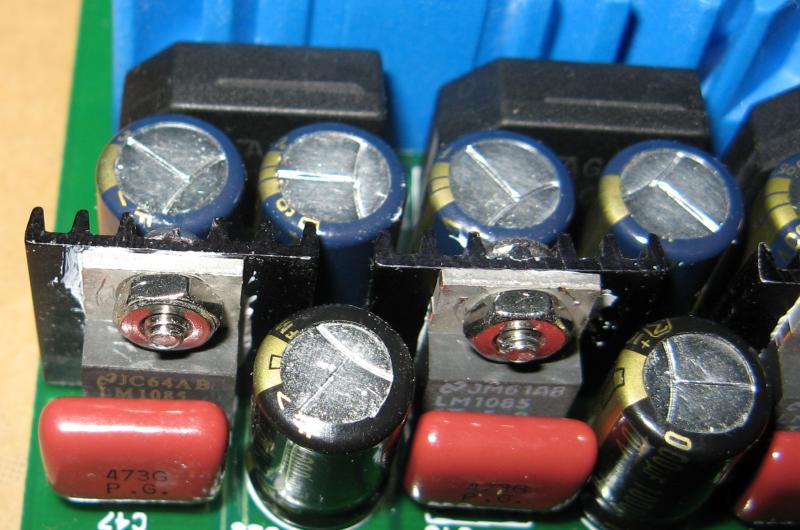

Algar_emi said:
I added small heatsinks to the four voltage regulators. The 3.3V was too hot for my taste. If it is not enough I will arrange for this regulator to use the casing as heatsink. I will also use a case with some ventilation and a Power-On switch.
Algar,
I did not have an overheating issue with the 3.3V regulator on any of my three builds. You may want to re-check the 3.3V output first, then all the component values and soldering associated with the regulator.
The headamp IC was hot, but not uncomfortably hot. Did you solder the power pad to the PCB? It takes a lot of heat to do that....I was affraid I was going to burn it up, but it worked fine.
Have you tried your line output circuit yet?
Robert
Yes, I tried it and it sound very good. No I didn't solder the headphone IC bottom power pad to the PCB, I though they were only suppose to touch. I'll solder it tonight.
When I assembled the PCB, I did first all the smd parts and checked all connections. I had no solder bridge and only one pin was not making contact. Then after I was sure that all the circuit was correct, I installed the regulators and the rest of the discrete parts. Then I power the PCB and checked the supplies. All the supplies voltages were Ok. I programmed the processor and the headphone DAC worked perfectly, except for the heat issue. I know now why the heaphone Amp IC was hot, I'll correct that.

Here's some clarification on hot parts:
With the LM1085, Tj(max) is 125C and Rjc is 3degC/watt. Case to ambient for a TO-220 is about 60 degrees/watt - high enough to assume that the case temperature is almost equal to junction temperature. So even if the case is at 120C, which is "you'll burn your finger and hear a sizzle when it happens" territory, the LM1085 is still operating within spec.
The TPA is well heatsinked but still well within spec.
Silicon can handle much higher temperatures than your finger, so using your finger as a temperature gauge is being *very* conservative. 😀 Unless you do something like mount the amplifier in a plastic case, don't worry about part temperatures.

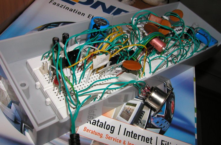

The player is only at testboard (SD connector is at the moment not shown in picture). SD card is read with ATmega88 at 3,3V and ~12MHz XTAL. DAC is TDA1545. It is not a great DAC, but for test digital parts (reading PCM data from SD Card and generating digital signal like I2S for DAC) is OK. The SW is done in C with some routines in assembler language.
I thing that better solution is to use for example ARM7TDMI with DMA (or incoming AVR32 with USB) at ~45MHz clock. There are next possibilities of decoding FLAC or APE files - you need only SW upgrade. (BTW I have heard that ARM7 is capable decoding of MP3 too). ARM7 have DMA access and there is (theoretically) no problem of generating signal data for DAC - I don't need I2S supported by hardware because of DMA in ARM7.
Do anybody have interest for cooperate on this project? 🙂 I am not so good as qmarsh in PCB design, for example I can make SW for this project.
