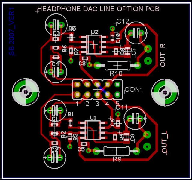

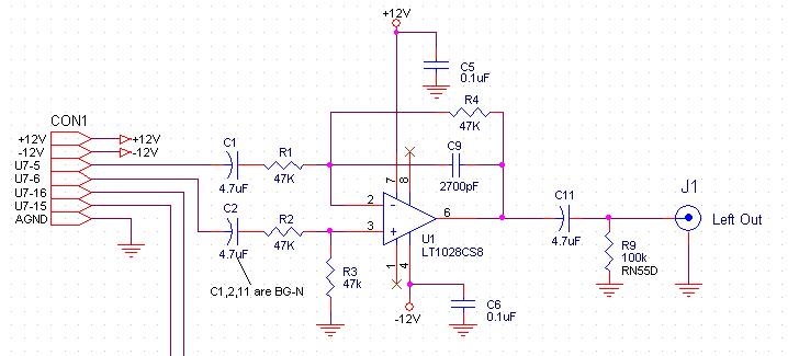

I completed the assembly of my Headphone-Dac and tested all the DC supplies and connections. Everything seem to be Ok so far. I'm waiting for the programmer to arrive and download the processor code.
I want to add if possible a line output option to this excellent dac design. I'm planning to take the audio signal from the Op-Amps U6, use BG-N coupling caps to remove the big DC offset present there, and use a good quality differential Op-Amp to get a single-ended output.
I'm may need to paly with the resistors values to get the correct signal output amplitude.
Here the prototype schematic, just one channel illustrated.
Algar,
That looks interesting....please let us know how it works out.
