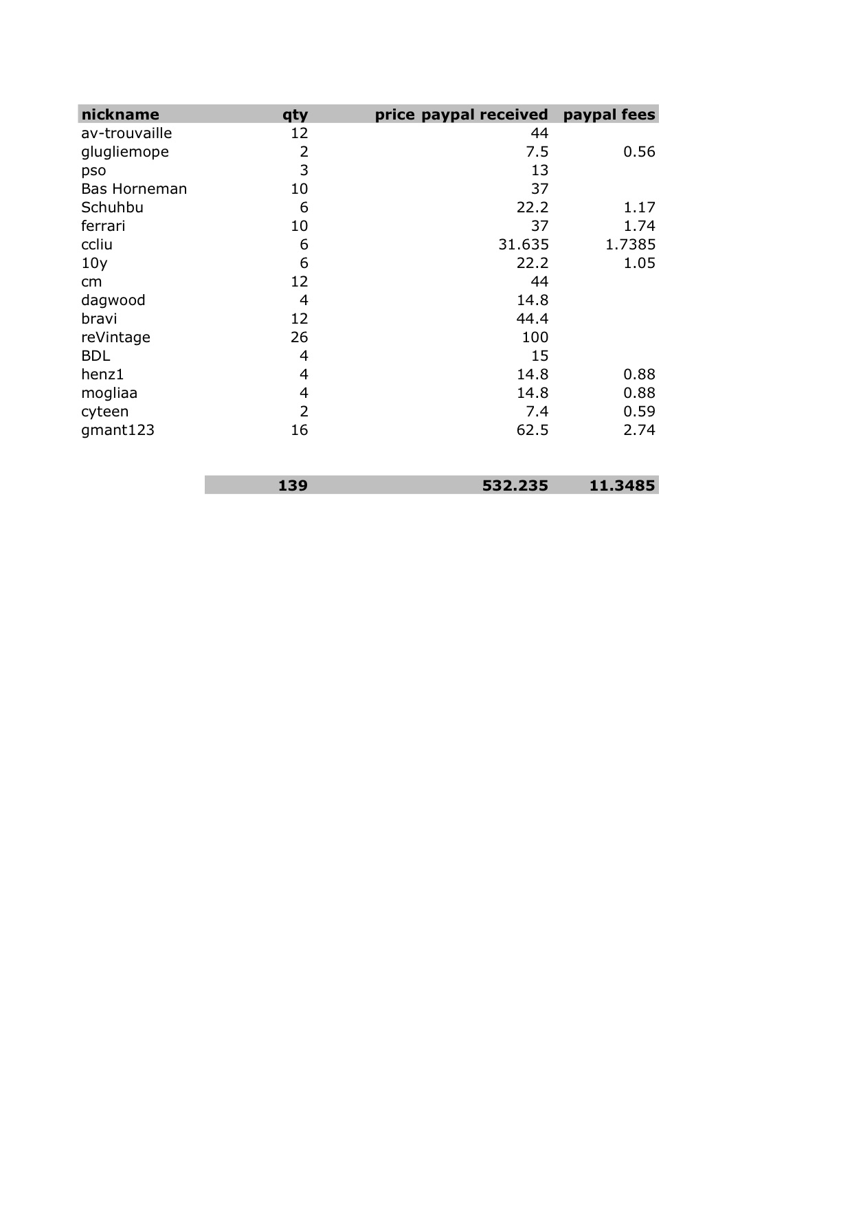

gGot the last payments and I will update the count tonight. Polin ... I did not get yours, please check.
Payment sent for 6 boards. Sorry for the delay, was out of the country for the past week.
Thanks a bunch.
Siang
Thanks a bunch.
Siang
Guys
orders confirmed for 201 boards. I know somebody else is going to paypal me very shortly so I'll order all the preorder boards in the next couple days after a final check of the design. I'll keep you posted in the next hours.

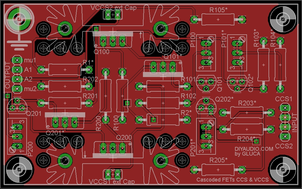

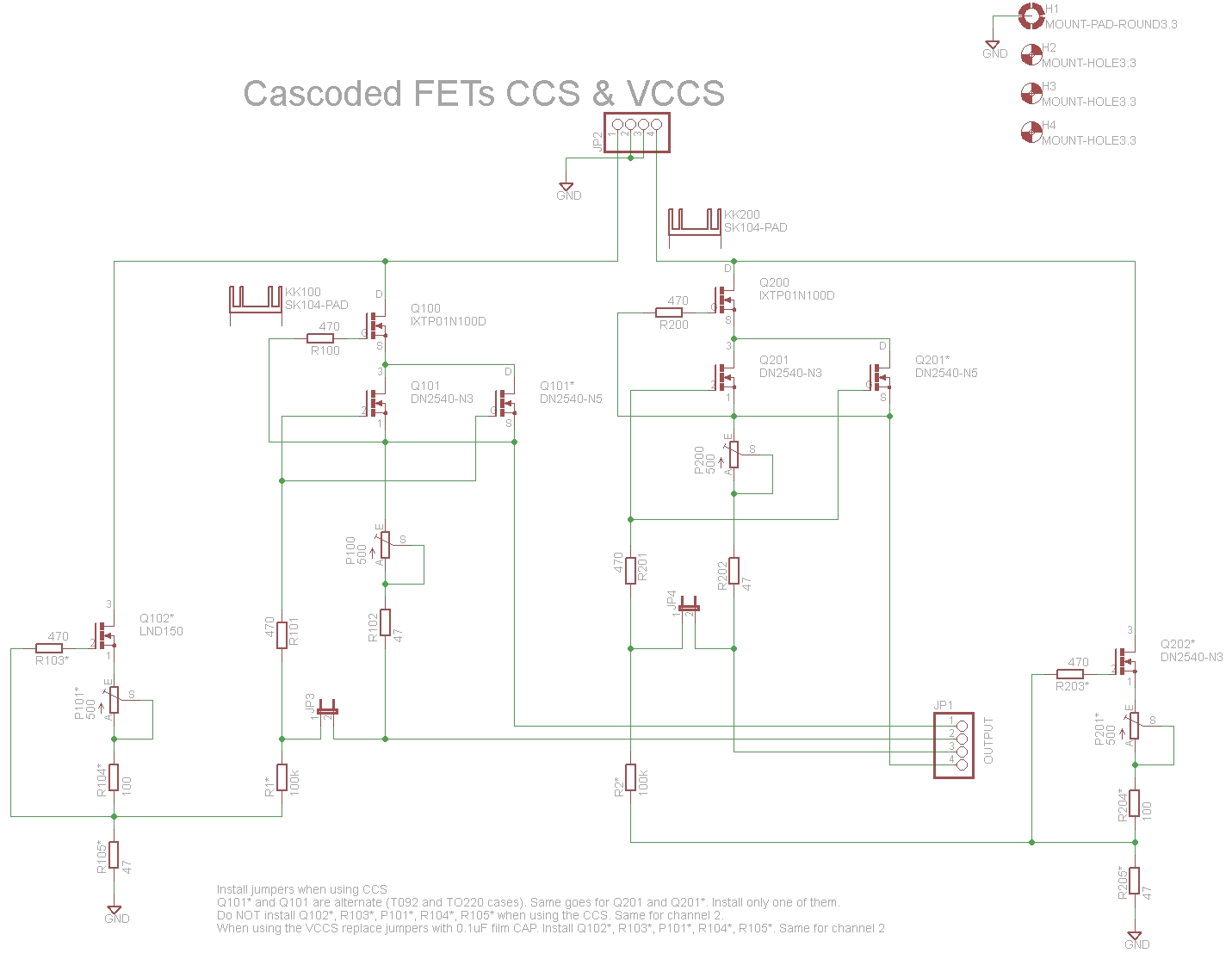

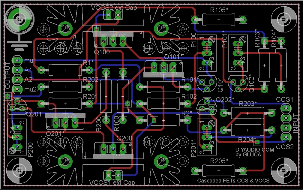

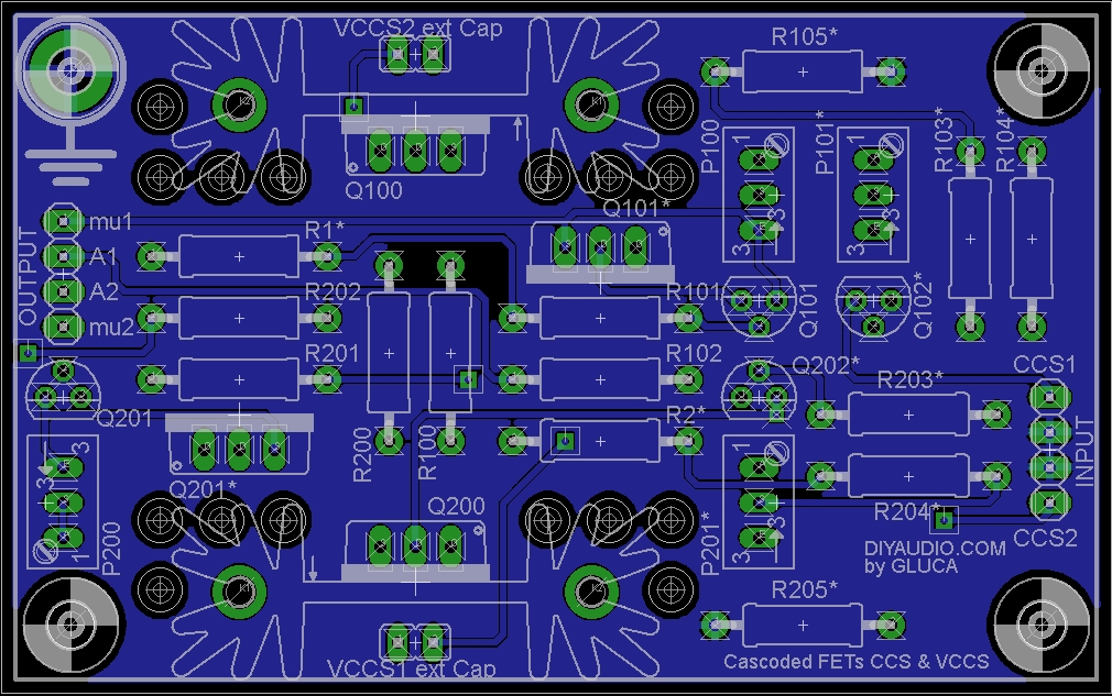

Looks good to me. Perhaps R100 AND R200 can be closer to the gate(G) pin?Comments?
hum ... I can easily swap them to make tracks to the gates shorter.
Trimmer is OK (it is a 2.54mm pitch). Terminal block NO ... you need a 2.54mm pitch device like this 651-1725672. Resitors are 3mmx9mm with 12.5mm spaced legs. Jumpers are 2.54mm pitch.
