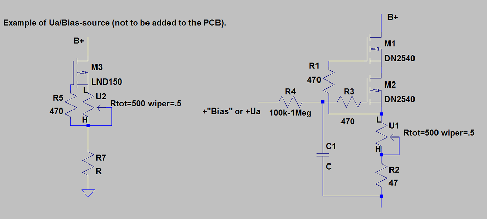

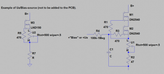

Hi guys,
Have corresponded with Gluca about a modication to the PCBs. He asked me to post this and is willing to modify the board as there is free space on it.
By making place for a plastic cap and a pair of resistors the card can be used as a "Gyrator". For those who haven´t heard of them itcan be looked upon as a voltage controlled AC-CCS. You can substitute an anode-choke with it if you just add higher B+.
If you run a pentode or cascode you can´t use a CCS on top as Ua will be all over the place. So in the this case you need to define and make Ua adjustable. To make the pentode/cascode work at its best you still have to add a suitable load to it. Works like a charm on Schade-amps.
If one could squeeze in the leftmost parts it would be great. The Supertex LND150 is a 1mA TO92.
Michael Koster is AFAIK behind this innovative way to use it. Below is a schematic.

Made a mistake in the schematic above. U1 should be removed/strapped and R2&C1 choosen to give the right "inductance".
