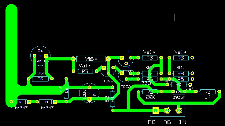

You can make ground plane using the following steps
1. Name the all similar traces (eg ground) with the same name (eg GND).
2. Select ripup option and give GND in the command line (of eagle). Press enter.
3. Select Polygon fill and give GND in the command line and press enter.
4. Draw a polygon whereever you need the Ground plate.
5. Click on Ratsnest.
6. Ground Plate will appear.
You can use the same technique for any signal (Vcc, Vee etc).
I have attached a layout of LM1875 which has ground as well as power platings.
Venki.😀

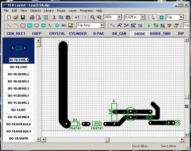

Quick review:
I like it. It's very simple to get to grips with. The parts library is good, but I want to redraw a lot of the footprints, simply because I don't like the look of them. I will probably do a couple every time I make a design, as it's quite straightforward.
Schematic entry is very simple, though there are a few things that take a little time to get used to, and a few things that need improving as well, but more on that later.
PCB design is quick and simple, though the manual trace layout tools are a little basic. Copper flood is the easiest implementation I have used.
But the best thing about this program is the support. It is a new program, still on V1, and there are a few issues, but every single thing I have brought up on their yahoo forum has been sorted very quickly, and a lot of issues I have raised have gone onto the to-do list for V2. Personally, at the moment I can't justify buying this package, ( mostly because I'm broke), but if V2 has everything that's promised then it will be well worth the money, and I probably will buy.
So, uninstall all the other demos and give Diptrace a go, I think it has great potential

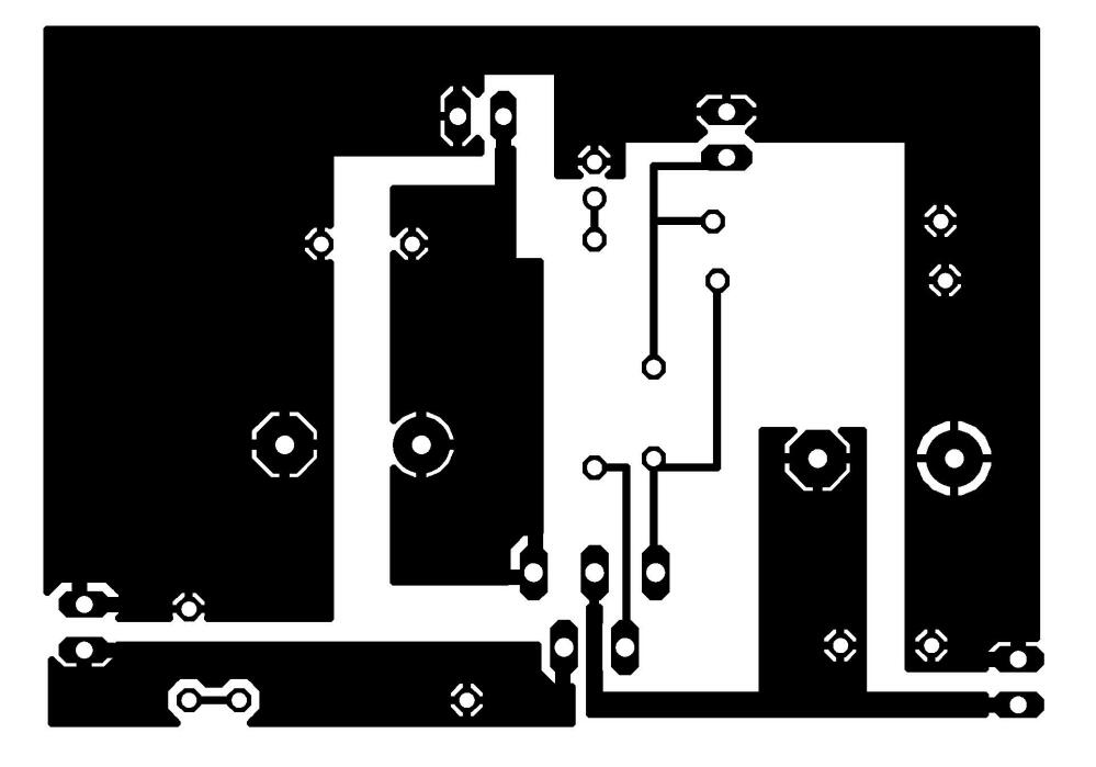

DipTrace early review.
After only a couple hours fiddling and reading actually have something without a lot of hassle. Parts are a bit hard to find in the loooong list of some catagories. Agree on the footprint issue.
DipTrace Full,unlimited pins, unlimited layers, $495
DipTrace Standard,1000 pins, 4 signal layers $295
DipTrace Lite,500 pins, 2 signal layers $145
Bit pricey for DIY
Regards
