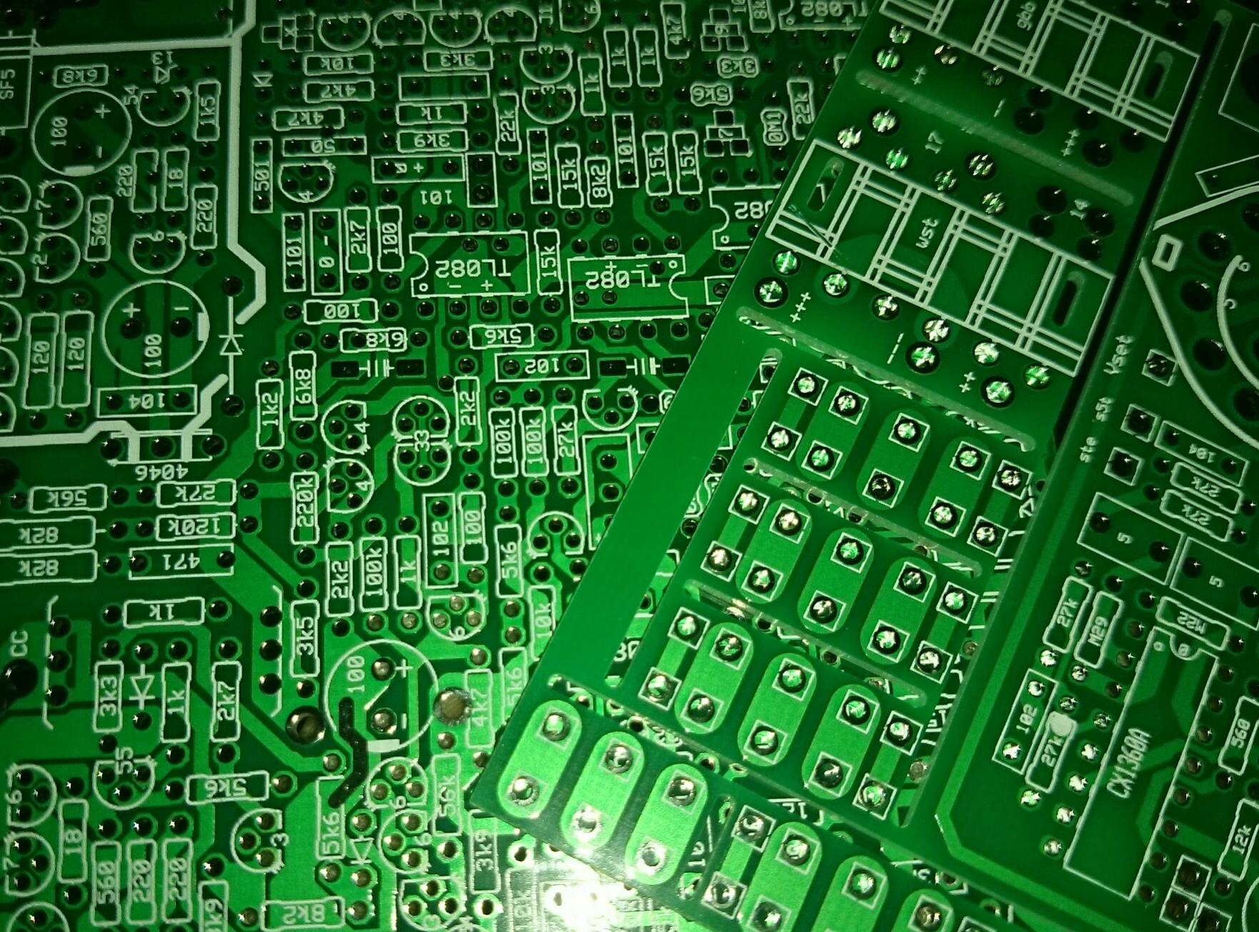

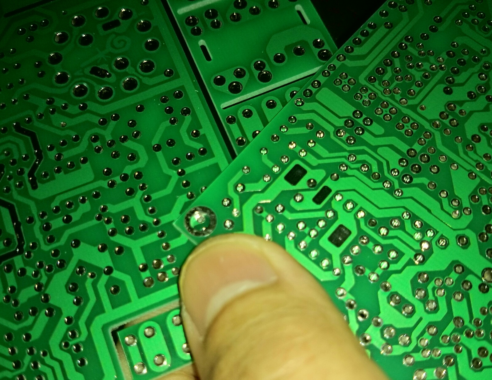

here. an example from elecrow pcb. very good for this price, saving both my time and fund.
Interesting way to annotate resistors with their value.
I guess it makes populating the pcb easier.
However, if you have to debug the pcb then which is R1 ?
Maybe a combination of R1 and value together (if there is room) might be better? R1-47K
in the past it was more text with smaller font and just square simbols for resistor, ic, etc, but later I found its more pleasant on my eyes while placing component with bigger text only simple value on it. and better symbols not just square and circle. just try it, its very pleasant at placement work.
