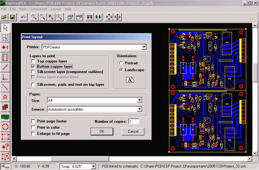

new relase ExpressPCB V5.4.0 from 11/27.2005
Hello,
there is a new version ExpressPCB on the server of www.expresspcb.com.
The new version can now print without the 'grid' an the page faces !
So update your ExpressPCB software.
I use the PDF Printer Driver PDFCreator v0.8 p2, very nice tool !
The Postscript engine in the background is Ghostscript.
Version: 5.4.0
Date: November 27, 2005
Download ExpressPCB

yes i update all my output on my project website.
Look, a orignal printout - PDF
http://dx.master.akadns.de/projekte/MikeB/showimg.php?file=/ESP Project 33/PCB/PCB_10_x_8cm.pdf
What do you think?

Yes my old files, one Release before, work with no problem !
I describe in Post #65 how i produce PDF's on my pc.
I create a image from the printscreen:

Yes, I've just tested, it works fine and prints with no grid.
dx.master said:I create a image from the printscreen:
I have made some PCBs with Express PCB, for my own designs, to etch at home.
This is the method I used to print with no grid.
Not very convenient, but it worked.
1) Draw the pcb layout on the top layer, or select all the bottom layer and send it to top.
2) Goto view and click on options.
3) Goto colors and change the bottom layer to white, top layer to black then click ok.
4) To print with no dots click on the red & green boxes
( 'place a rectangle' button) that are on the left.
5) Then click on the tab that says botom layer which should be on the top of the screen in green and gray.
6) Now take the mouse to the top corner of the yellow border and left click and hold it. Now pull down & to the right to high light. Now you can see a white rectangle.
Release the mouse buton, which your pattern will stick out in black.
7) Now to start printing goto file & click on print next, click on (top copper layer), (botom copper layer) & make sure you click on (print in color) then hit ok.
Now folks, with the new version this method is obsolete, it prints without grid, no tricks. 😎
Btw I use CutePDF Writer to create PDFs. It works like a printer driver (like many others), you just print to this driver.
And it's free.
