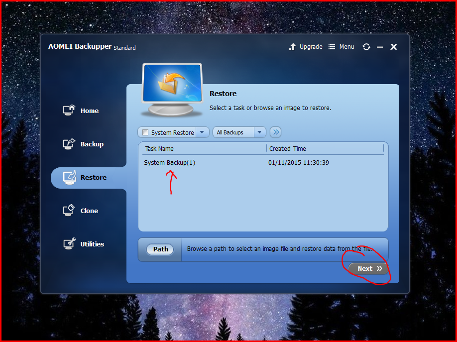

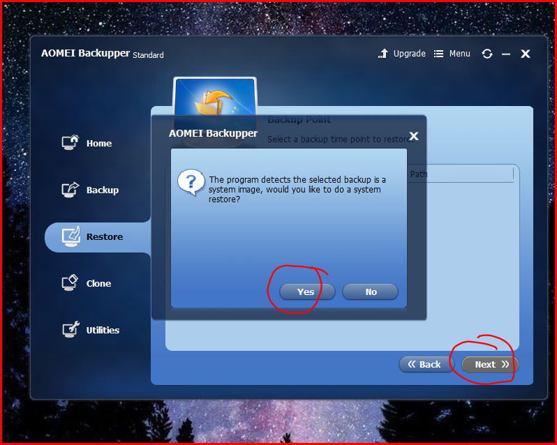

OK.
So, E ended up being the new partition. That's fine.
This shows what you see when you restore the image.
The first 3 screens are done and 95% of E remains unused.
Can I have direction to post323 before I do the restore?

trying restore now.
Note: There may be a boot or system partition on the destination disk, if you restore the operating system in the backup file to the destination disk, this could lead that the existing bootable partition on the destination disk does not boot.

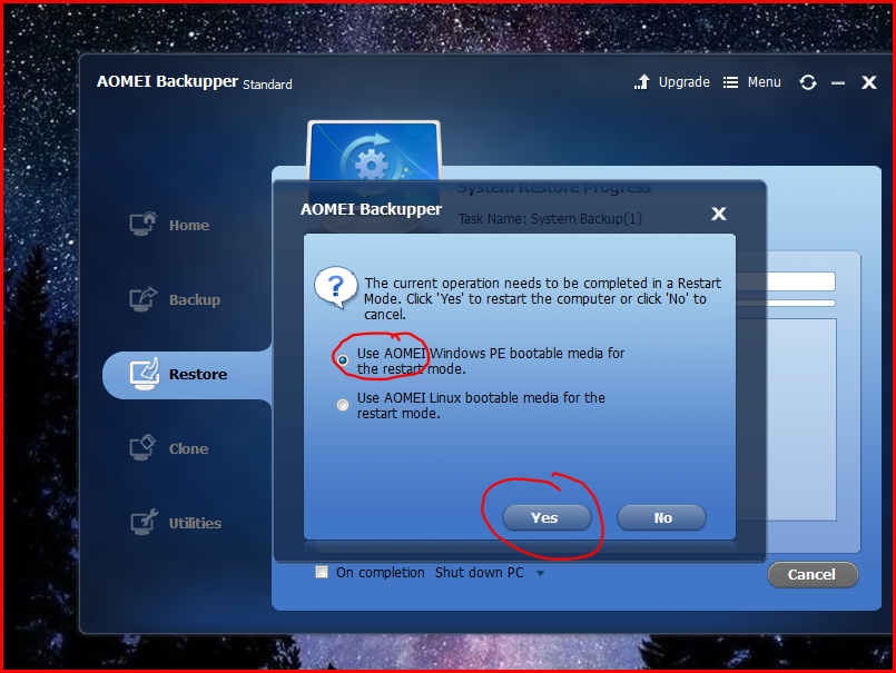

OK.
The system will reboot on its own, you will see some lines of text appear and then after a minute or so a more familiar screen showing the progress. If all goes well it will restart automatically at the end of the restore and boot back into Windows and you will be none the wiser that anything had happened i.e. it should all be as it was the instant you clicked to 'make the backup'.
It shouldn't take long to restore, my old Vista PC averaged around 1Gb a minute to rebuild the image, so about 25 to 30 minutes for a full install with all its programs and data. Yours is much lighter at the moment.
I completed the next input screens and restore is initialising.
has restarted and system restore progress.
moving data Total data to move is 10.99GB
Speed is ~30MB/s, not 1Gb/s
completed in 8minutes.
