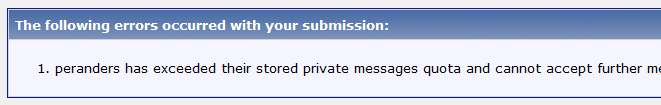

Hi peranders, your Private Messages box seems to have overflowed, image attached.
_
