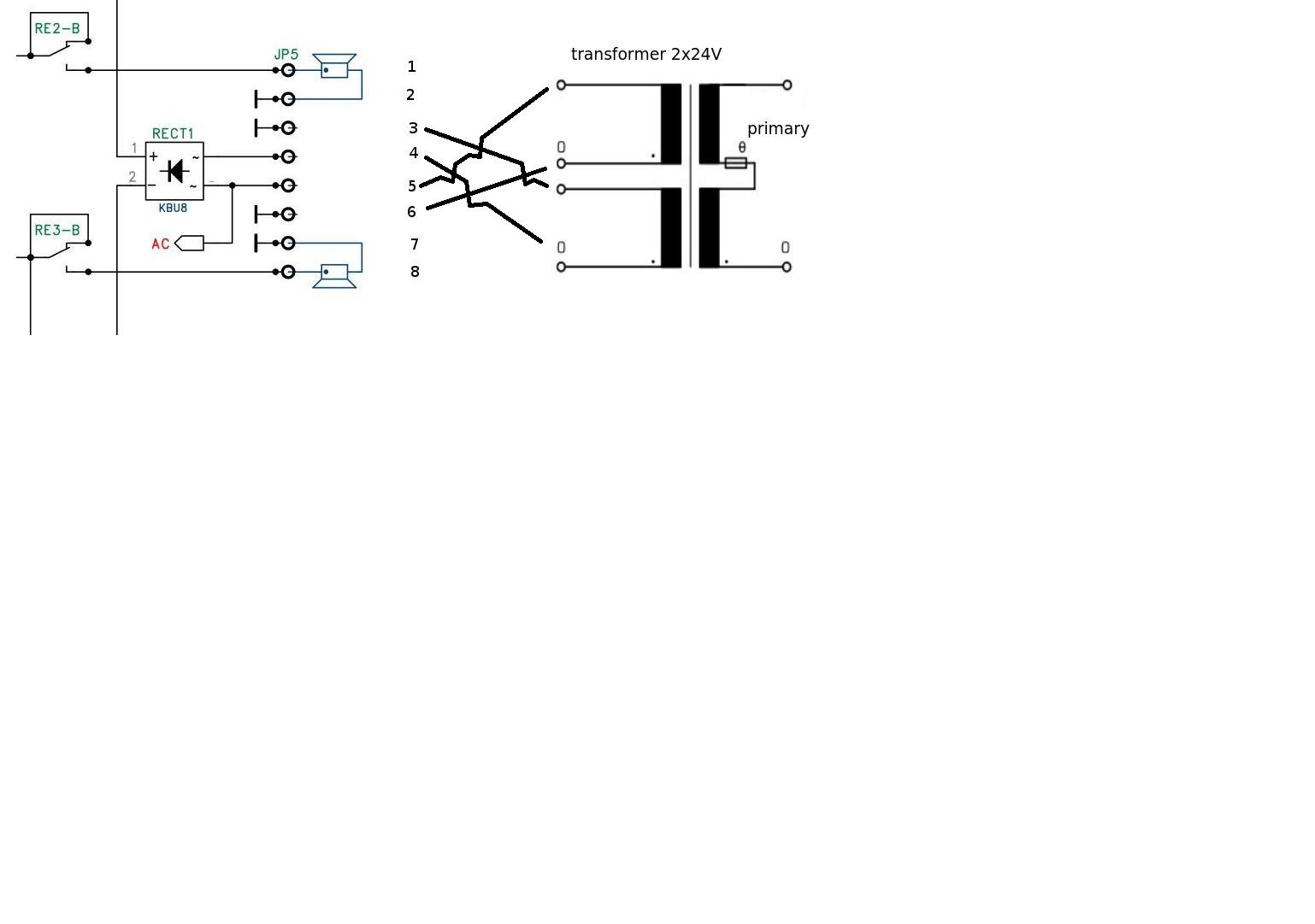

Hi Clog
Its shown on the scematic downloaded here:
http://sjostrom.pro/wiki/tiki-index.php?page=PA03+third+round+Group+Buy
Don't forget to check your primary wiring is correct for your mains voltage too (110/230)

Of course I have seen the schematic but then I stumbled upon this post
http://www.diyaudio.com/forums/chip-amps/277081-pa03-startup-mistake.html
Remember one winding with dot to ground and the other winding "no dot" to ground, exactly according to the schematic.Hi Clog

I think what's happened with redjr is he/she has been using a transformer with single secondry with a centre tap. Rather than a transformer with two secondry windings. so when redjr connected the single secondy accross the outer pins it would have shorted the transformer. If your transformer has two secondry windings as per your diagram just do as the schematic shows.
Sent from my SM-G920F using Tapatalk
Thanks peranders and JammyBStard. When I saw the schematic and my transformer I thought wiring is easy. Then I saw the post by redjr and I thought "this is gonna be complicated". As I understand now just newbee worries.
