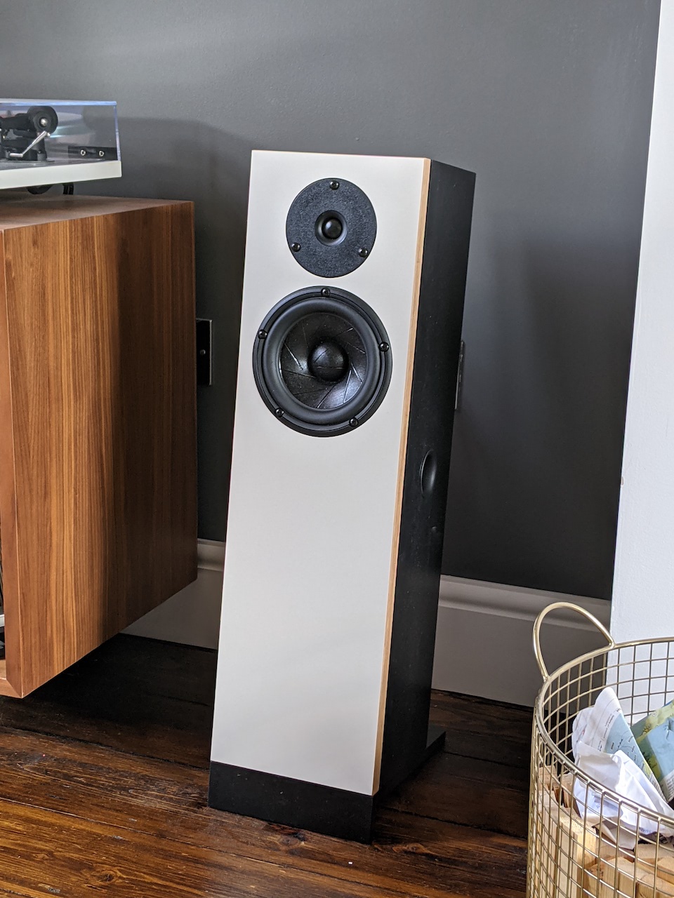

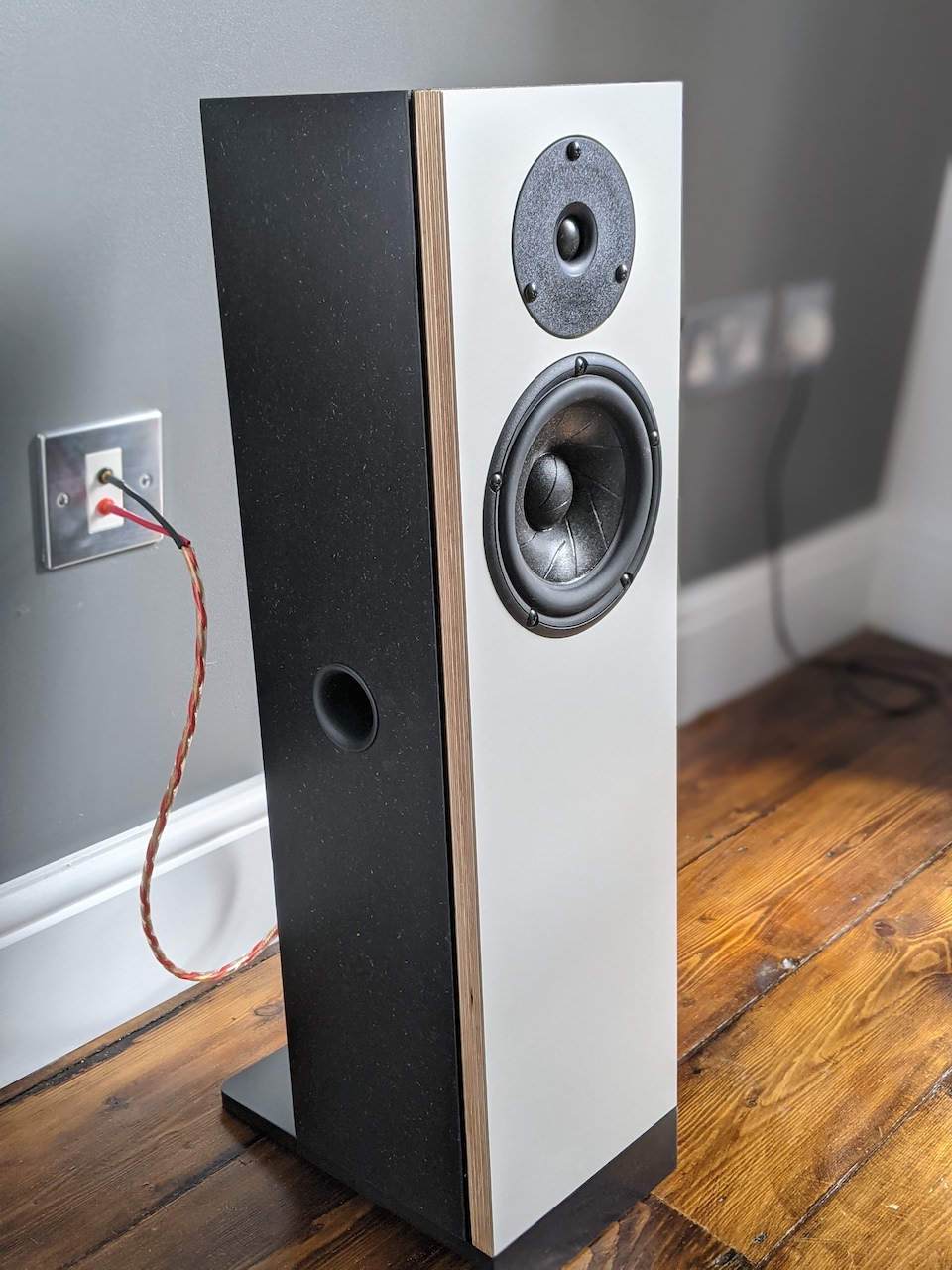

Realise this is a bit of an old thread but having finished my take on Pauls design I really do love the effortlessness of these speakers and the sound that belies their size. I have to agree though that for me they are a touch too laid back and wondered if anyone had experimented with the crossover to bring a bit more sparkle to the top end of these?

Kudos on completing your build!
Looks like you have changed the cabinet dimensions - would you mind sharing?
Also it would be good to know what is your amp and source.

Yes of course! So I've based them on the same dimensions as the Royd Minstrel - a speaker I know well. This is 180mm wide, 625mm tall and usually 110mm deep. However the volume of these is at 12 litres which makes them 170mm deep and achieves a nice balance in looks and performance.
I could have gone to 15 litres but then the cabinets started looking a little voluminous for their size and where they are positioned. They are tuned similarly to the Carerra at around 42Hz - 43Hz
I mainly use a modest Naim Uniti (gen 1) streaming from Spotify, the odd CD or occasionally Vinyl from a Rega Planar 3. I have used a Hypex nCore stereo power amp with the Uniti and that was a most definite lift in the detail.
