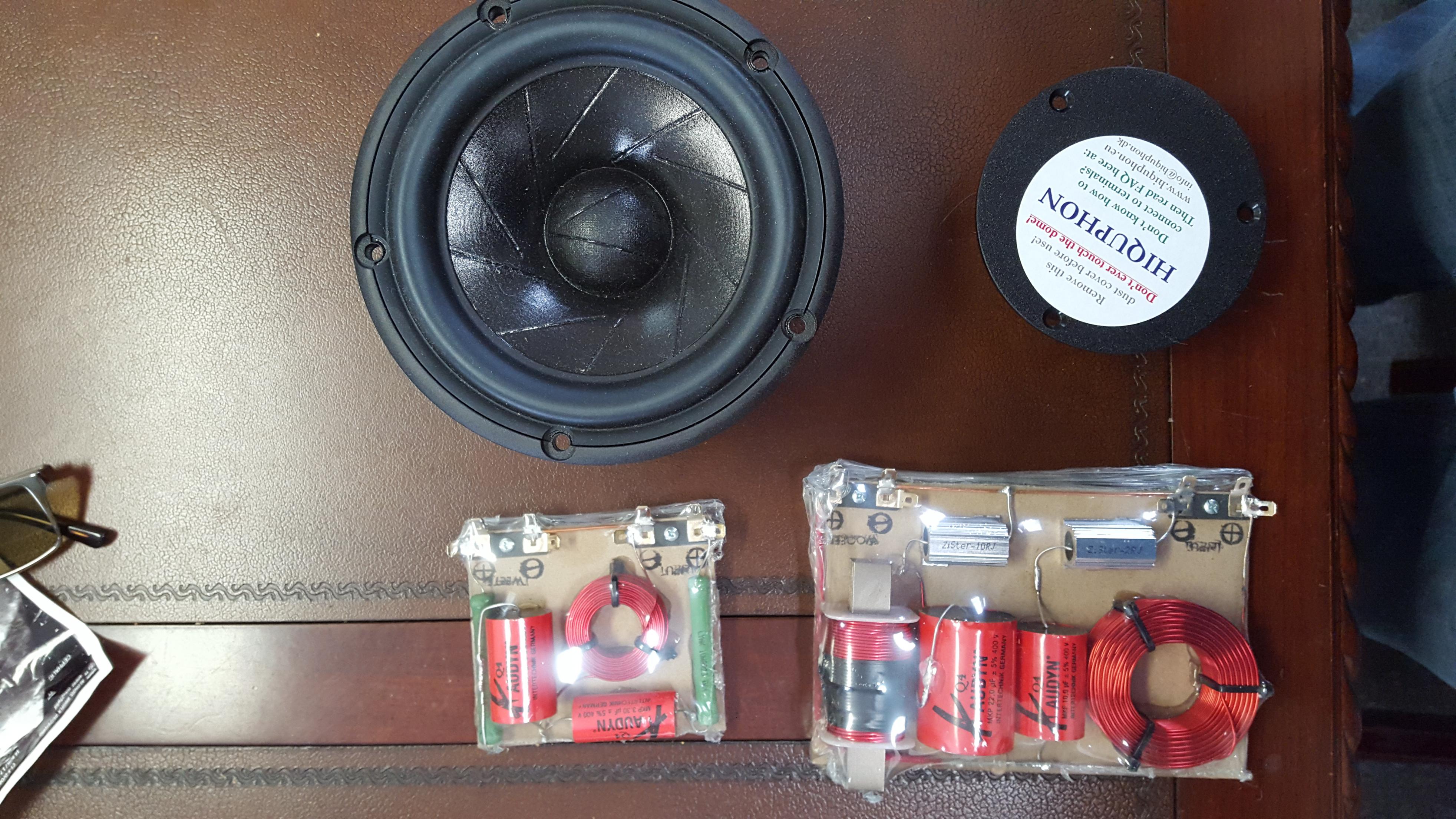

Nice! I used Jentzen caps on mine. If I remember, the kit came with some trash electrolytic 22uF caps, which should definitely be replaced. Everything else in the kit looks good.

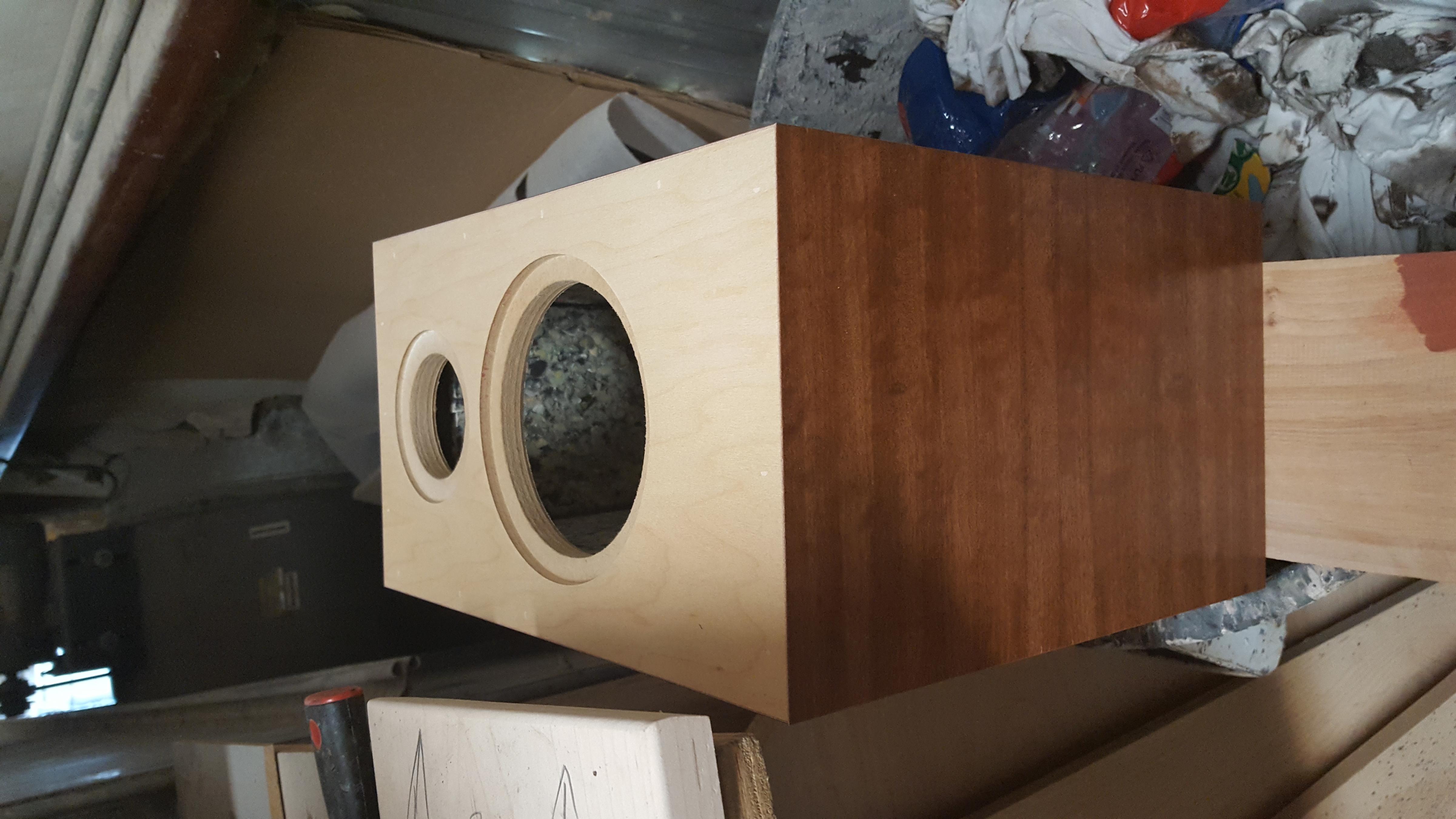

The hardest thing will be cutting the baffle since I've long ago lost access to a CNC router and have minimal hand tools. Fingers crossed on this one.
Cutting the baffle was a problem for me too since I don't have a circle router guide. In the end I just surface mounted the drivers, and got the black baffle cut on a laser, which then fit around them to make them flush.

Man, I was thinking you would be sharing pics of cleanly cut plywood very soon courtesy of the CNC router. 🙂
If you have a tool like the Jasper jig, the baffles should not be too difficult to do by hand router. Keep us posted.

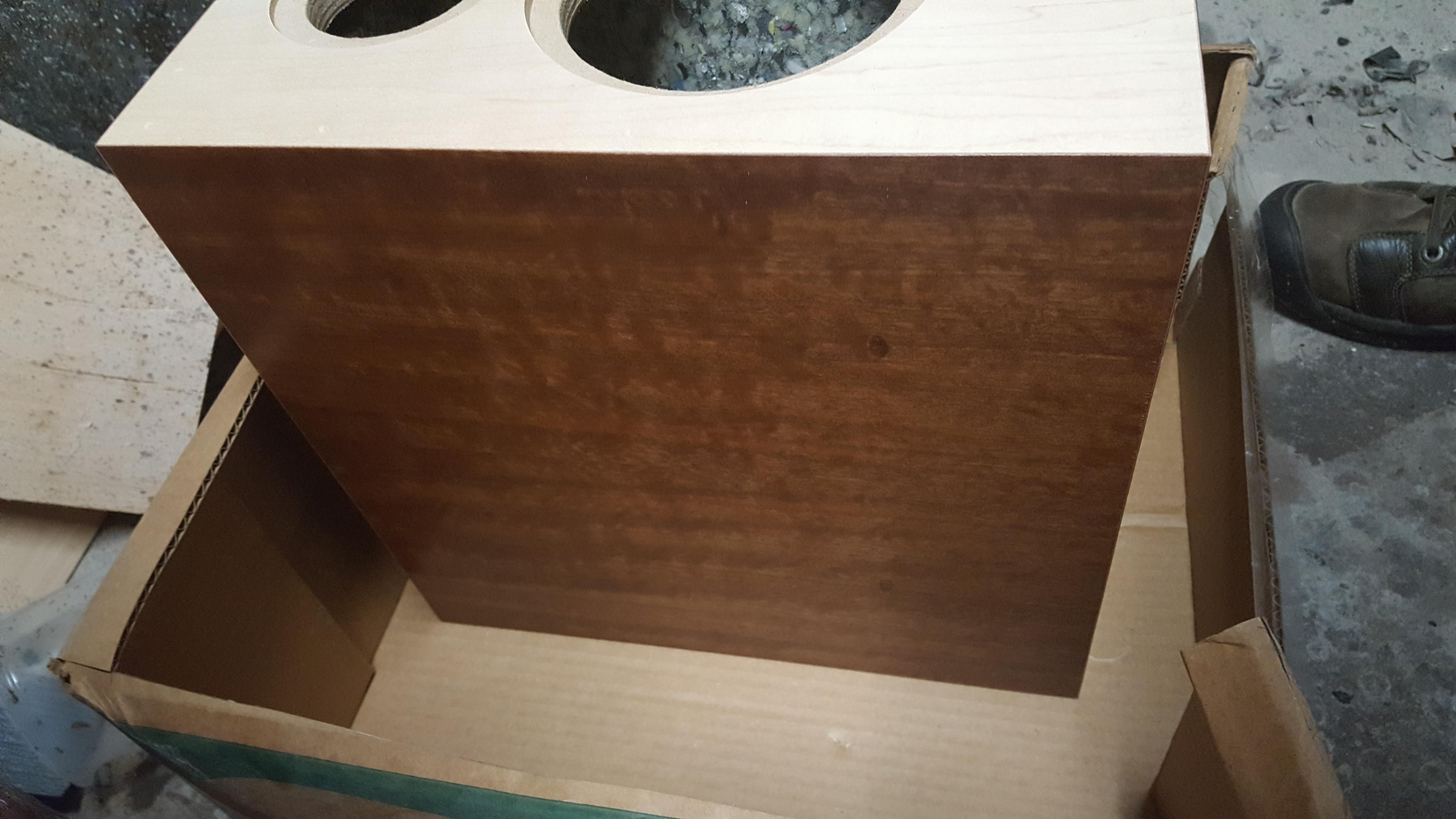

Well, I checked this morning and I just might be able to do some CNC work, but it would be minimal if any. We'll see. The toughest decision I have now is mottled makore or bubinga veneer.
Nice veneer. What kind is it?
Makore is the species. Or is your question towards the OP?
If well executed, either of the too choices will yield striking results.
I ordered up the makore and am awaiting it from the mill. I estimate it should be shipped by the end of next week. The kit is due in on Monday and I verified that I can use the CNC router for this pair of speakers. I may have a line on some pre-veneered MDF with birds eye maple on the front which I think would be real nice on contrast with the Makore. Will keep you guys posted on how it shapes up. Another option is to just paint the faces black as I will need to build some grills as well.

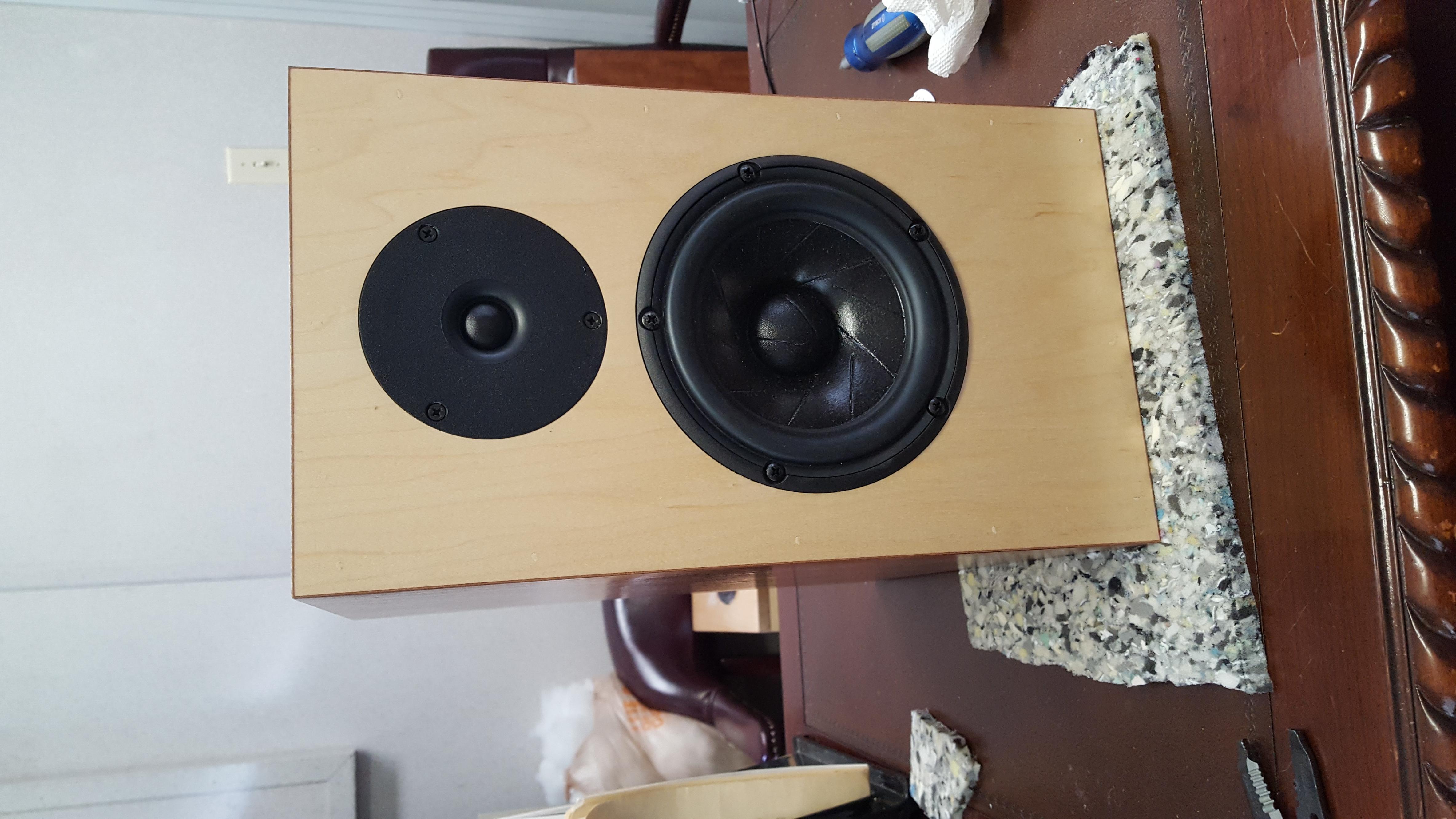

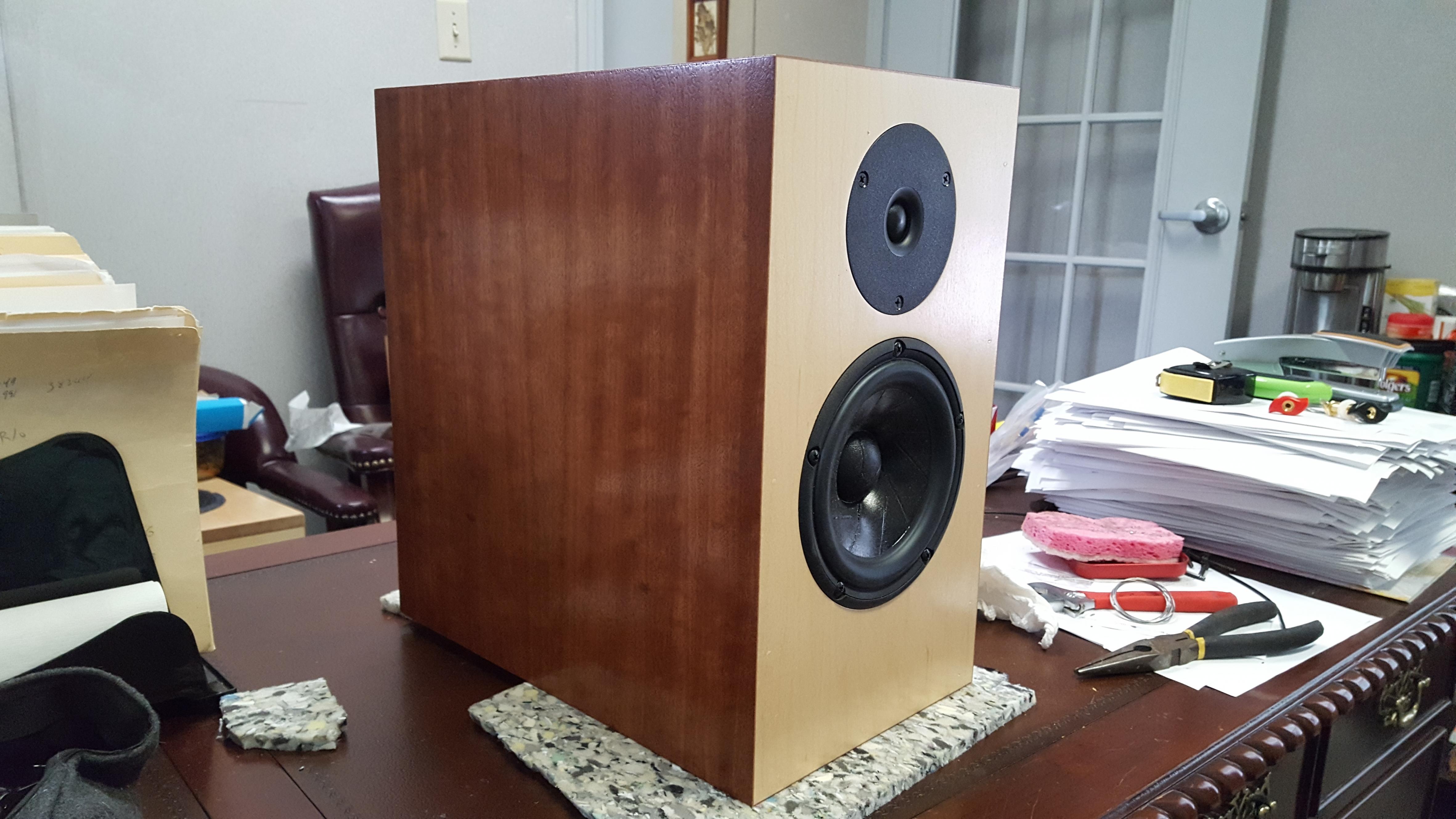

Alright. I got them finished finally. At this moment I've only had about 20 minutes of very low level listening (finished them at the office / don't tell the boss). So far it's a bit too early to give any real listening impressions due to their freshness and low level volume. What I hear I do like. I can definitely tell that after these crossovers and drivers settle in they will no doubt be my new reference speaker.
I will note that on this build I had difficulty with the tweeters. The "solder cup" is a terrible design. Why the designer ever thought this would be a good idea to use is just beyond me. As of now, I'm still quite unsure of the actual holding power of the solder job I did on them. It was incredibly difficult to not only flow solder into these cups but to even get the solder to stick! I used Cardas Quad Eutectic solder which on everything I've used it on, was perfect. Except for these solder cups.... it would either fall right out or just stick to my iron. I even went as far as cleaning the contacts with alcohol to try and possibly clean off any residue... of which there seemed to be some kind of black film that came off. Even after cleaning them it was still difficult but I managed to slow some in there and dip the wires in just enough for them to hold. A few yanks to make sure it was "solid" and I was done messing with it. Still as mentioned I'm quite unsure of the actual job done, but it is what it is.
Anywho, aside from that the build went as planned. I used the block mottled makore as mentioned earlier and unfortunately it seems the figuring doesn't pop like I had hoped. It looks like standard mahogany until you take them into the sunlight which is when the figuring comes out to play, flashing blocks of irridescent flakes of gold. It's very pretty and nearly impossible to photograph unless you have a good cam (I don't).
Another odd thing I found is that these speakers call for zero bracing. I was a bit worried about this but threw caution to the wind and built them as designed. I do notice a slight bit of panel flex/resonance even at low volumes but it doesn't seem to smear the midrange. I should also note that I installed a layer of adhesive backed rubber before I installed the foam.
I can't wait to get these speakers home and hook them up to my main rig. That'll be the real acid test. Will update at a later date when I've had a good 50/100 hours on them or so.

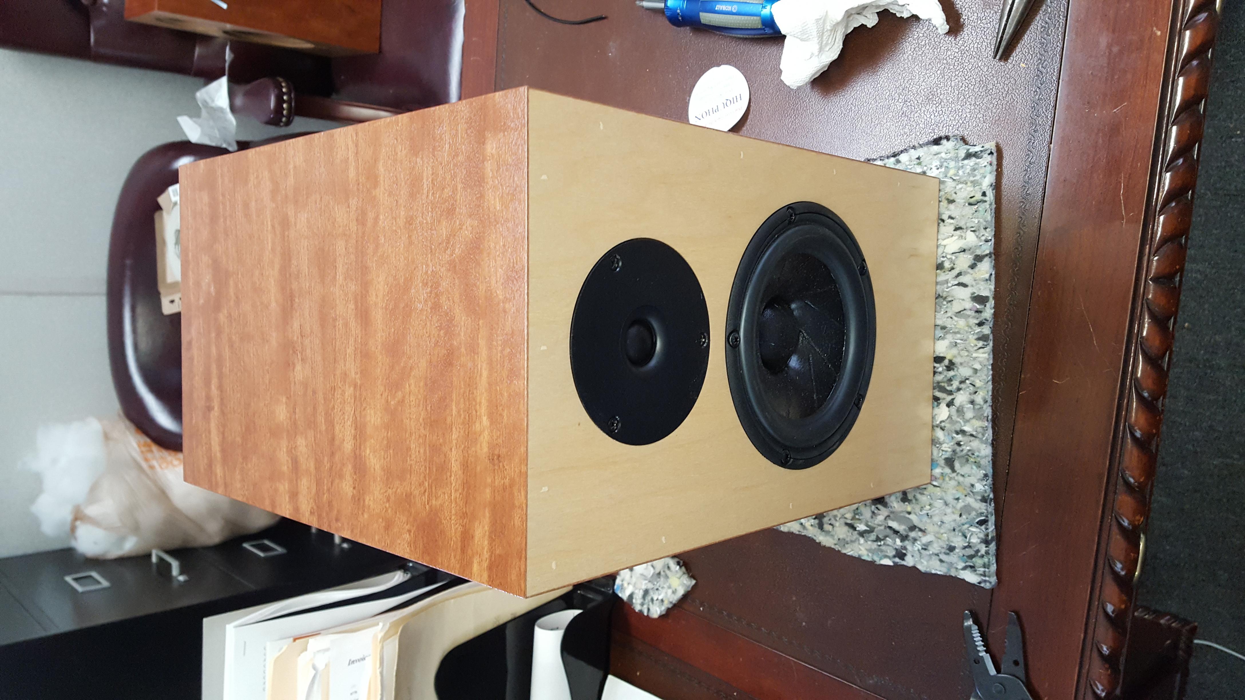

Well, I figured Paul would know best so I only used 3/4" MDF all the way around and no bracing as he specifies. Guess I should have gone with my gut and reinforced them at least a little. Oh well, no biggie still sounds great to me and I'm glad there's no smearing of the very important midrange. I finally managed to attach a couple pics. Enjoy!
And just a couple without the drivers. Adding pic of crossovers. Meniscus did a beautiful job building these crossovers. Kudos to them.
Great job, they look awesome!
Glad to see you got your hands on that CNC in the end.
Also, great work on the veneering, it's way better than I could ever do!
Thanks! Yeah the CNC access definitely helped. Going to let them run in over the weekend and we'll go from there. Glad to be apart of the Carrera family, these things do vocals like crazy.
