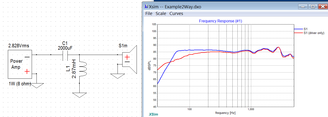

Now, add an impedance Z in series with the voice coil. (could be a resistor or a capacitor)
Ii = Va/(Re + Z) – Vb(Re + Z).
Notice that the ratio of driving current to damping current remains unchanged. The Q of the driver is unchanged. The only thing that has changed is the voltage you would measure at the voice coil. Anybody using a 2 channel measurement system that includes a reference probe understands this. With the reference probe attached at the voice coil, it doesn’t matter what impedance you put between the amplifier and woofer; the measured SPL response will be the same. All the series capacitor is doing is forming a passive EQ, changing the voltage applied to the voice coil.
So what about the difference in damping you feel when pushing on the cone? Well, you’ve added another term to the equation of motion…a force that doesn’t act thru BLi and thus doesn’t scale proportionally with impedance in series with the voice coil. So, of course you notice a difference. But, it has nothing to do with the behavior of a woofer driven thru its voice coil.
... The only thing that has changed is the voltage you would measure at the voice coil....

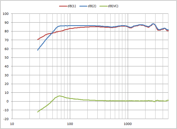

How would you explain the FR plots in post #42? Is somehow some extra voltage is getting to the driver at 60 Hz and less at 20 Hz? Or is the speaker acoustic output peaking at its under-damped resonance?

Yup, that is exactly it.How would you explain the FR plots in post #42? Is somehow some extra voltage is getting to the driver at 60 Hz and less at 20 Hz?
The parts C1 and L1 form an under-damped HP filter providing the roughly +6dB boost transitioning to a -12dB/oct slope at lower frequencies. Green curve on the attached plot is roughly the voltage response you would measure at the woofer connections leading to the VC. No free lunch though, the boost comes with the cost of a corresponding increase in current demand from the amplifier. You might be interested to know that this technique of using under-damped 2nd order filters for EQing is often used to compensate for dipole roll-off with ESLs. I posted EQ response curves for some Martin Logan ESLs here:

right, the cap compensates the inductivity of the speaker and more current can flow through the voice coil. with Q=1 we can extend half an octave. Then the capacitive effect sets in and the slope is 18dB/oct, so it also high-passes as expected.

The cap also increases the output voltage by 3dB below the resonance, that has the effect of doubling your amp power.
dissipation will increase, but just in that area, above resonance there is a dip and less power is consumed.
You cannot do the same with active filters, they would require a bigger amp.
