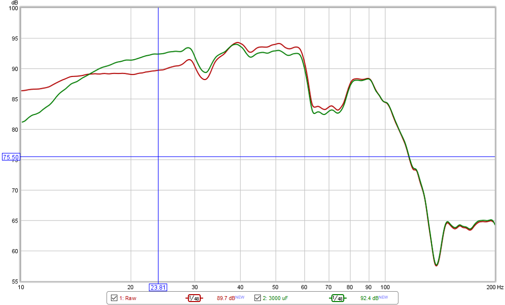

I decided to "try out" this type of alignment on the sealed subwoofer that I use in my car audio system. While the gain is not as great as my first example, there is still some improvement, in this case the response being flattened all the way down to 20 Hz. I can accomplish this already though with the EQ have have in the car's audio system and the subwoofer amp has plenty of power to spare, so sinking the extra $25 into the required series capacitance may not be worth it.
For a lark, I looked at the THD of the raw system from 200 Hz down. Less than 1% THD from 120 Hz down to 30 Hz, at ~93dB average during the passband. Not bad, eh? It's actually the midbass drivers that let this system down - they can't keep up. Not really their fault - door panels make horrible enclosures.

Yes, damping is changed. The entire resonance has changed. It is now third order. This kind of tuning is in this way akin to a vented box adding its two orders.I'm curious. Doesn't it affect somewhat "damping factor"
Surprisingly 28 hz boost comes free of increased distortion. This is a really interesting tweak 🙂 thanks brian

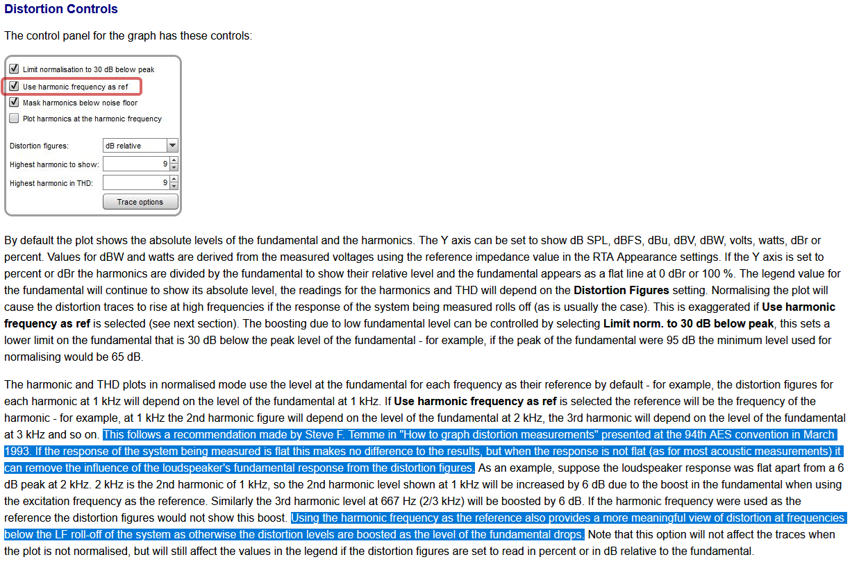

@Brian Steele,Here are the HD curves. Unfortunately REW does not provide a means for directly comparing HD measurements.
It is unusual to see reduced woofer distortion where LF response is boosted. Do you happen to remember the settings you used for the REW distortion plots? If you happen to still have the files saved, you might try using the check box for “Use harmonic frequency as ref”. This provides a more meaningful comparison of distortion when the response is not flat, or changes between test configurations.
Copies of the Temme paper referenced by the REW manual and B&K Appnote can be downloaded here:
http://www.pearl-hifi.com/06_Lit_Ar...pers/How_To_Graph_Distortion_Measurements.pdf
https://www.bksv.com/media/doc/BO0385.pdf
