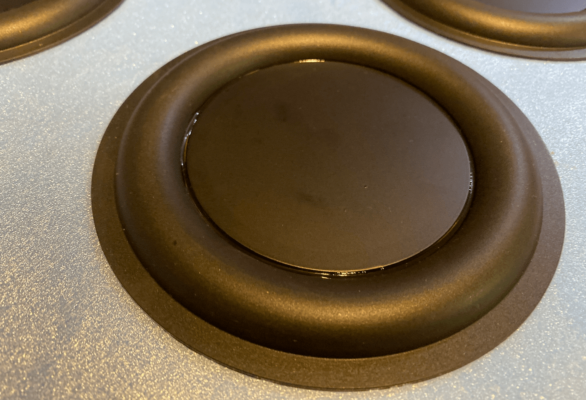

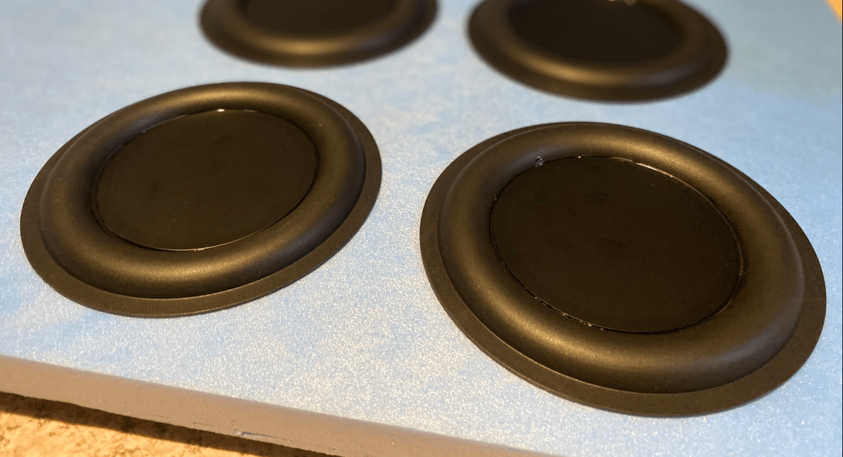

Time for an update on this. Starting development of a DIY 6" PR unit. Pictured are 4 sets for the diaphragm side ready. With FAT subwoofer type butyl rubber roll surrounds and total 70g moving mass for the surround and alloy disc. As well, the 30mm XPS foam sheet that the plugs will be CNC'd from and maybe stacked and scarfed together with foil
I will either print or CNC a custom sealed sides basket that attaches to the port tube (PVC) at either end

Randy,Re the second point. How about replacing the air mass in the original poor aspect long resonant port with the non-resonant (audio frequencies) foam plug and tube. Sandwiching the plug in that tube with a pair of diaphragms at either end. The slight amount of air left inside this structure will act as air bearings.
A 6" diameter port tube ~117" (three meters) long contains ~70 grams of air, a 70gram PR can replace it, without the air volume and pipe resonance of such a long tube.
That said, the Sd (equivalent piston area of the diaphragm) of a 6" diameter PR would be considerably less than a 6" diameter piston, as ~2/3 of the surround does not contribute to Sd.
The Sd of the PR exposed to the outside of the cabinet is the only part making low frequency output (SPL) around the Fb (tuning frequency).
Sounds like you are suggesting four diaphragms, surrounds and a plug of foam between them to do the work of one PR.
Any compression and rarefaction of the air between the diaphragms and surrounds will waste power and reduce their phase coherency.
Large displacement is required for low frequency output, and since the PR does most of the displacement at Fb, it needs to be around double that of the driven diaphragm since four times the displacement is required for each halving of frequency to maintain the same SPL level.The objective here is to bring down the price of PR systems by reducing diameter. Can such a PR based port piston replace a long and poor aspect BR air based port?
Sd ) times (linear) excursion = displacement.
To displace the same volume, a smaller diameter PR needs more excursion than a larger diameter PR.
A surround with more excursion costs more, and reduces Sd.
So far, seems your approach will increase the cost per displacement ratio by a large amount, the opposite of your intention.

Guys, not really trying to make a traditional PR here. The four flapperers are to make two sets and these four total AUD $26 not counting the foam which divides into cents per disc layer
The aim is to retain the poor aspect port, not replace it with a traditional PR. I propose to use these to cap a 2-4" dia port and connect them with a foam pushrod through the port. The SD would be greater than the port dia and represent the dia at a port flare rather than straight tube
Why waste cabinet space with a non-functional 2-4" dia port ?I propose to use these to cap a 2-4" dia port and connect them with a foam pushrod through the port.
