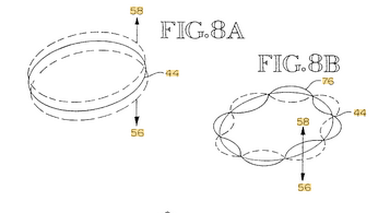

So inertia is not the problem? I also don't understand about the linear requirement for a passive?
Inertia of the PR mass should be near the same as the equivalent air mass of a port the same diameter as the PR Sd that produces an equal Fb.
If the PR Vas varies with excursion (is non-linear) the Fb will be affected.
If the PR "rocks", (upper portion of the cone not traveling the same direction as the lower portion) at high excursions, it's output will be reduced compared to lower levels, as well as changing the Fb.
Means that PR should ideally create the same flow-resistance as an optimal bass reflex port for x woofer in x enclosure?
The optimal bass reflex port for a small enclosure must be much longer than in a large enclosure, and requires more air mass to achieve a flow rate low enough to eliminate turbulence and net air flow.
The PR emulates the equivalent air mass of a port the same diameter as the PR Sd that produces an equal Fb, but does not allow any net air "flow".
This patent goes into some detail about approaches to reducing rocking modes and increase linearity:
https://patents.google.com/patent/US6176345B1/en
"An important consideration for proper functional operation of a passive radiator is that it exhibits true pistonic motion over its entire design frequency range, and accommodate a very large linear excursion. Pistonic motion means that the entire diaphragm and suspension (compliance) move back and forth to displace air substantially the same distance, in the same direction, at the same time. This movement replicates the reciprocal movement of a piston. Linear excursion refers to the length of travel of the radiator assembly. Both effective pistonic motion and relatively large linear excursion are very difficult to achieve with conventional passive radiator technology.
Another serious design challenge in passive radiators is minimizing the many different breakup modes of the outer compliance, which produces undesirable audible effects.
FIG. 8B shows the effects of compliance breakup in a rim resonance mode of operation, during large excursions. In some cases, the compliance will actually move out of phase for in the opposite direction), relative to the radiator's diaphragm."
There are lots of different approaches depicted in many different patents to reduce the problems...
