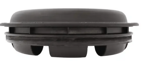

Might this be due to building PRs in the manner of active drivers? A custom surround for that side panel will cost me about AUD $30 but as you can see, I am trying to explore all options here
AUD $30 for a single surround is still pretty high, but "custom" has a price.
If you want cost effective, look for standard or salvaged surrounds.
Most passive radiators are built like active drivers so "off the shelf " parts can be used.

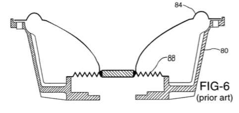

https://patentimages.storage.googleapis.com/fb/9e/c0/b3802418bf3e25/US6044925.pdf
The spider and surround make a parallelogram suspension, which reduces wobbling.
A single surround won't work well with the weight of a PR under the high pressure required for large excursions.

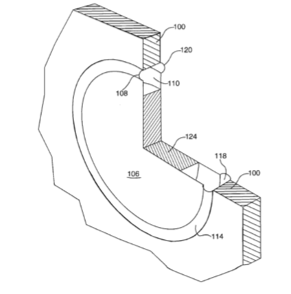

It seems Joseph Yaacoub Sahyoun's patent for the Symmetrically Loaded Passive System (SLAPS) patent has effectively kept manufacturer's from duplicating their approach:
Using two surrounds, the symmetrically loaded approach could be done DIY, the diaphragm could be made of inexpensive materials.
It saves considerable internal space compared to the standard cone approach, yet still provides a parallelogram link.

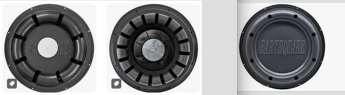

That said, two identical surrounds are still not optimum, as evident by Earthquake Sound's use of various cutouts on the rear surround:
I'm sure they went though many iterations before each version was "just right".
Certainly worth comparing the removed area of the surround compared to the Sd on their various models to determine the general trend.
