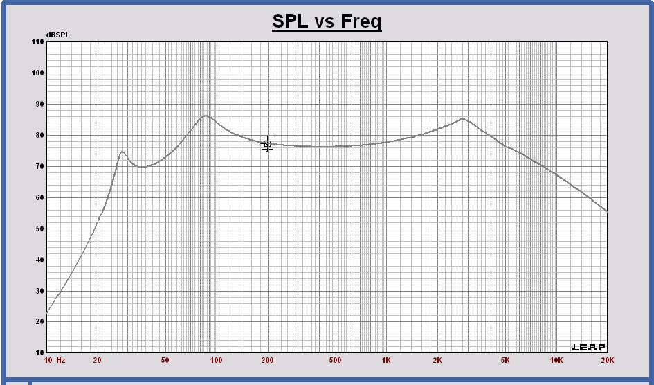

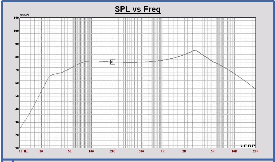

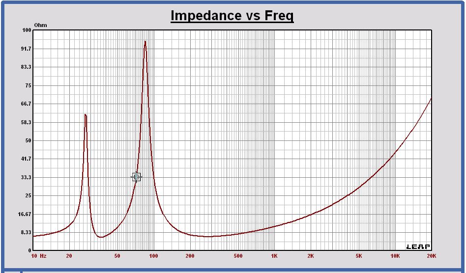

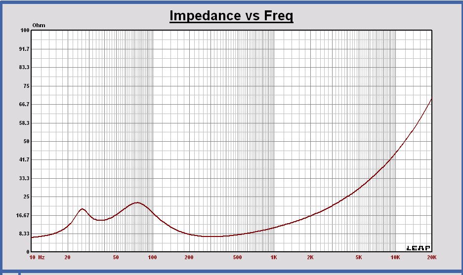

Hi Oon,
For Zout = 50Ohms, only mechanical damping is applied in your system.
These are the frequency response and impedance of the Beta 8cx in a 30litre box and a port of 2 inch diameter and 4 inch length (fB = 37Hz) with walls covered with damping material; simulation in Leap on infinite baffle.
What you can do is adding a lot of damping material in the box to increase the mechanical damping of the system. But you have to apply heavy fill in that case.
I have done a simulation by adding damping material for a impedance peak reduction to about 22 Ohm (highest impedance peak).
These are the simulation results for the frequency response and impedance in Leap.
It is an unusual approach doing this way, but in my opinion it can work.

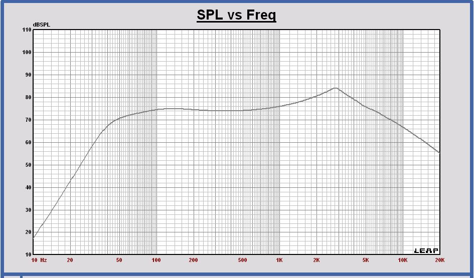

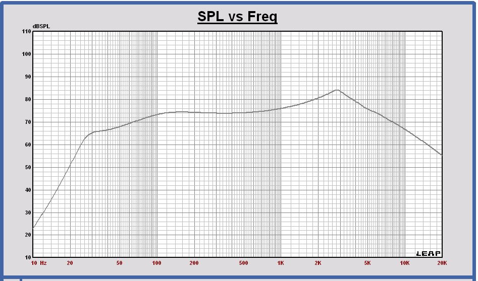

Hi Oon,
I have done some Leap simulations using a RLC serial network placed parallel with the speaker.
For your current setup I use Vb = 30 litres, port length = 4inch and port diameter = 2inch (or fB = 37Hz) and walls covered with damping material.
And I add an RLC serial network, R = 8.2 Ohm, L = 5.6 mH and C = 680 uF. Zout amplifier = 50 ohm.
frequency response:
Increasing the tuning frequency fB to 50 Hz makes it even better.
As setup I choose Vb = 30 litres, port length = 5 inch and port diameter = 3inch (or fB = 50Hz) and walls covered with damping material. Zout amplifier = 50 ohm.
frequency response:
These are simulations. In practice the impedance value probably will be a little different due to tolerances and different losses in your system. But the Leap simulation shows that something can be solved with the RLC network.
Remark that the frequency response simulations are done again for an infinite speaker baffle. In this way you see the low frequency system behaviour.
For the crossover design you need the full space frequency responses. I can also simulate these, but in that case I need the outer cabinet dimensions.
With thanks to Lojzek for the RLC tip !
Paul
