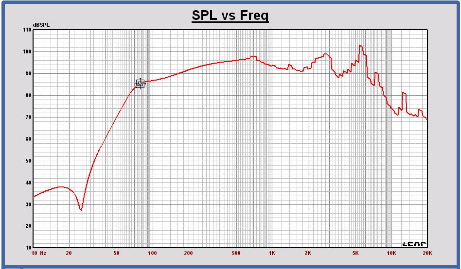

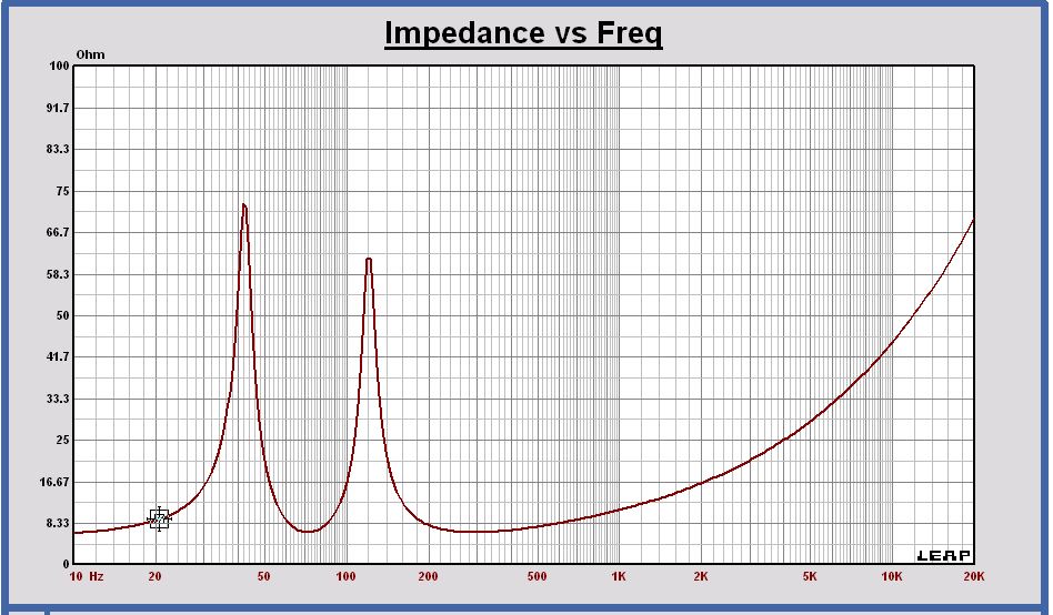

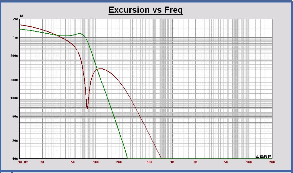

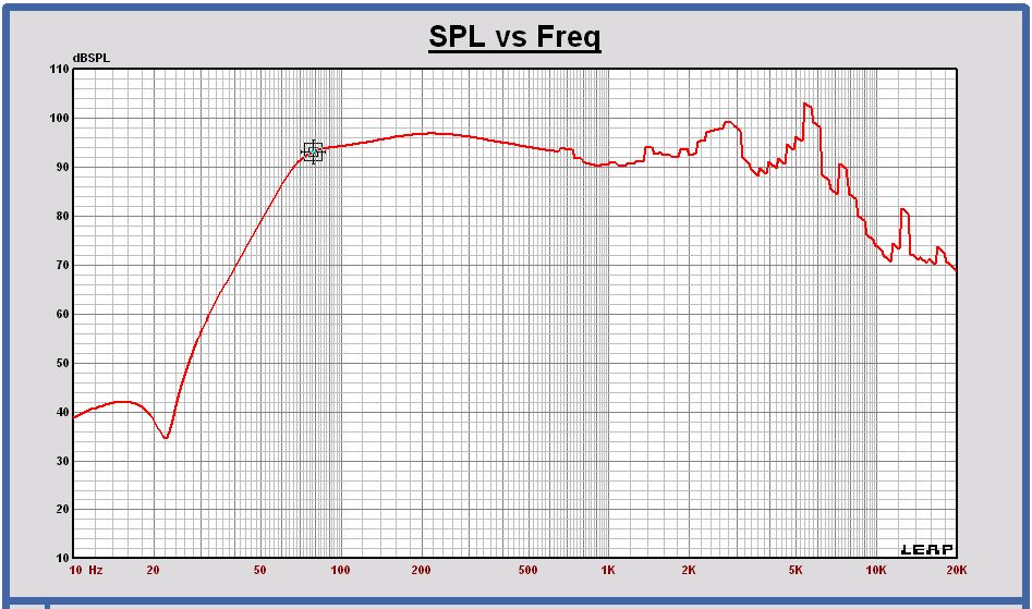

I think the peak could tuned lower and there should be less output at the bass...
In general WRT to PRs, should actually, dropping it at least an octave due to how they sound higher up, which in turn will likely require at least a 12" PR to get enough weight on it.
At a glance using Hornresp, it will only handle ~5W/100 dB/m to 30 Hz and making the cab > ~15 L gains nothing useful since like noted earlier it's only compliance controlled with this much series resistance.
