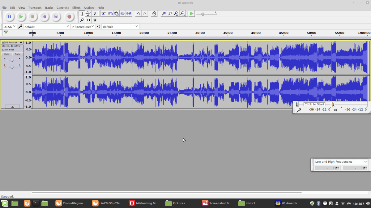

Here it is seen in light blue, with peak in dark blue. The link was informative thank you.

From ripping CDs and then looking at the resultant waveforms in various audio editors, I've seen that most tracks have peaks reaching to -1dB below 0dBFS. Many go all the way to 0dBFS, repeatedly.

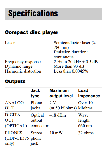

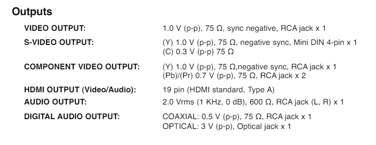

I'm just going to leave this here:
Sony CDP-CE375 SACD changer:
JVC DVD player:
Some CD players state their audio output as "nominal output 200mV RMS" (I know I have a DVD player manual that shows the output level that way, but I can't find it at the moment). If you think about it, a nominal level of 200mV RMS (exactly equal to 0.2V rms) allows for a 20dB peak from that nominal level to stay within the limit of 2V rms analog output when playing a 0dBFS PCM signal level from disc (or digital file). In other words, a 'nominal' level of 200mV rms is the same as saying "average program level allowing for +20dB peaks in the program material". One could argue that music on commercial recordings almost never contains audio signal peaks more than +15dB above the average signal level. If you look at it that way, a nominal signal level of 200mV rms allowing for +20dB peaks is the same exact thing as a 350mV rms nominal level allowing for +15dB peaks. They're the same thing!
I'd rather deal with absolute values.
JVC DVD player:
