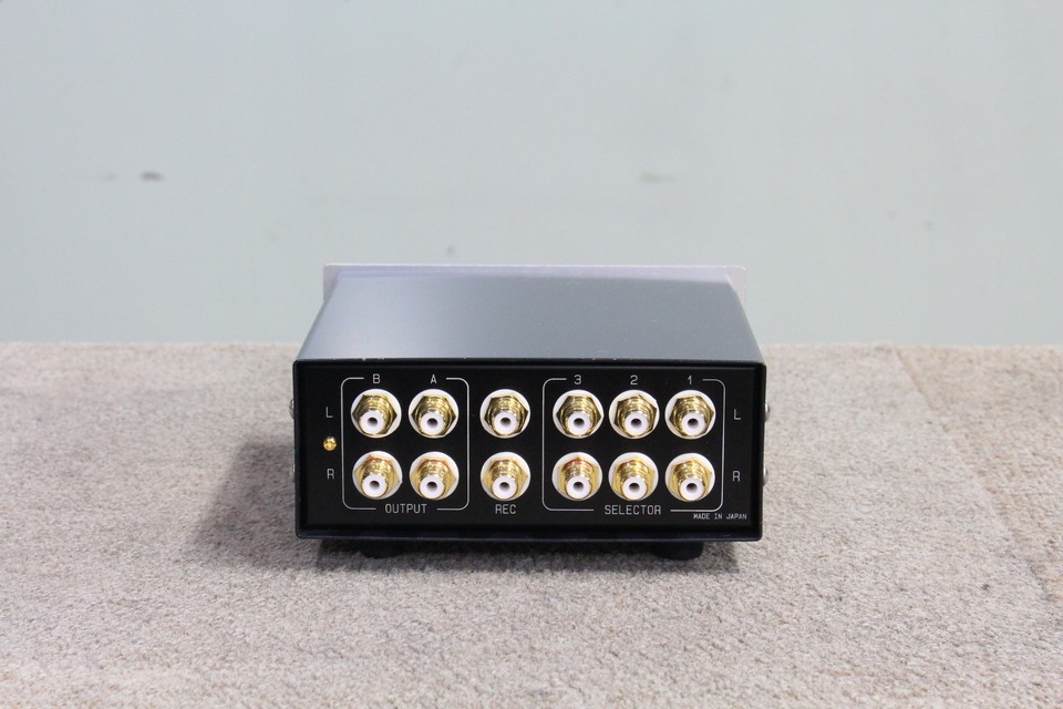

The model "Passive Selector PS-01" (Miyajima Laboratory) seems to be a good choice - but for me too expensive in Germany (650€) due absence of high quality rotary switches like e.g. ELMA 04 (only standard parts in use):
https://www.miyajima-lab.com/e-others.html
https://www.hifido.co.jp/sold/20-28...=0&LNG=E&OD=2&O=123000&L=50&SD1=0&SD2=0&SD3=0
https://www.hifistatement.net/tests/item/2983-miyajima-laboratory-ps-01?start=0
https://www.canuckaudiomart.com/details/649782457-miyajima-ps-01-passive-preamp/images/3484337/

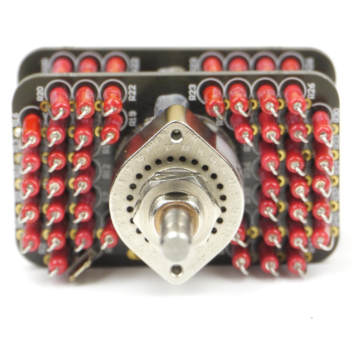

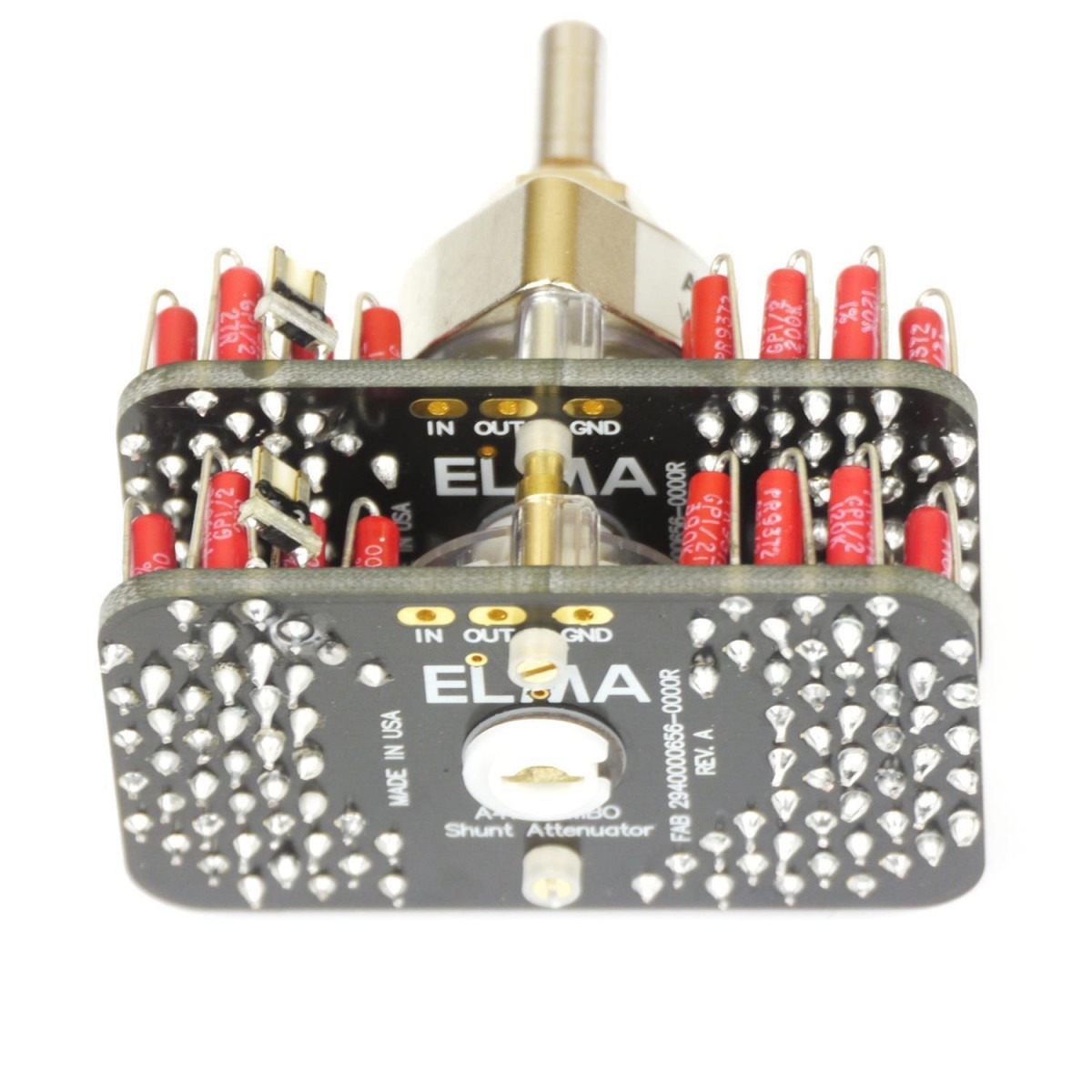

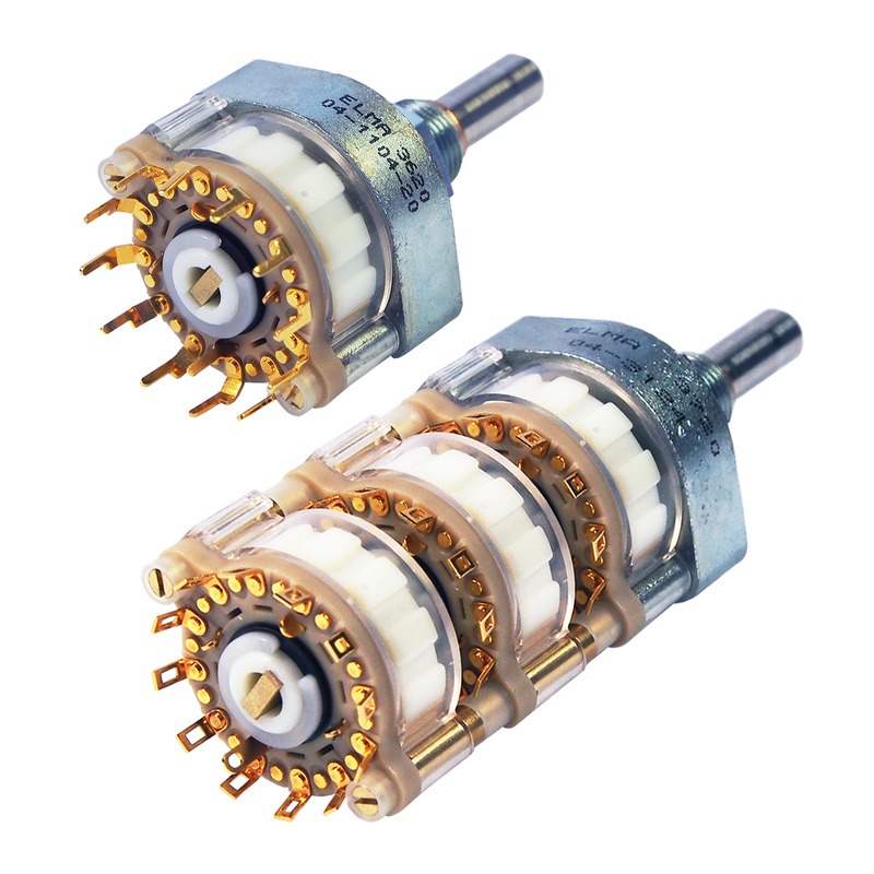

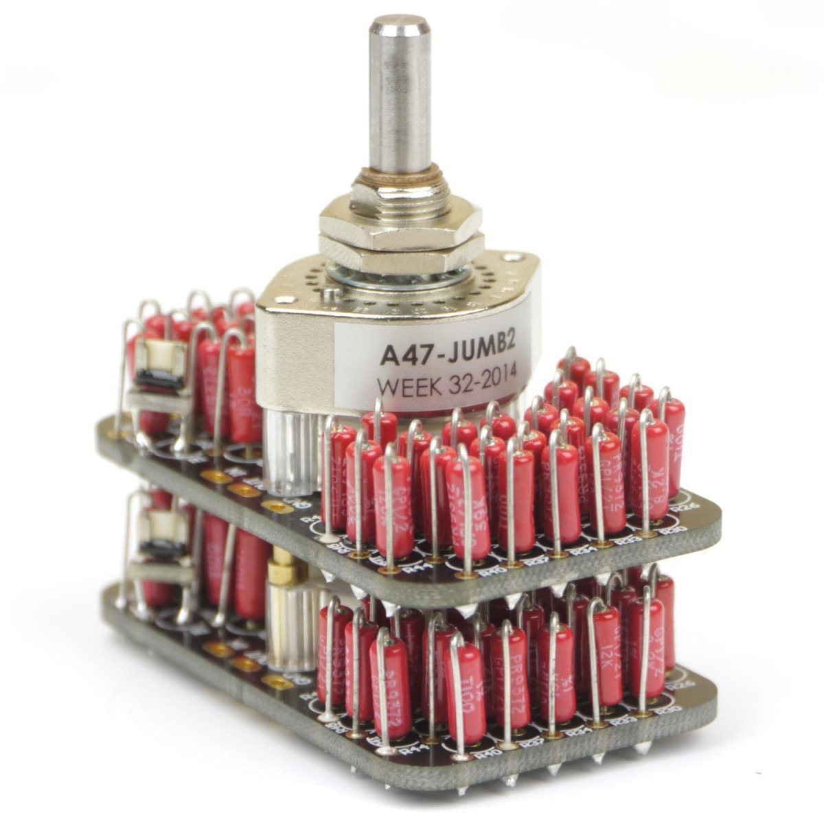

Rotary switches like those are better for stepped attenuator and input select
https://www.hificollective.co.uk/sites/default/files/wiring_of_all_stepped_attenuators.pdf
https://www.diyaudio.com/community/threads/stepped-attenuator-wiring.335904/
https://www.banzaimusic.com/ELMA-04-1264-20.html
https://www.elma.com/de/products/ro...yelets--12-24-positions--1--4-wafers-12822837

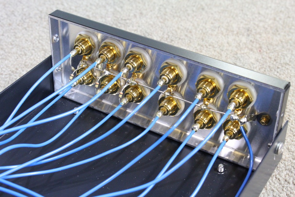

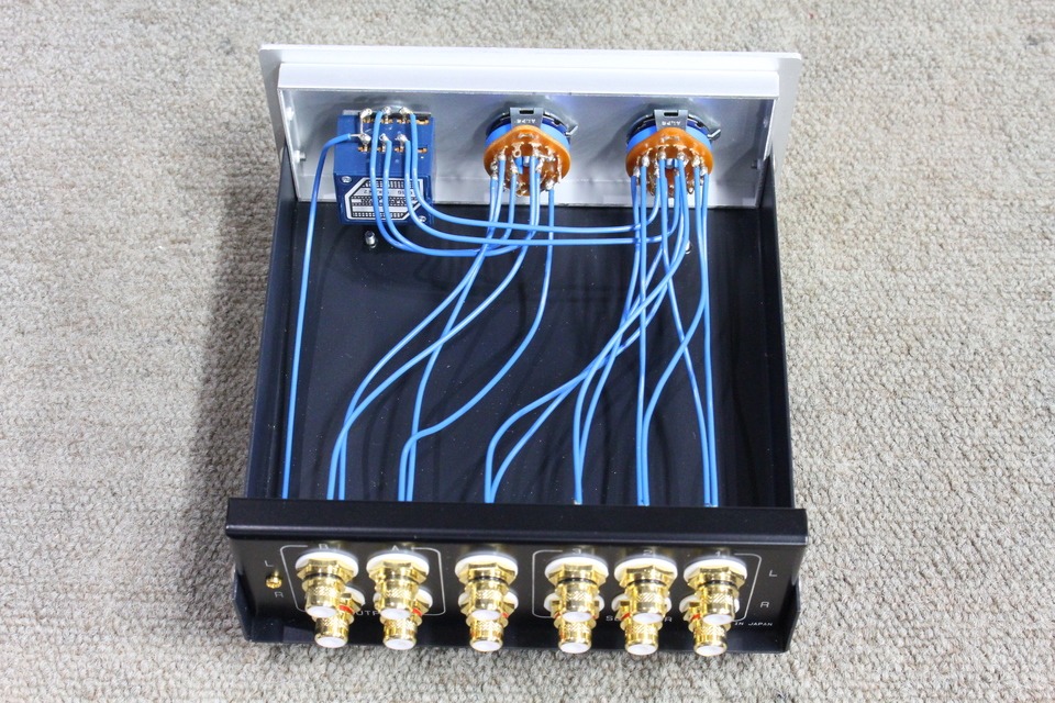

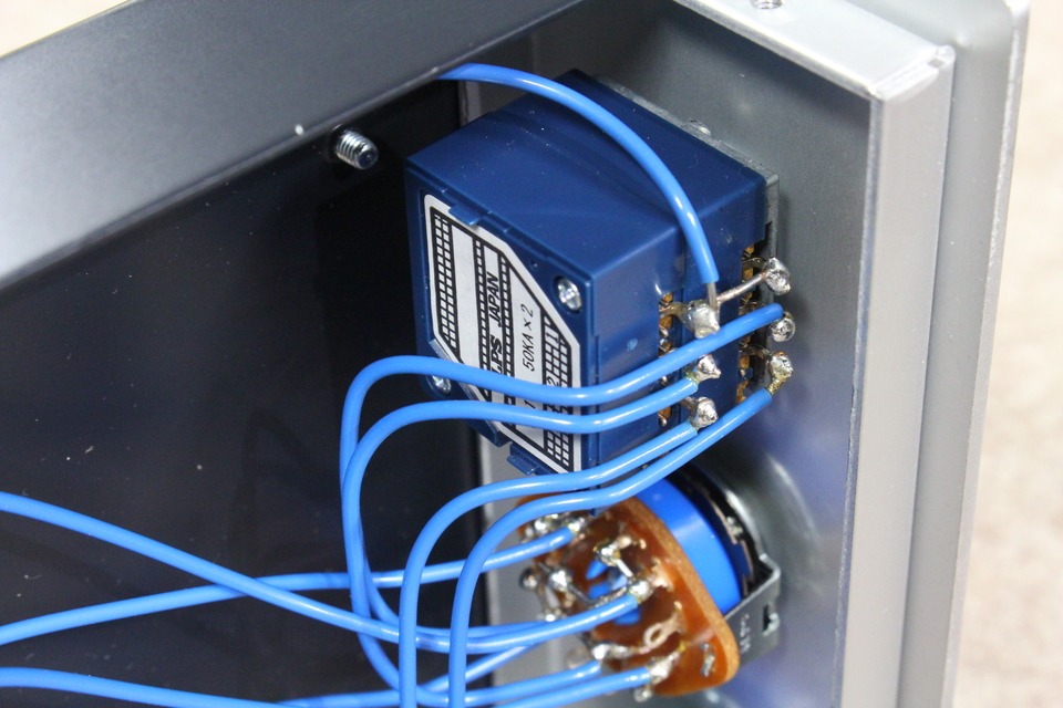

My favorite passive preamps uses parts as to find in the last four from attached images.
this are good examples:

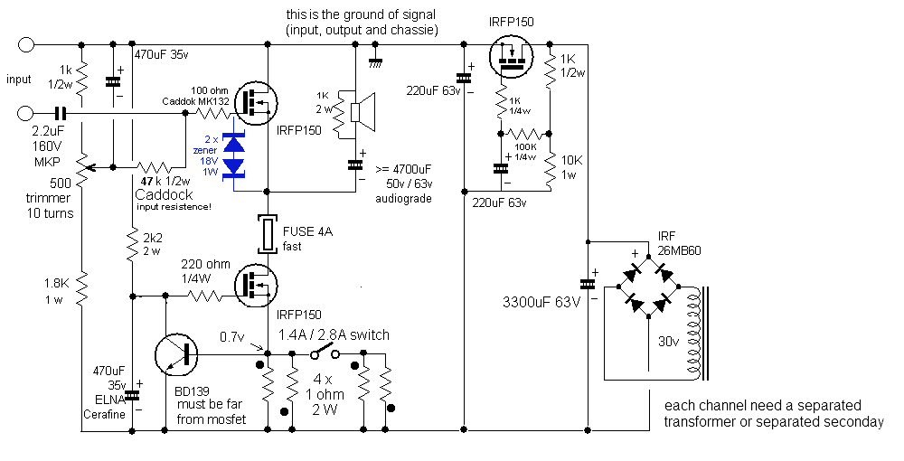

I tested Andrea Ciuffoli's power follower with only 12VDC supply voltage but 1A idle current. Not only for me best preamp ever - independent of used cables to power amp.

Andrea Ciuffoli's power follower is unity gain power amp, not a preamp. No need to place power amp after it. That completely defeats its purpose.My favorite design is a unity gain line stage with high current.

Yes, the genuine article describes a power amplifier.
But that does not automatically mean that this unity gain power amp approach is unsuitable for a pre-amplifier resp. line stage applications.
I define the quiescent current with the value of source resistor from IRFP150 (Ube current source).
1A seems to be too much for preamp applications, but I have chosen this value after various listening tests with different coax cables to the power amp.

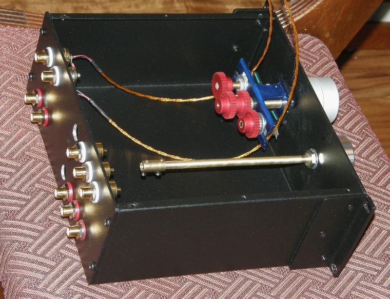

My approach on using separate pots!! Should have stuck a patent on it 🙂
Suggestion 1 : Use a long central control axle, move the pots near the RCA inputs/outputs, for much shorter cabling.
Suggestion 2 : Use three long axles, face the pots forward with normal knobs, and just a small knob/"pull button" for the centre axle. Adjust Vol. just by turning one of the two pot knobs --> the other pot will follow closely because of the gears.
Now allow a small amount of fore and aft movement for the center axle. Pull/push the "pull button" to disengage/reengage.
Now you've got Balance control capability, omitting the dreaded balance pot and surplus contacts !
Cheers!

If only I had a crew and a machine shop to go with it. This idea is very similar to what you described. But there are two inside shafts to the front volume split-knobs, one for each pot. This was more common back in the day. Now, to extend those pots to the back of the unit can be done, but it involves two more gears! This wasn't offered with the unit but can be done. The extra set of gears makes the turning correct for volume, but I say skip that and just use pots with no taper, and wire them in reverse.
FWIW, I have already decided to not use the extension shaft since in this instance it shortens nothing as far as signal wire length. What it does save is the total amount of wire used.
The Elma switch that I will be using allows me to not only select the input, but also only the ground from that particular input. It may be a small thing, but may eliminate a ground loop in the signal path.
