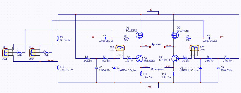

Look at this, it's 1 pcb. You may stack, for example, 5 units, on 1 heat sink. Parallel everything except for the speaker outs. Then, calibrate the 4 pots so that all the units match. Finally, bridge the speaker outputs & voila...
Non-VGS matched mosfets now matched.

Brian Guralnick said:Look at this, it's 1 pcb. You may stack, for example, 5 units, on 1 heat sink. Parallel everything except for the speaker outs. Then, calibrate the 4 pots so that all the units match. Finally, bridge the speaker outputs & voila...
Brian,
I can follow your reasoning, but this is a very dangerous course of action. Even for a single, having 3 or 4 pots in an amp with all the drifting and aging is asking for problems. And parallelling 4 or 5 means that as soon as you close the lid after adjusting, they will start to drift apart, and one or the other will load down the rest, and it'll be a real mess.
Generally, it is considered a sign of competent design when no adjustments are needed, while still using unselected standard components. YMMV.
Jan Didden

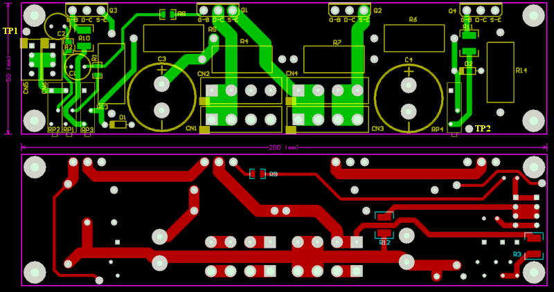

100mv with many designs is not an issue. It's also easy to achieve when dealing with more than 10 mosfets. My illustrated circuit with the 20 turn precision pots allows you to adjust many modules, say 4 for example, down to 10mv, of less. Now, paralleling these modules without output series resistors for the speaker drive should allow for a balanced load across all the 8-10 mosfets a DIYer may have purchased.
Example PCB... (Another VIA-LESS design)
When stacking this PCB vertically, you just need to feed 12aug solid core wires through CN1 & CN3, 18aug for CN5. On the top PCB, put in standard terminals for CN2 & CN4 & CN6.
RP3 & RP4 calibrates the CCS for Q3&4, TP1 & TP2 is there to measure the emitter resistor voltage.
RP1 & RP2 calibrates the output offset of mosfet Q1 & Q2.
janneman said:
Brian,
Jan Didden
That's why I built this device:
http://www.diyaudio.com/forums/showthread.php?postid=257957#post257957
janneman said:
Brian,
Jan Didden
Ok, got rid of the pots.
For the mosfet offset voltage, I'll just match the mosfets.
For the CCS side, I added an NPN transistor across (1 side example) Q3's emitter, base & V-15. Now, when the voltage across R9 is large enough, the base of Q3 will be pulled down creating a further regulated CCS.

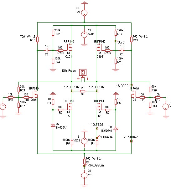

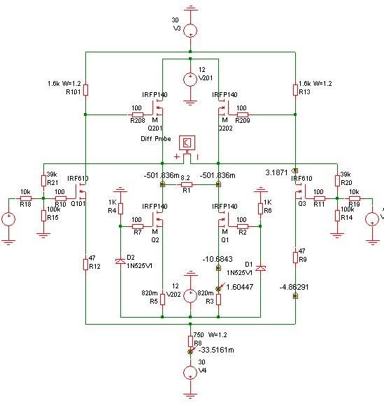

I've started a thread on BOSOZ variations with a schematic that would make a decent front end for the Follower of Zen.
Grey

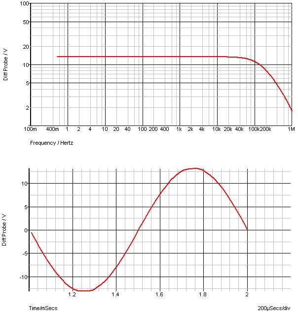

I have made a first shot in the sim. It looks pretty nice. And the title coud be The PMPXA.
GRollins said:At that point, it becomes a fairly easy task to "X" the circuit. Presto! A poor man's Pass Labs X amplifier. All in two stages and with minimal parts count.
Grey
Thanks Gray.
"Poor Man's Pass (Labs) X Amplifier" I like that phrase.
