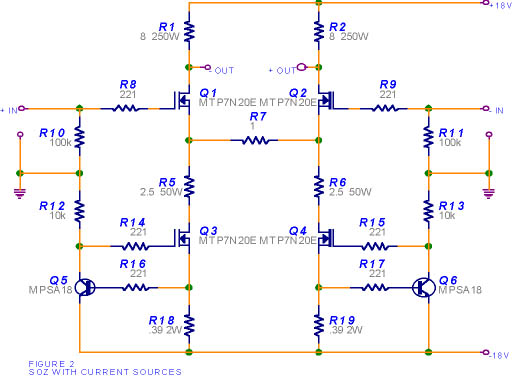

Strictly speaking, the circuits I hung under the SOZ are current <i>sinks</i>. This is one of those annoying oddities that crops up when you start speaking about current. Once upon a time, it was believed that current went from positive to negative. That was before they discovered that there were such things as electrons. Now, it's accepted that current--in the sense of a flow of electrons--flows from negative to positive, but for historical reasons people still think in terms of a positive to negative flow. As a consequence, a current <i>source</i> is a circuit that "supplies" current in the historical sense. Think of it as being "above" the circuit, usually hanging off the positive rail. A current <i>sink</i> "accepts" current in the historical sense. Think of it being "below" the circuit, usually sitting on the negative rail or ground.
Confused yet?
Don't feel bad, so's everyone else. Just think, they had a 50/50 chance of getting it right and muffed it. If it's any consolation, electronics is not the only field afflicted with such contradictions. In chemistry, the formula for ammonia, NH3 (assume that the 3 is a subscript, I can't remember the trick to make it drop), is backwards according to current conventions. The hydrogen should be listed first. But, for historical reasons, everyone still writes it the old way.
In practice, most people just call everything a current source. Annoying, but there it is.
Yes, you could run a single current source (you're welcome to read that as sink if it makes you happier). The circuit would work just fine and should have somewhat higher gain. The heat would be ferocious in one current source, so plan accordingly if you want to build one.

You can use the SOZ with an unbalanced input, albeit with less gain and higher distortion. That, in turn, can be taken care of by...current sources. The more resistance under the tail of a differential, the better it functions as a phase splitter, and a current source has (at least in theory) infinite resistance.

I am about to make a PCB for a 'BOSOZ with current sources', I have used the variety of CCS as described by Grey in this thread (only adapted to the lower quiscent current, thanks Grey). My question is where can I find out more about different current sources and how to design them. Grey you alluded to the fact that there are many different types and the one shown on the SOZ is just a garden variety, also mentioned that I might like to try them all before I decide which one is best for me, bit like beer really. I seem to remember seeing a page at Elliot Sounds web site regarding current sources/sinks, I will chase this up in the meantime.

Dan,
I picked up what I know piecemeal as I went along. There are different ways to go at a current source. The basic way is to provide a fixed DC input to the grid/gate/base. This is sufficient to tell the device that you want some arbitrary current output, depending on what you put in. The next step is to include some error correction via a sensing resistor. The current source I used for this project is an example of this class. Things can get more complicated--you can use an opamp (or just a differential if you like) to sense a steady voltage on one side and the error on the other side. It's just a question of how far you want to push it. Like everything else, there's a limit as to how complicated you want to make the current source, at least for audio use. Commercial current sources are available that have more stuff in them than my entire system.

Hi Grey
Harrumph! (what ever that means?) - here it is, I hope.
Henrik,
Thanks, that'll make things a bit less confusing. Someone coming across the thread for the first time would probably do quite a bit of head scratching, trying to figure out what it was all about. You've saved the day, as I no longer have the file (the virus that ate my PC a while back gobbled it up).
