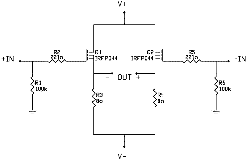

Okay, let's try this again...
Just something to kinda stimulate discussion.
It's for those who were upset over the high parts count in the Son of Zen. (Ahem...)
As a fringe benefit, the damping factor is higher and the heat dissipation lower. Distortion will also be somewhat lower, in that followers have 100% local degenerative feedback.
The caveat is that, being a follower, it will require a fair amount of gain from stages upstream, whether they be preamps, active crossovers, or whatever. Like the original SOZ, it will be happiest with a balanced input.
Naturally, you can replace the 8 ohm resistors under the MOSFETs with current sources, which will make things even more efficient, but that's another post for another day.

Your schematic, with a preamp (say a bosoz), looks to me like a complete amp, but with separated front end and output stage
maybe we could design something "integrated" using this follower and a high gain "preamp"

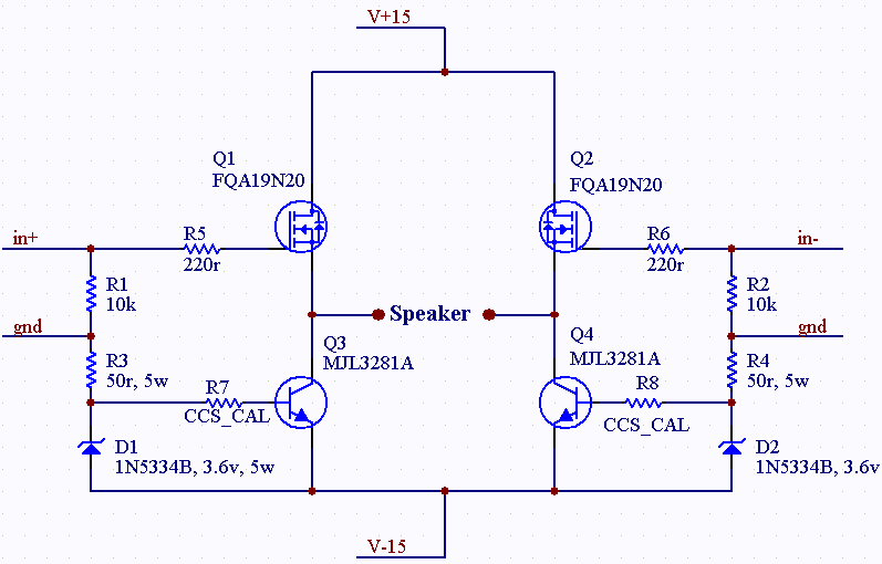

Here is a simple CCS implementation...

maybe I missed something here ... I think there REALLY needs to be some resistors in the emitter legs or this circuit will very quickly go beyond class A, even if those Motorolas are genuine 🙂
Maybe you meant to put R7 and R8 in different places?
mlloyd1
(who doesn't want to see any innocent MJL3281A killed nor anybody injured from fragments of said deveice when it explodes! :whazzat: )
mlloyd1

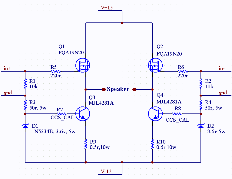

Ok, emitter resistors added.
R7 & R8 in different places? How do you mean?

With a BOSOZ or something of that nature wrapped around the outside you'd have a complete, functioning amplifier, as Bricolo noted. The trick is to get enough clean voltage from the front end to do the entire swing for the output. Easy enough for a 50W amp...not too difficult for 100W...it gets challenging if the goal is 600W.
At that point, it becomes a fairly easy task to "X" the circuit. Presto! A poor man's Pass Labs X amplifier. All in two stages and with minimal parts count. Being two stages, it probably doesn't count as a true Zen amplifier any more, but speakers don't care.
Yes, you'll still need a fairly hefty power supply, but at least the circuit won't be burning power through the upper 8 ohm load resistors, and with current sources on the bottom the waste there will be minimized.
More power--or less heat dissipation per output device--is easy. Just parallel the output devices. Add a smallish resistance at the Source of each output. Match the devices; they'll all need to be matched, unfortunately. Like the SOZ, the amp is easily scalable to whatever rail voltage you have on hand or, conversely, to whatever power output you might want.
Just add large heatsinks and stir.
