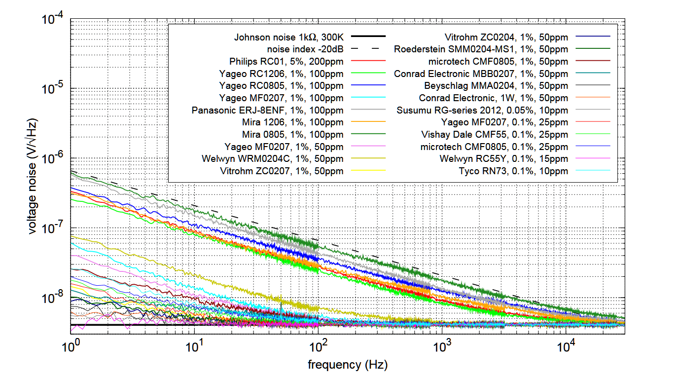

I don't think a "standard" DIY'er has the equipment or skills to do resistor noise measurement properly?
https://dcc.ligo.org/public/0002/T0900200/001/current_noise.pdf
I guess the resistor is the most linear component we have. Compared to e.g. a transistor.......
I think for myself to reduce noise the time spent is best done on layout of amplifier in chassis, how wires are routed, power supple etc......
But interesting scientifically topic for those who will and have the skills to measure and compare noise generated by various brands of high quality industrial resistors (if one brand comes out on top I could be tempted to use those).
A resistor can also pickup noise just by its size if someone is tempted to use some very special purpose resistors for audio 🙂
The same with capacitors. Very large film-caps can pickup noise even that it have better specs compared to a smaller ones.
Compact SMD circuits are not that bad i think.......regarding noise....

The 1206 size SMD is still a relative “sweet spot” in terms of price and availability for precision resistors. And is a good choice for thermal release as any smaller is a compromise.

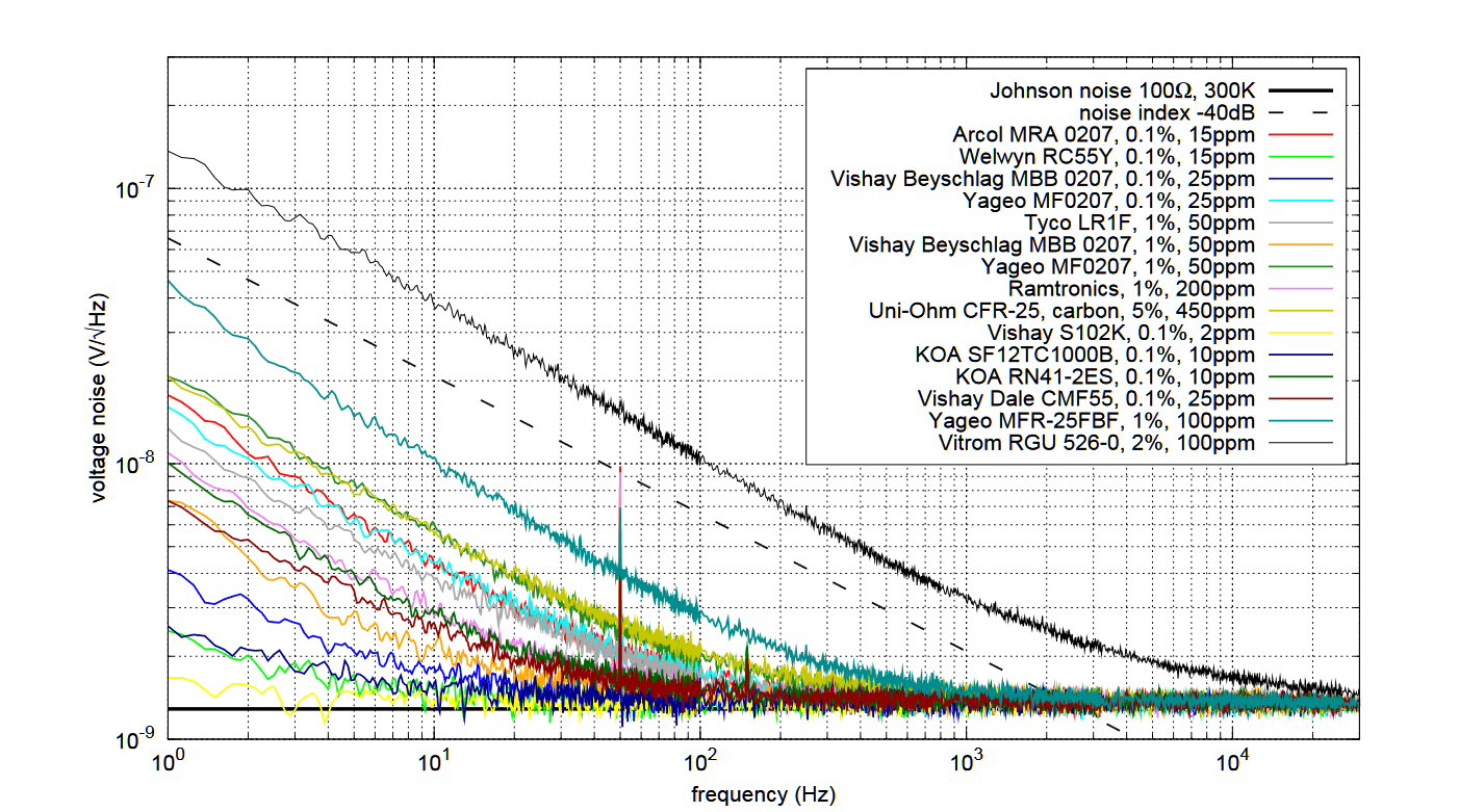

Definitely will.Perhaps worth it to read the whole paper. I haven't yet, but this one shows that not all are created equal, at higher frequencies.
I think it is safe to conclude that:
a. not all resistors are created equally
b. some measure higher noise in the audible range than others
c. although 3rd harmonics seem to dominate, the levels are not the same
So, perhaps my 24 resistor test setup was not so daft after all 😎

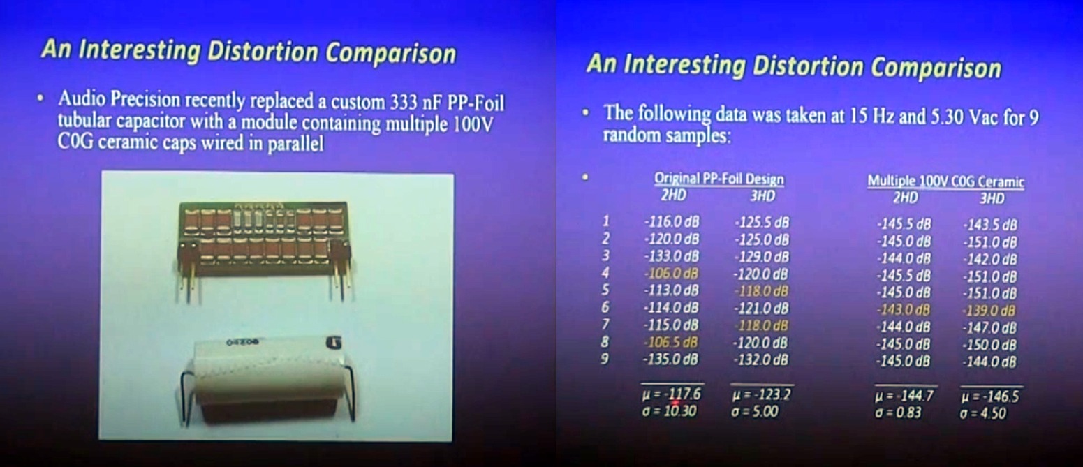

Yes, but I doubt it will make a difference on a final amp when we make the usual distortion / noise measurement using ARTA/REW etc. assuming normal high quality resistors were used?
