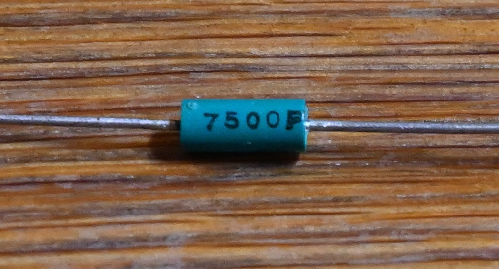

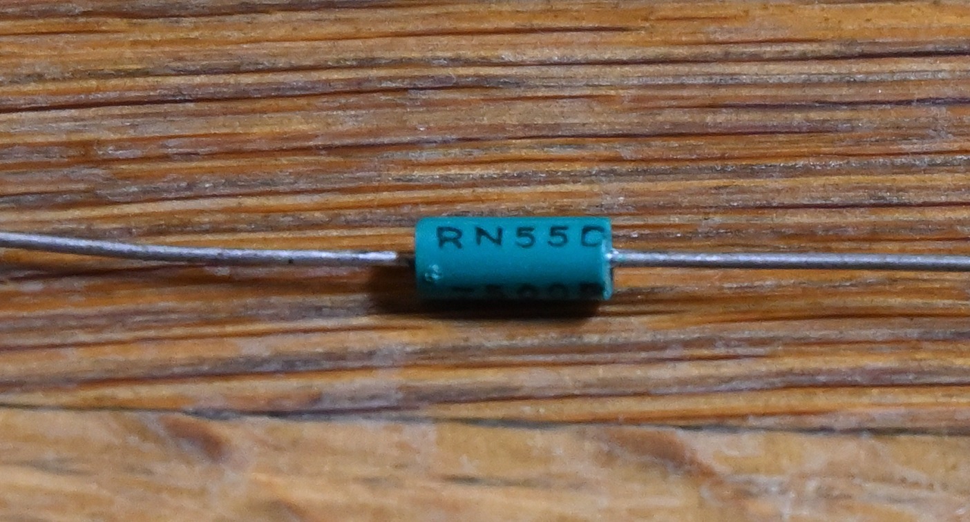

Maybe someone can tell me which brand these resistors are. RN55 "sounds" like a Dale type but does not look like it.
The history of them are that my father was a "collector type" so a room in my parents house was filled with "tons" of old electronic components / equipment. Room needed to be cleaned up so I have trashed many of these. Many plastic bags of components / equipment. I never tought I would go into the "DIY hobby". I found a couple of these that had survived. I guess they maybe are 50 years old or more.......

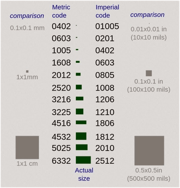

A "standard DIY size" could be agreed on for the "small signal" circuits so we all could get a cabinet with full E96 series with 1000 of each value in 1%.
The 01005 series would not take up much space. Then my stereo microscope would see more use........and the small Weller tips I have.......

Regarding DIY assembly with surface mount resistors (& capacitors):
The resistors will be 1% metal film, unless you want try really hard to source something else.
The capacitors would be ceramic dielectric of type C0G or X7R depending on value. There is some debate about the piezoelectric effect of the dielectric and its audibility. I would feel safe with small values, <1000 pF, in C0G, and values up to 0.1 uF in X7R.
From my days of assembling prototype circuits to test out my design ideas, Imperial size 1206 is fairly straightforward to solder without special tools other than a smaller tip on the soldering iron. Having a circuit board clamp will make things much easier to hold parts in place. Fine point tweezers will also help. Going below 1206, I used to solder 0805, 0603 and even 0402 with the aid of a binocular microscope and special soldering iron. Those tools are not cheap. Fortunately my previous company was footing the bill.
Overall, I would recommend 1206 as a standard size. It works well in compact highly populated layouts. Imperial 1210 or above would only be needed if higher power dissipation were necessary. Something to bear in mind is that the values are printed in a three or four digit code, which one needs to look up in a database (or the manufacturer's data sheet). The SMD codes are nothing like the digit codes that we are already familiar with on Vishay/Dale axial leaded parts. You will need a magnifier of some sort to read the code. Best to keep the different values carefully segregated.

ZM soldering 0805 in pads of 1206, only when Vendor send those (availability, error) and dissipation/voltage isn't critical
active smd critters - well, if I put it on pcb, I'm going to solder it
now, I'm not going further than first optimizing parts (wattage, voltage), then optimizing pcb for circuit (again - thermal arrangement being very important - how far OS devices are, how far caps are from heat sources), overall pcb dimension is always result of thinking how to wire and in context of overall construction and preferred/necessary case dimension
now, I'm not in mobile phone construction business .......... so no need to think of that level of miniaturization
