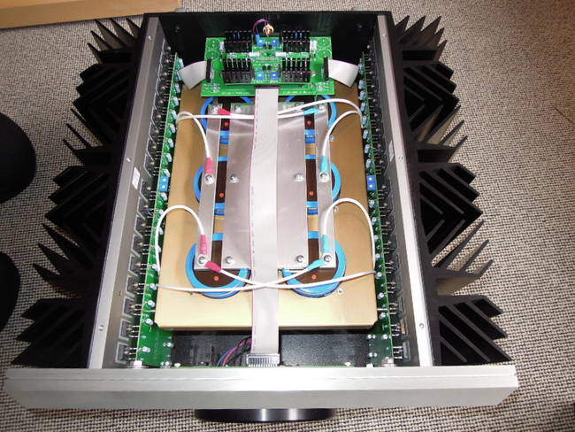

then there is most intriguing puzzle piece - modulated cascodes
whatever - exactly that puzzle piece is most interesting for me , rest is exercise in Demonstration of Force
10-15W is upper bracket for my needs , so no L'Art pour L'Art ....... at least not this time :clown:
First I thought that these cascodes refer to Prof. Hawksford’s article: “Reduction of Transistor Slope Impedance Dependent Distortion in Large-Signal Amplifiers”, but I was informed that this is not true.
We have to continue with guessing.....

Mr. P has revealed this previously. Check out Zen Variations 9 - Fig.4. I recall that there was more discussion in some threads here on DIYA at the time.
Enjoy.
GL
....but implementation must be well thought for particular cases
I agree.
But I think that the basic circuit principle/mechanism is the same even though the method of implementation might be different. If this is so, then the ZV9 article should put an 'implementer' pretty far down the road.
I do recall that NP posted a while back that he had 2 or 3 ways of implementing cascode modulation.
GL
Nelson,
Is the purpose of the modulation to ensure that the cascode device dos not kill the nature of the device it protects? It is after all, the nature of your new parts you are trying to preserve, achieving higher power levels at the same time.
