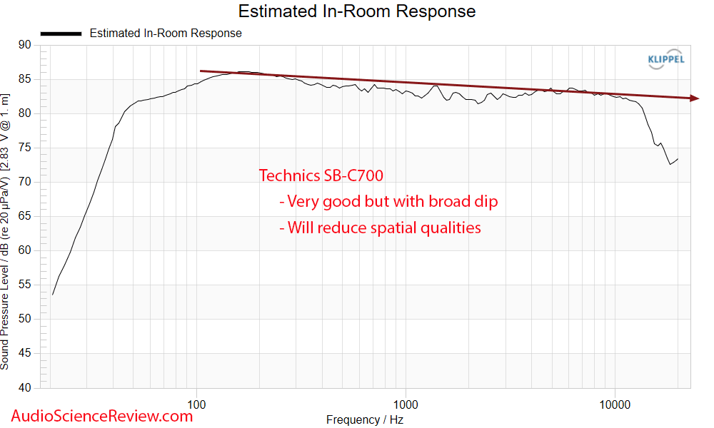

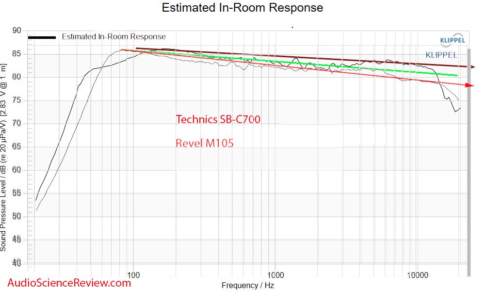

I was going to suggest seeing his review of the Technics SB-C700 speaker. The original post had unfavorable comparisons to a Revel (surprise) M105. Screen shots from the ASR review which judges the Technics to have a broad midrange dip show how that was determined. Note the disparity between where ASR's estimated in room response intersects the high frequency max between the two models. Drop the high end of the Technics line ~2 dB as he did for the Revel and the relative 'broad dip' evaporates. TLDR version: owning even SOTA measuring systems don't confer objectivity.
More disconcerting the Revel comparison along with its 'wow wow wow' assessment of the Revel's audible superiority have since been stealth edited from the main review. Some of the discussion survives in the comments.

... and the SB-C700 elevated high frequency spectra above 3kHz are pirceing the ears much more than the smooth Revel M105. Actually, it depends where the ear-brain will catch up - it is either midrange drop, or elevated highs... which neither is good.
