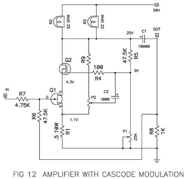

Nelson,
Figure 7 - Q1 VD should be 4.3 V and not .43 V according to your text. What is the minimum practical limit for the cascode voltage of the JFET?

Nelson Pass said:
As to the positive feedback, the modulation is similar to "muting"
the cascode. Some small variation is allowed through, but it
works to slightly decrease the voltage across the JFET on the
negative output swing and increase it on the positive, running
counter to the natural tendency of the transconductance to
increase at higher current and decrease at lower. This gives
some cancellation of the two forms of nonlinearity, which is what
I was referring to when I mentioned working the triode load-line.
Yes, this makes sense.
Kind of parametric linearisation?

OK here we go.....

Blues said:
Both didn't make it in the sound department? As apparently both didn't make the cut in the final doc...or both presented more "opportunities"?
They present more opportunities, but I decided that they might
be too much of a good thing for people without scopes and
distortion analyzers.
On the other hand, Figure 13 is probably pretty safe with a P2
value of 100 ohms or so.
the amps (figure 12 and 13) can also be made with just two mosfets as well: except that you will have to bias the bottom one slightly different. Rather than picking up the feedback from the speaker terminal, I feed the signal from the D of Q2 and feed it back to G of Q1. Worked quite well and saved one power jfet.
