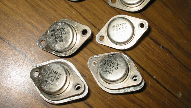

There's lots of JFETs around for diy, if you can live with a 5A or so Id limit (or parallel them). SONY VFET amps from the 70's and 80'is have lots of them, and you find them often on eBay, like 4555's I think is the model number. TA-7's have 6 pairs each, although you would probably want that one in operating condition (I do!).

Sony VFETs
2SJ18 and 2SK60.
Don't ask, they're blown.

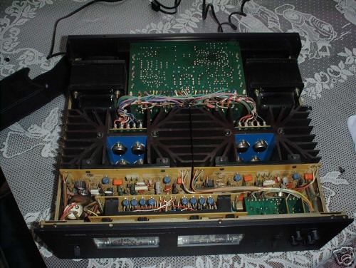

Just for the record, picked from eBay. Yamaha B2, similar to B1?
"Yamaha B-2 V-fet audiophile quality stereo amplifier is finally up for grabs. Those of you who know how difficult it is to find this baby, well you wait is over. These were part of the Yamaha "Natural Sound" series and it certainly lives up to its name. It's sound is so sweetly produced by 2sj26 and 2sk76 vertical field effect (V-fets) transistors that have a warm tubelike sound. That, plus the fact that they are virtually non destructible (not subject to thermal runaway like bipolars) and have auto-biasing circuitry. Their odd order harmonics are similiar to triods and distortion is very low, .008 at 60 watts or below and rising just slightly above that at rated power of 100/watts channel. The heat sinks are so large and solid(study the pictures well) and cool the complimentary type v-fets so very well. Yamaha saw to it as well to give this amplifier so many features that were even today cutting edge! For instance, v.u. meters that have the capability to monitor either internally or externally, two inputs, two sets of speakers switches, every kind of protection circuitry and independent power transformers for each channel. The sound is so warm and accurate. It's easy to tell this amplifier is special. It is very heavy (58)lbs"

There is no reason not to parallel smaller JFETs. Gate capacitance will rise as the number of units increases, but that's no different from running a single monolithic unit with relatively high capacitance.
The Yamaha B-2 was/is a nice piece of audio gear. A buddy of mine used to own one. Whether he still has it, I do not know, as we've lost touch with one another. I believe it had a malfunctioning meter, but was otherwise playable. Other than the fact that you can't reliably source parts for service, they're certainly nifty if you can get one for a reasonable price. JFET output amps are rare.
