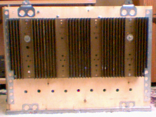

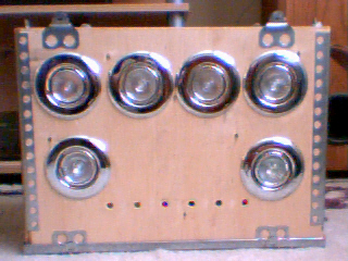

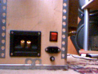

I started working on it. In fact, I have managed to build an "F2-Lite" (if I can call it that way). I was not entirely satisfied, took out a PCB , and will modify it as ZEN V8, but with a mosfet. At least until I get a pair of Jfets...
I am attaching some (poor quality) pictures, just to let people see what it looks like. When completed, I will borrow a decent camera and I hope I will show it in a full light😀

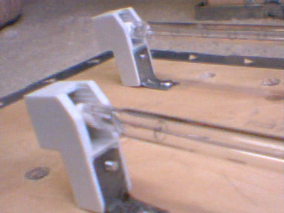

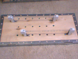

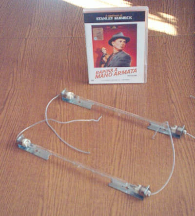

Concerning the lightbulbs, at first I tried the solution with 6 ceiling halogen lamps (front side). There were 3 (20w, 12v) lamps connected in series, per channel. However, the voltage accross one lamp was around 9v, meaning they were quite bright, and hot. Only then I realized that these lamps release most of the heat on the backside. So the inside of the enclosure was getting too hot. I disconnected them, and I bought two halogen sticks (1500w, 220w) and, since they are mounted outside, on the top , there was no heating problem....
Anyway, have a look....

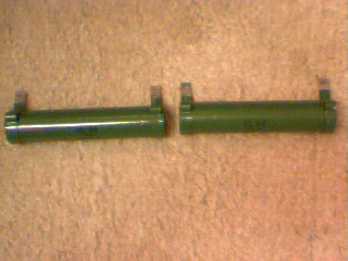

Vix said:Hi,

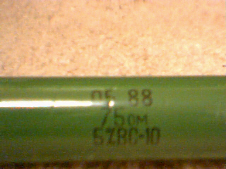

Stefano, you mean 75 Ohm resistors, like these? 🙂
Yes , guess that 10 watt is ok
