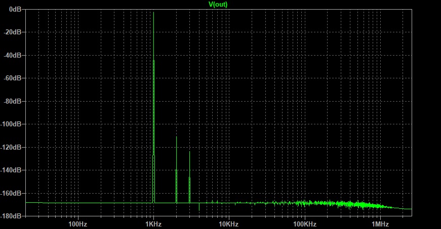

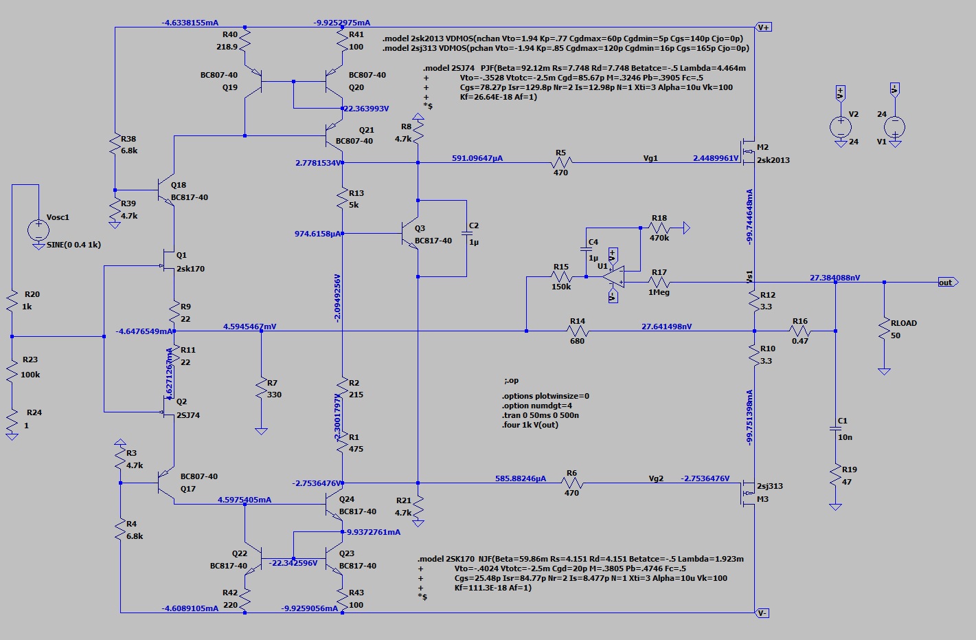

@piotrl,use the toshiba 2SK2013 and 2SJ313.Circuit will have to be updated to deliver lower bias voltage, but that's it.Which resistors are to changes, the R15 and R16?To what value.
thanks Michael.
I did not experiment on the live circuit yet, but in order to use Toshibas, you need to bias them with about 2V less than Fairchilds. I did simulate this on the LTSpice and the only thing to change is the R15/R45 resistor to about 5k. See R13 on the attached schematic. That schematic is not exactly precise, it lacks few caps and uses different BJTs, but it is good enough for the purpose of this exercise.

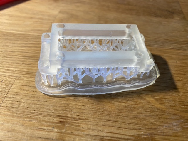

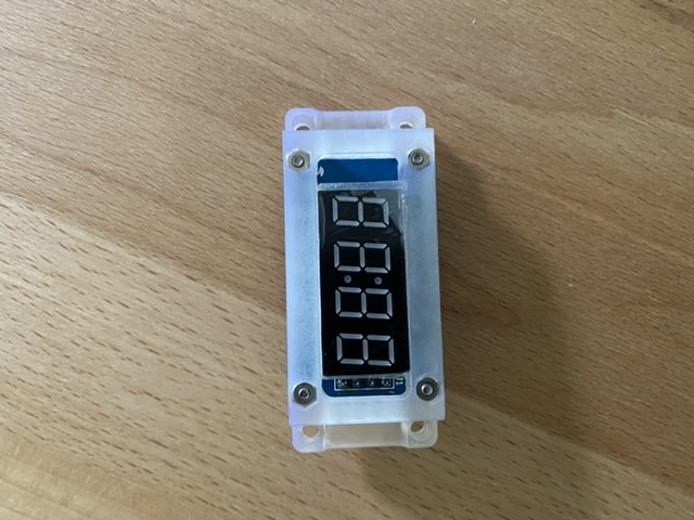

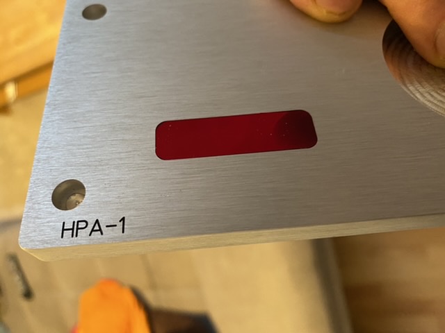

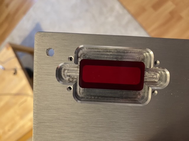

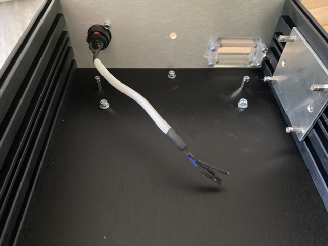

Here some actual pictures from display integration…
