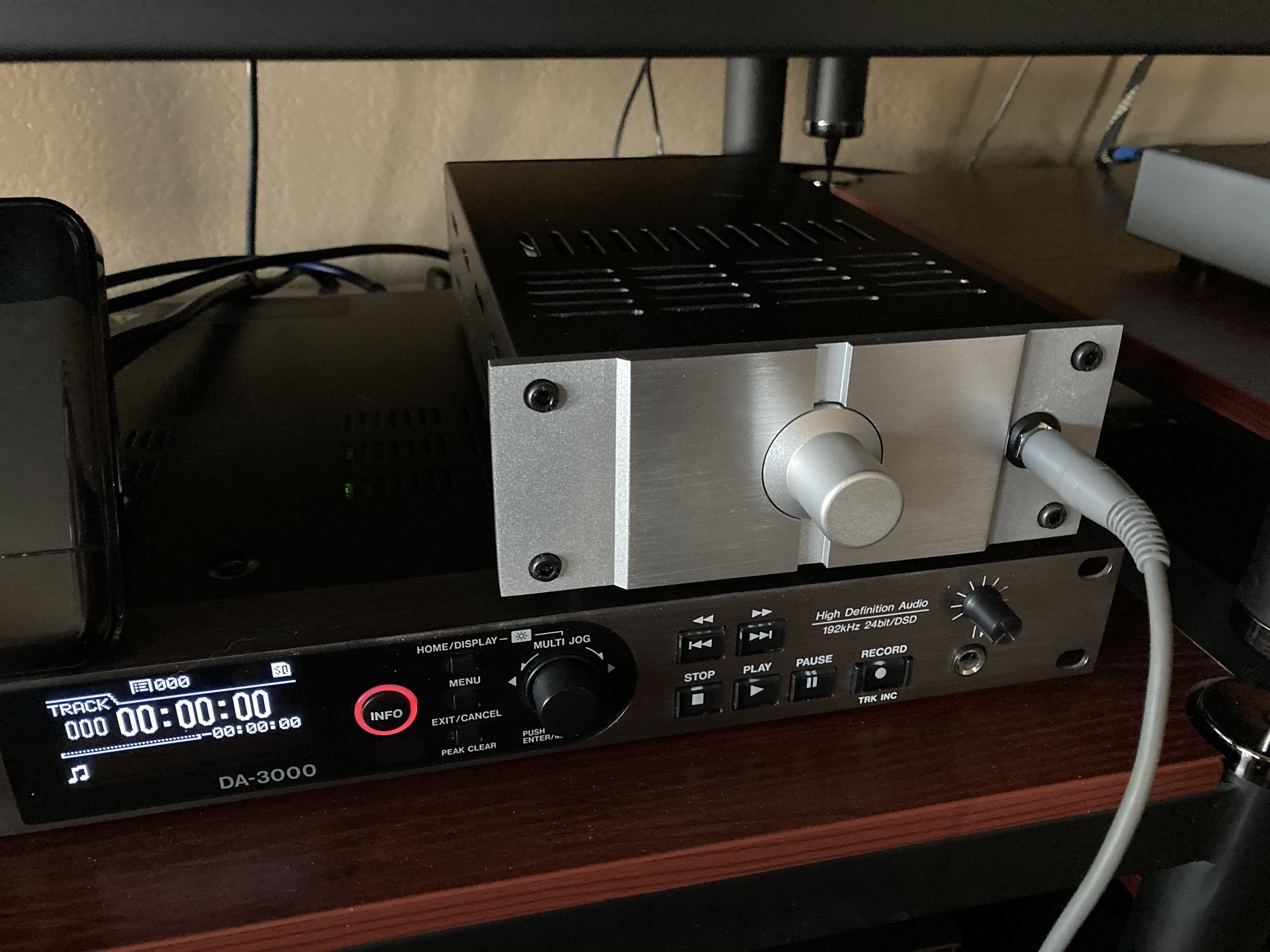

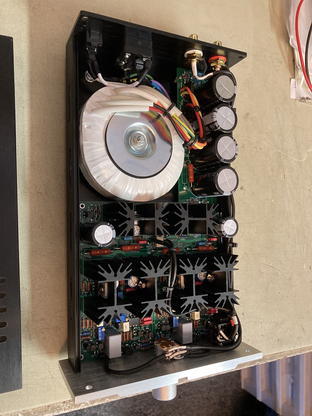

I completed my smaller version. It is pretty crowded but I managed to fit it all into a chassis with inside dimensions of 135 x 250 x 48mm (W x L x H). I had to use a few SMT devices on the relay turn on delay circuit, but the rest of the circuit is through hole. The height limitation meant I had to reduce the filter caps from 4 x 10,000uF to 4 x 6800uF. The transformer is a 50VA medical version with extra shielding. There is no noise or hum at all.
With the heat sinks I could fit in the case, the temperature on the sinks is about 60C with the 100mA bias. But I found that I could safely reduce the bias current since my headphones are AKG K701s. They are 63 Ohm and max out at 200mW. That means I only need 80mA peak to drive them to the limits. So I could get by with as little as 40mA bias and still be class A. Of course reducing the bias that low started to affect the distortion. But I found a sweet spot with the bias at 60 mA. This actually resulted in lower distortion at the levels I was interested in than the full 100mA bias. This keeps the heat sinks at about 50C. I cut ventilation slots in the cover and things stay pretty cool. I intentionally did not add ventilation slots near the front end components and there doesn't seem to be any sensitivity to breezes on the bias or offset.
Overall I am very happy with the performance. The BW is about 1250 kHz (-3dB). Noise is below what I can measure or hear. The 10kHz square wave looks great.

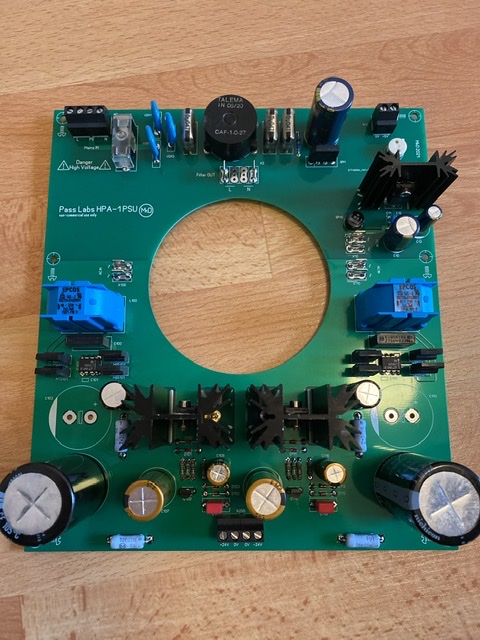

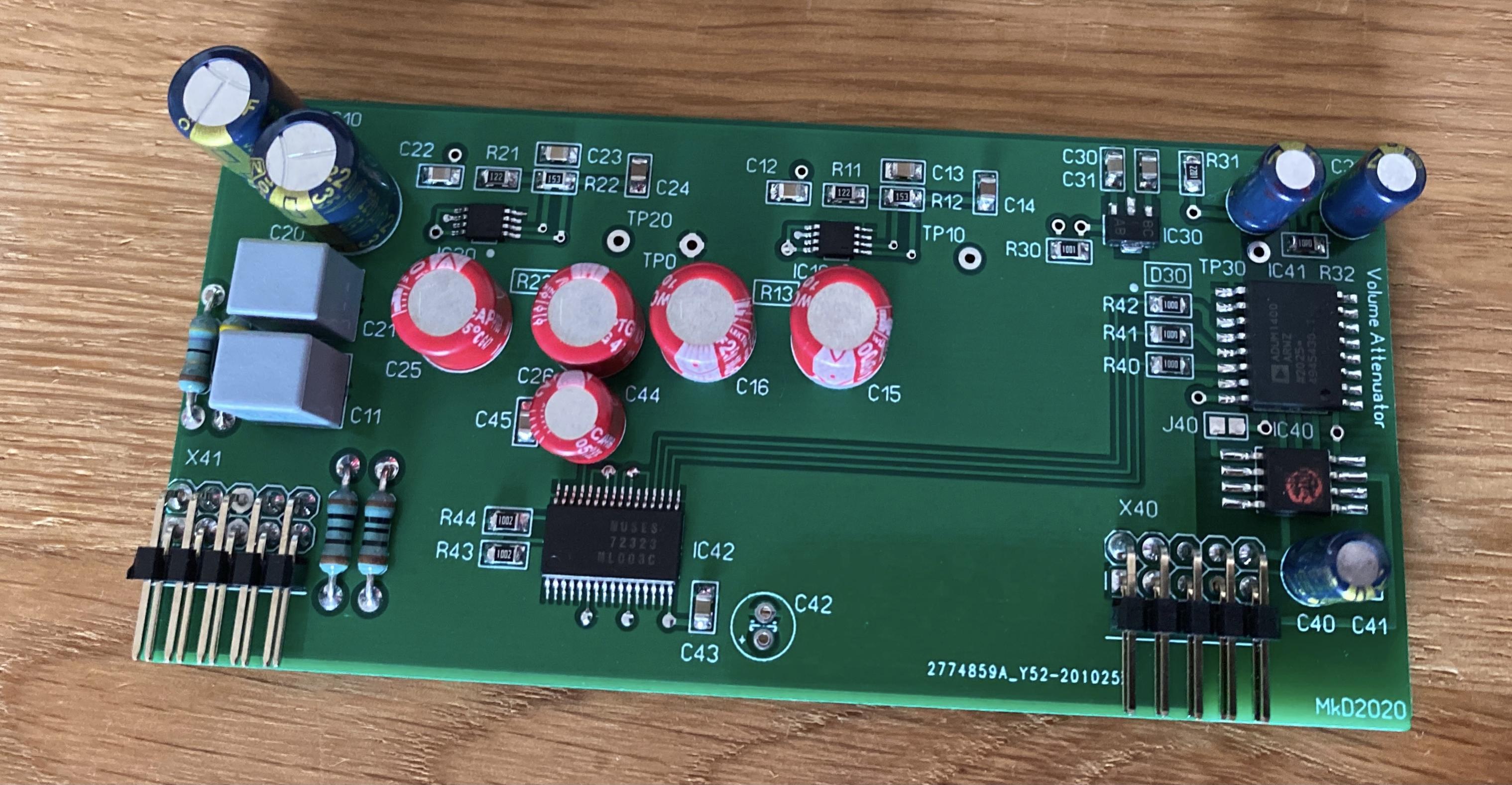

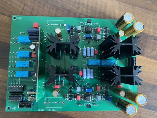

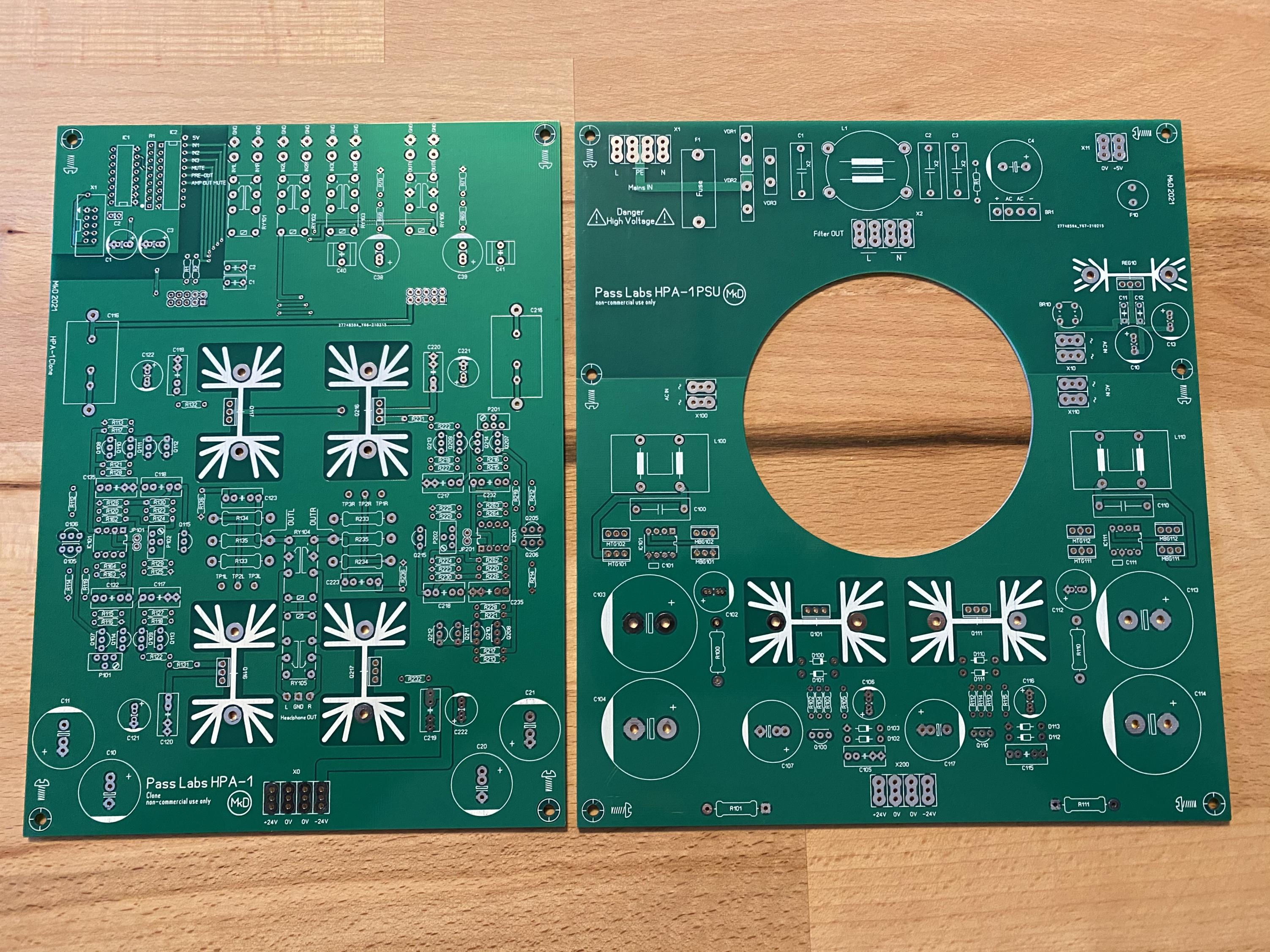

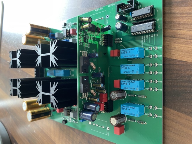

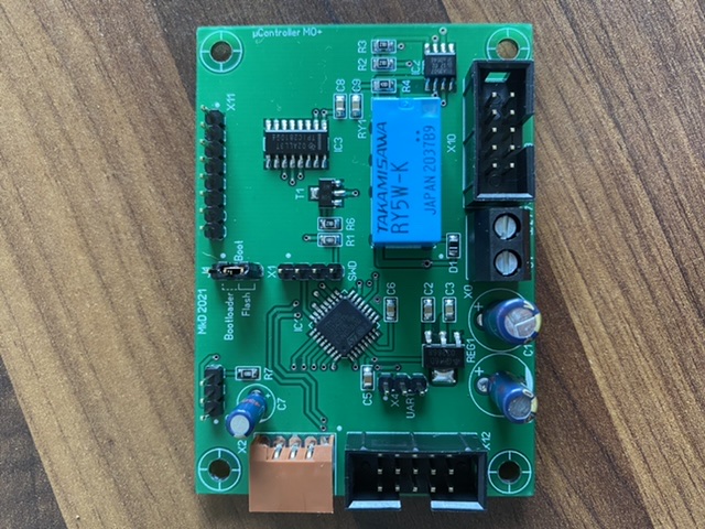

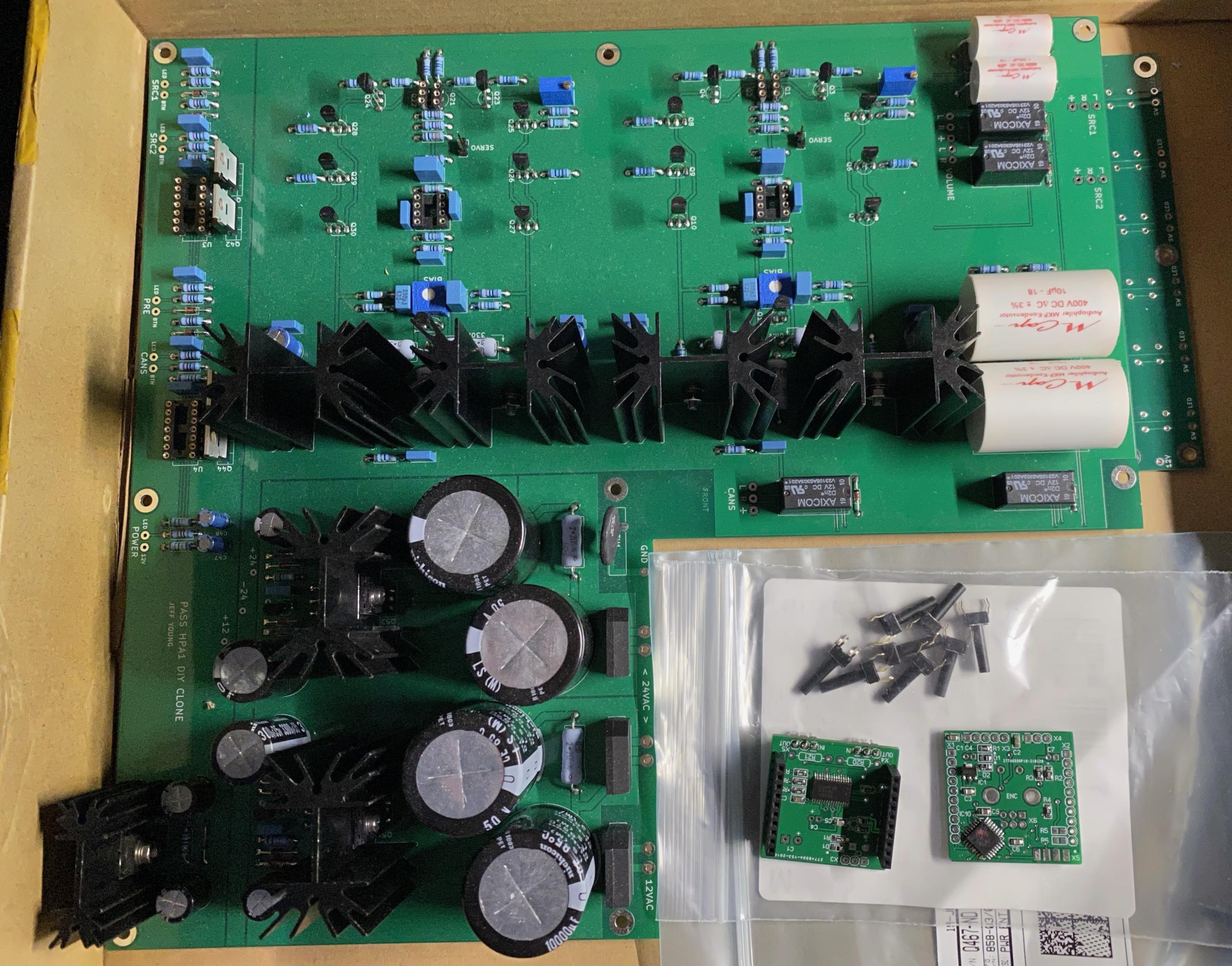

I go another way with a two board version.
PSU with HF/DC filter and active rectifier.
Amp with Muses Volume, up to three input channels and microcontroller control unit.

I see how impossible the requirements for high and low impedance phones impose on a ‘universal’ headphone amp must be. The HPA-1 does an incredible job. Narrowing the target to 60 Ohm phones at less than 3vrms made it possible for me to fit into a smaller enclosure, but even then I had to compromise a little on the power sections. I also simplified the input selection circuitry since I only wanted a headphone amp, not a preamp. So I only used a 20 second turn on delay circuit, without the additional input selection circuitry.
The sound exceeds my expectations. I can’t imagine a better sounding amp for my K701s. The circuit is very stable. It would be perfectly acceptable without the DC servo, but the servo works so well that there was no reason to leave it out.
The gain is a little low for my system. I have a Pass Labs X2.5 pre driving an X350.5 amp. I use the balanced output of the pre to drive the amp and the unbalanced output to drive the headphone amp. I have to crank the preamp volume much higher for the headphones than for the amp. No problem, but it would be cool if they were better matched. If I ever turned on the amp at the level I use for listening through the headphones it would blow the windows out of my house. But increasing the gain would likely ruin the sound character of it is not an option.
I’m already considering a larger version so that I wouldn’t have to compromise at all on the power supply or bias.
