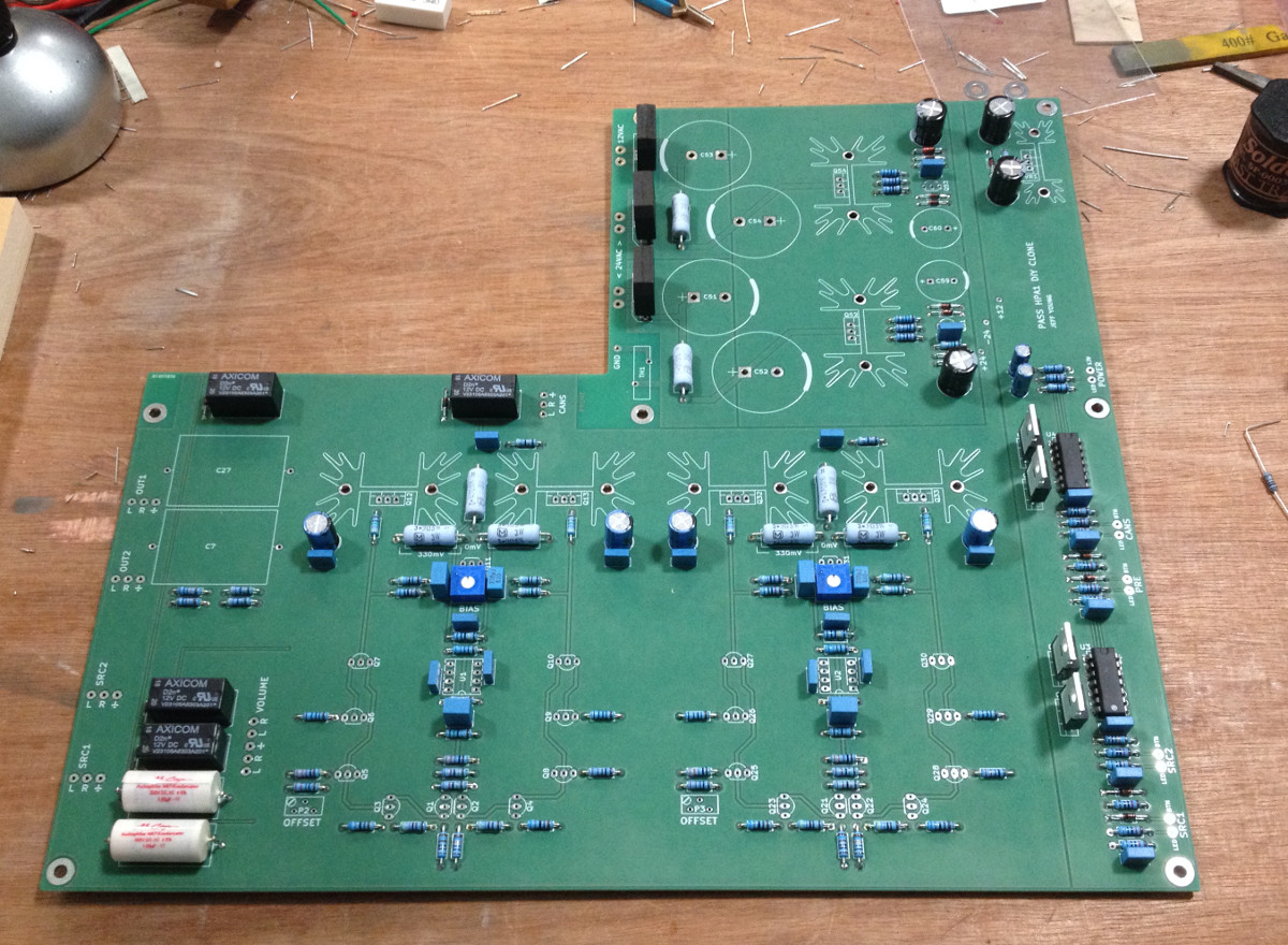

I'm still machining the case, but it's far enough along that I started stuffing the board:

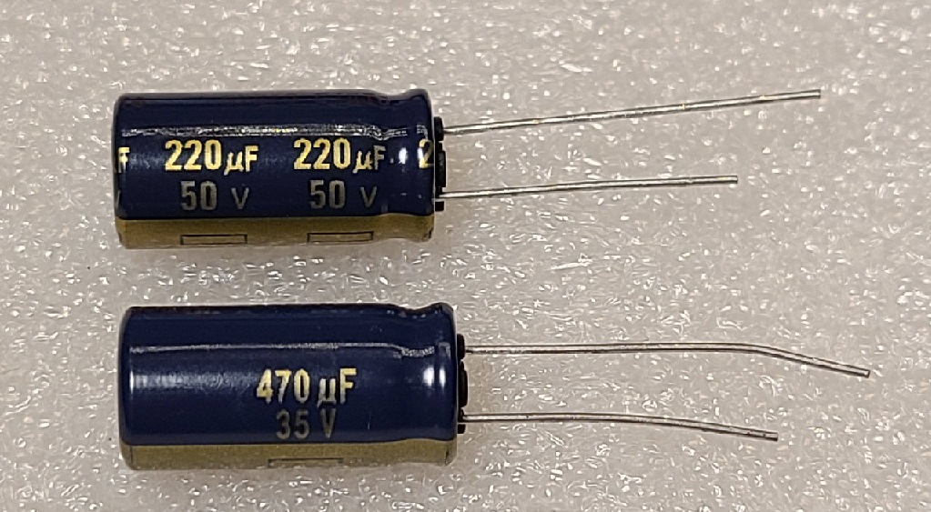

@Jeff, in post #57 I can't quite tell but did you deliberately find a 470uF with the same case dimensions as the 220uF to make C61 and C62 look symmetric or is it actually an error on the schematic and C61 is actually supposed to be 220uF as well? Any harm if I make both of them 220uF or make both of them 470?
While I have your attention, does the value for R91 (0R82) matter if I substitute with something close like 1R0?
He he... yes, I have OCD. C61 is a 25V cap and C62 is a 50V cap so that they're the same size.
R91 is there to modify the ESR of C62 (or maybe the time constant?). It's from some app note or paper that I read, but I can't seem to find it now....
In any case, I think the LM7812 is actually pretty stable and none of the values matter much.

How would you test a fully populated board without the button board? Is it just a momentary connection from the button pad to +12V. The appropriate button pad of course 🙂
Speaking hypothetically of course 😉
