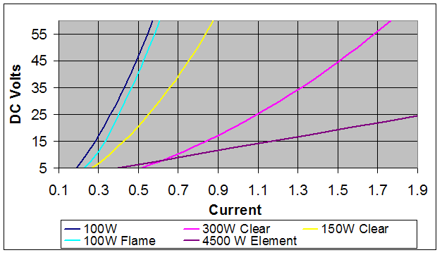

I had some 300w bulbs for a never built enlightened Zen, and cold they seem to measure about 4 ohms,.. I remember the bulbs at the show being big, but marked 150w So maybe Nelson can "enlighten" us. I realize that the bulb's resistance changes a little when it gets hot, but it isn't going up that much...I don't think..

Well, I've posted this before but it may be of interest now 😉
How far off of the 300W are two parallel 150W? Does not look like much.
Question - How about the low frequency distortion from the filament time constant?
I did not try any "dynamic" testing but I think your right
It would be interesting to see at least some pulse testing types of response. Maybe I'll get off my butt this weekend and try something
Hey as long as I have your attention, what do you think I should try? I haven't really thought about it much. Hmmm
Start with an amp or so (Idle current) and hit it with a step up to 2A? A step down to 0A. See what the rise time/fall time looks like? We could calculate Thermal Capacitance or whatever

A 300W bulb should be 48 ohms when hot, assuming 120V RMS line.
Well, we aren't running the bulbs at full output, or close to full output, so they won't be as hot as Scott's Grannies basement and I guess not the 48 ohms that 120v might give.
So Nelson's amp has two 150 w bulbs I believe - one for each channel. right? (its a stereo amp) And he calls the bulb out as 20 ohms.
So I guess my 300w bulbs have less resistance, so it looks like I'll have two 300's per channel in series. Appears that more wattage is more linear. I'll then have a "300W SED" amp which has specs like a "300B SET" amp. Hope they still glow enough though..

I seem to recall from previous efforts getting about 20 ohms
from my bulbs when run at 30V or so.
As my experimenting showed also 😉 For the 300W: 25V/1.1A = 22.7 ohms
There definatly seems to be some non-linear functions at work with the heating etc.
I'm going to try to experiment with some bulbs and the heating elements and their response to rapid changes to applied voltage/current this weekend if possible. I don't have any ability to do THD at the moment but some curves/scope pics in the audio bandwidth rather than several seconds might uncover something interesting 😕
