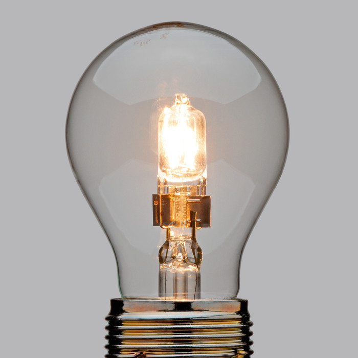

There are still alternatives, for example this 105W halogen light bulb. Take a look here:
Halogenglühlampe klar
I think, they are beautiful! 🙂 Manufactum says, that their phase out date is september 2016. 🙂
