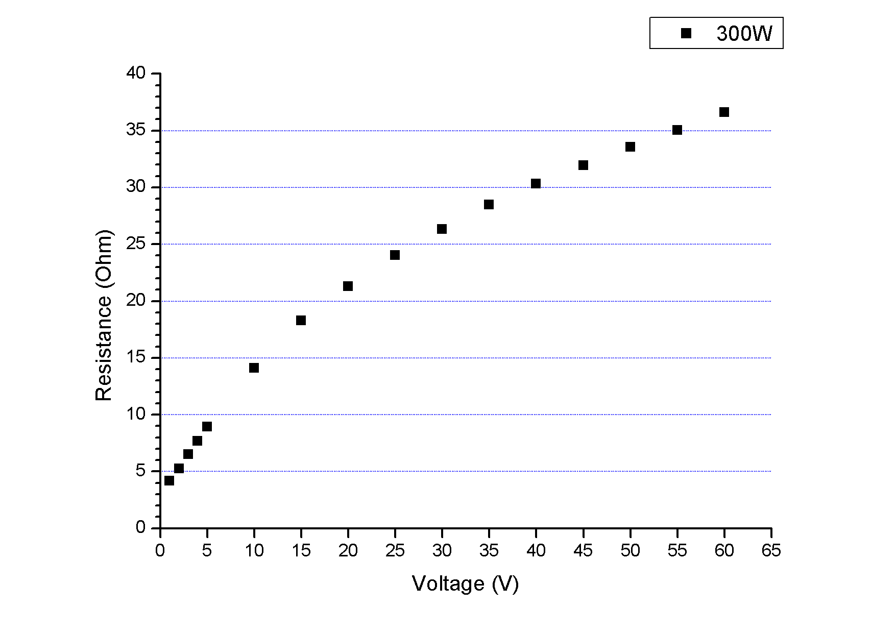

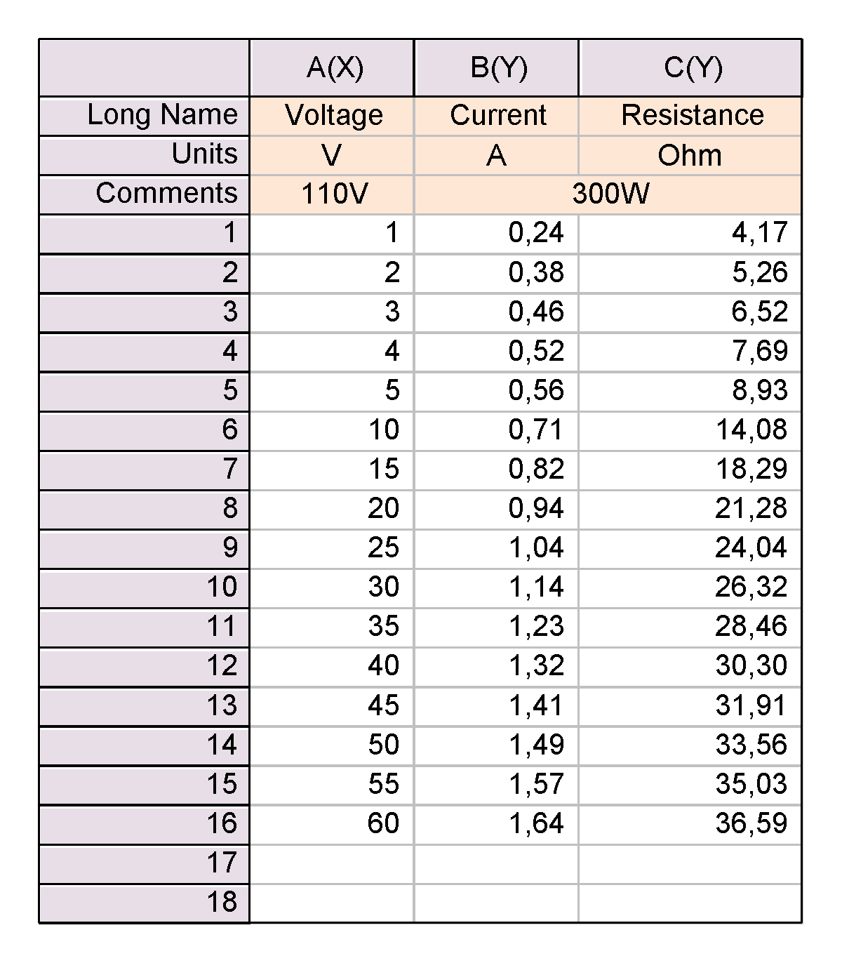

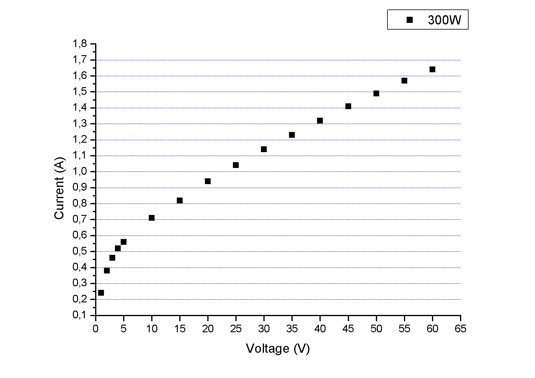

Yap, they do ring. I noticed that with my Zen-lite amp. I think it's the AC-current through the filament changing it's temperature/length. I first thought I was tripping but it kind of makes sense...
Concerning bulbs and their resistance...maybe it's time to reread the Zenlite article.
http://www.passdiy.com/pdf/zenlite.pdf
(btw, I sourced my bulbs when I was on holidays in Mexico, 300W 115V, plus sockets. Luckily still have four in spare...)
