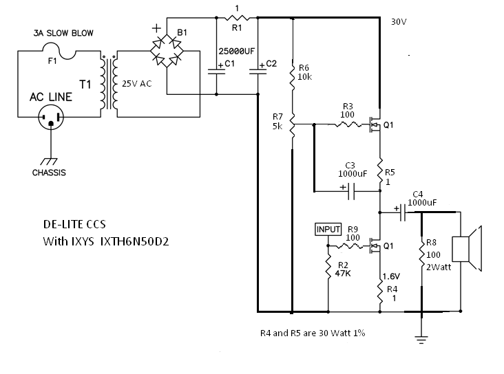

Pass "DeLite" Amp from BAF
Yes, I have used 1k ohms in parallel with the speakerto keep the output at ground.
Thank you for the other values Papa. I have been simulating with a 10k pot sandwiched between 1.5k resistors. Will try with the new values.
Works perfectly . Just splitted back the PS into dual 30 V , with 2 bridges .
Lots of capacitance and completely quiet 😉
