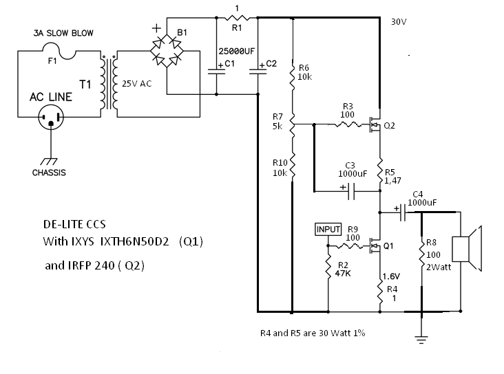

My experience is that you can use an IRFP240 as the upper
transistor and save lots of money. To the extent that you
want a pure current source and can spare a volt, you can
raise the value of its Source resistor also.
And it works 😀. Thanks a lot . So I set R5 1,47 for now , if it is correct probably we can also rise the rail Voltage to 40 volts or so 🙂

How about lifting the source resistor from ground to -V (-20V)?
Is it possible to set the drain voltage to zero using the same arrangement?
That would get rid of one more component -- the dreaded output capacitor!

Well the post 605 shows the amp with the upper part with an enhancement mode device , which is the IRFP240 or the IRFP 044 of course - . The lower part is self biased by the depletion mode Mosfet and the Power Resistor . So looking at it , we see that there isn't the typical feedback or loop resistor to set the bias .
Though , the music is quite a bit ...let's say different (?) 😉 regarding the version when both gain devices are enhancement mode .
